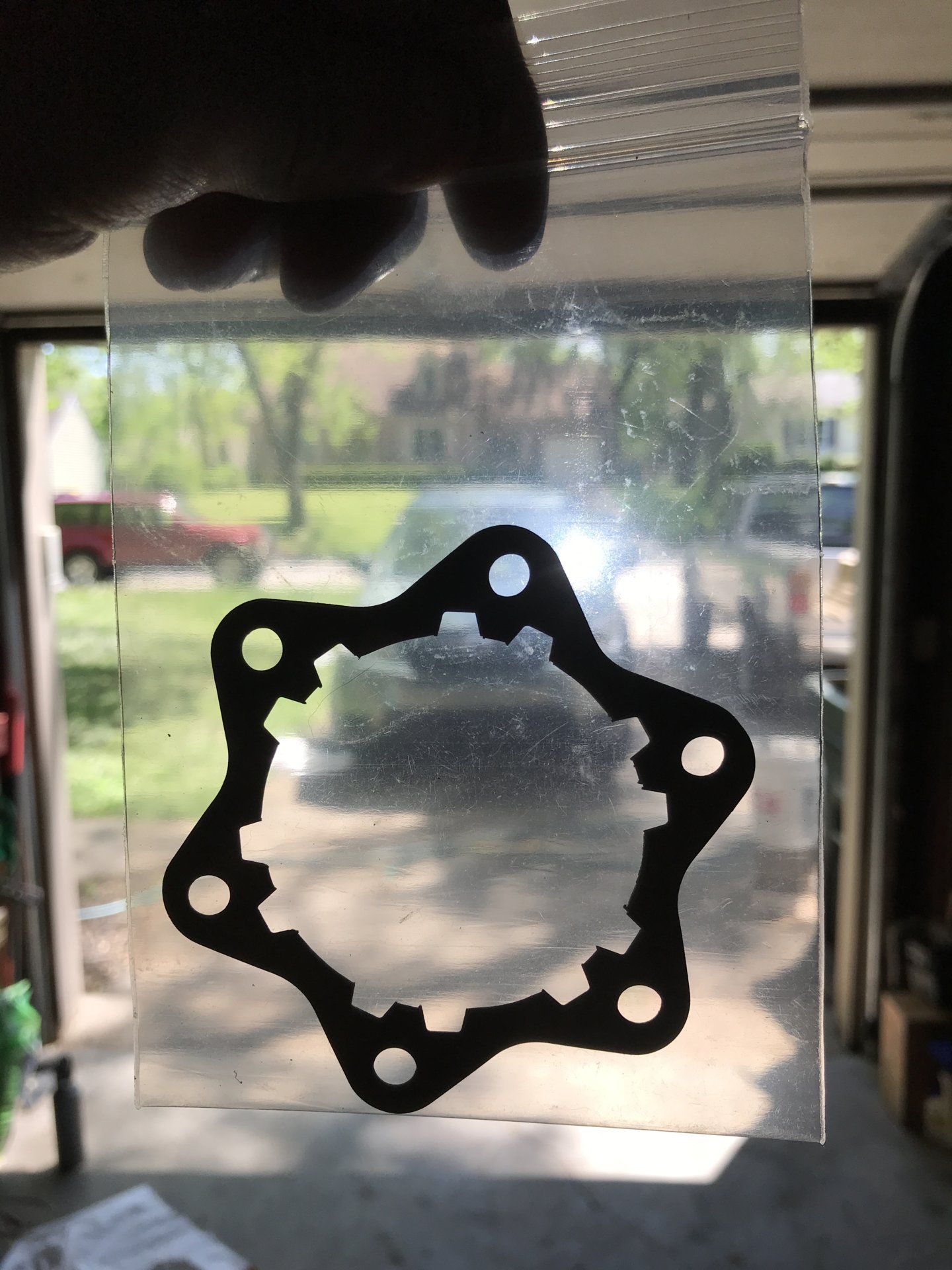

Soo, anyone know what these little guys are for (two gaskets)? They’re the only thing left from my rebuild kit and I have no clue where they go. I’m hoping they are for another year/trim/model?
That's the gasket for the outer cap section of an Aisin freewheel hub used on factory part-time 4wd 80 series (like mine).
There's another gasket (might be identical to the one used for the drive flanges on full-time 4wd 80's) for the body of the Aisin hub to mount to the actual wheel hub.
