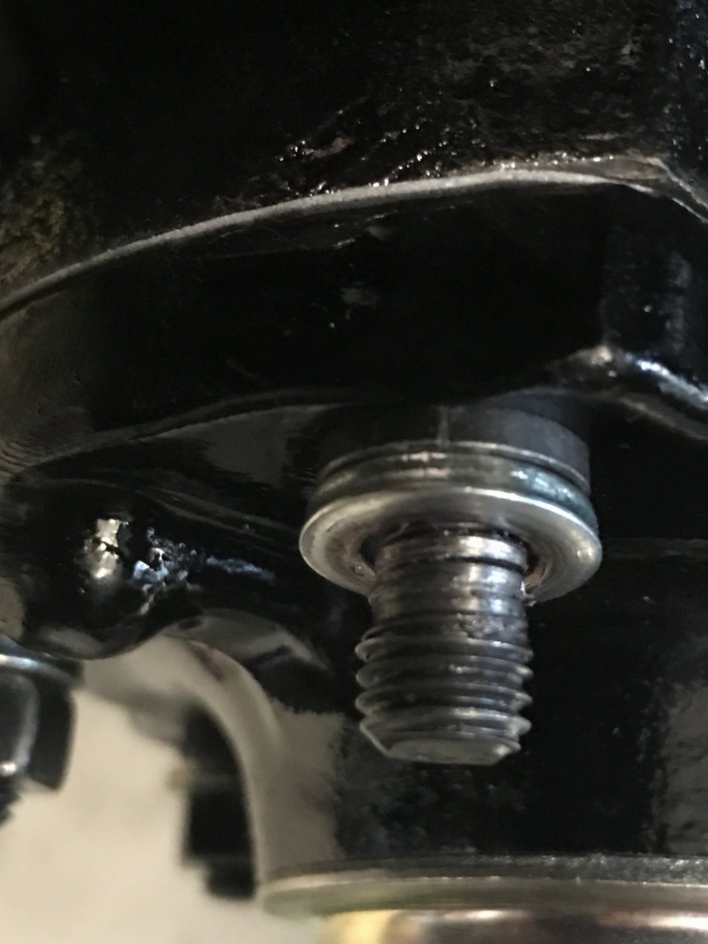

Has anyone experienced Toyota OEM studs stripping before getting to 26ft lbs.
Brand new studs ordered from Toyota. 3 stripped on US driver side, 4 on US passenger.

I have snapped one before. Maybe your torque wrench needs calibration.
Maybe...it's been a while since I had them calibrated.
I replaced the stripped studs and had no problems with the replacements. Wonder if it was just a "bad batch". The ones that stripped were all in a sealed bag from Toyota.

Are the correct nuts being used? That area of stripped threads looks rather small compared to the depth/length of the oem nuts which contain more threads than a nut someone may have picked up at a hardware store.
I would assume yes. They were all in the same bag and worked on 7 of the 12 studs. They are OEM from the Toyota dealer. I was able to back the nuts off of the studs in the picture. The US passenger side involved a little bit more creativity, as the nuts would spin freely, no matter what direction.
Yes! My rear studs stripped and snapped so I replaced all of them including washers and nuts. They are cheap from mud vendors and well with piece of mind. If it wasn't for me being too lazy I would replace all of my front studs too. Although none of my front stuff had any issues, but rear is a different story.
I say if you are doing rear axle rebuild you should always replace the studs. It really doesn't take that long, infact it would have taken shorter had I not have to deal with broken studs and all the rework to replace them anyways.
Mine were brand new studs from Toyota
I just did mine last night without any stripping issues. I found most were very loose so I torqued the studs in at 60 lbs then reassembled and torqued the nuts to 71 lbs per the FSM.
