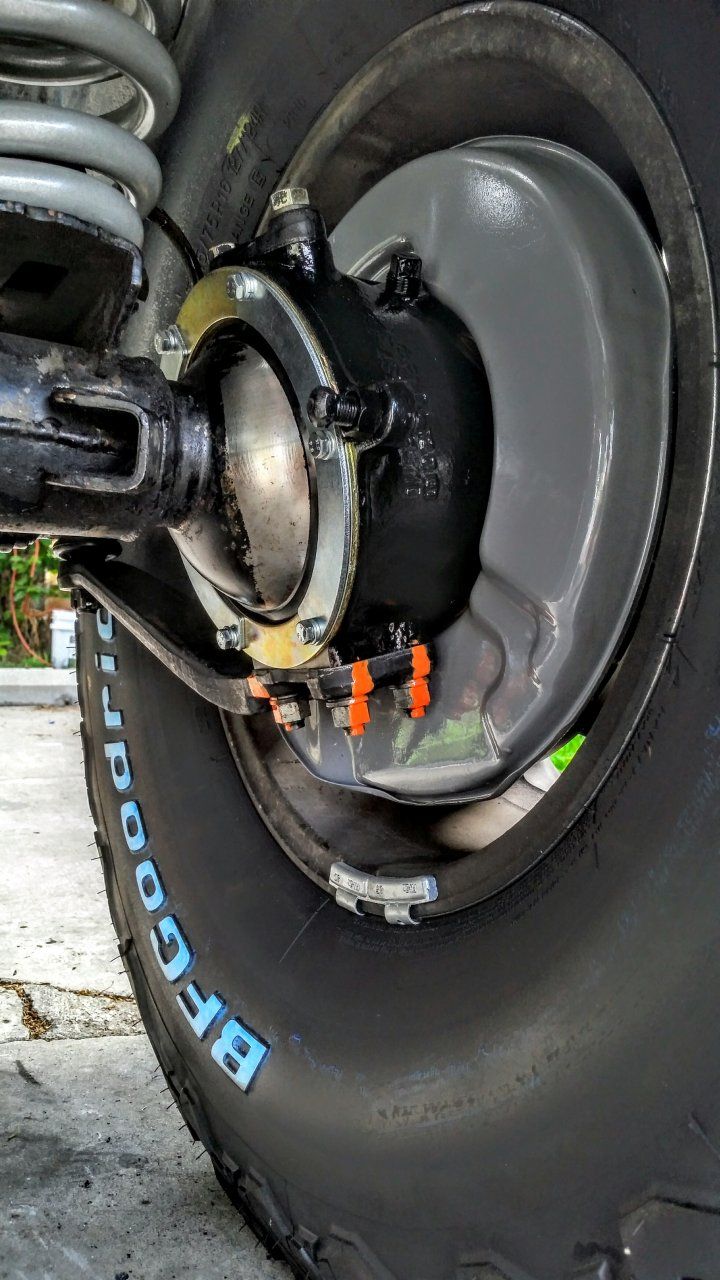

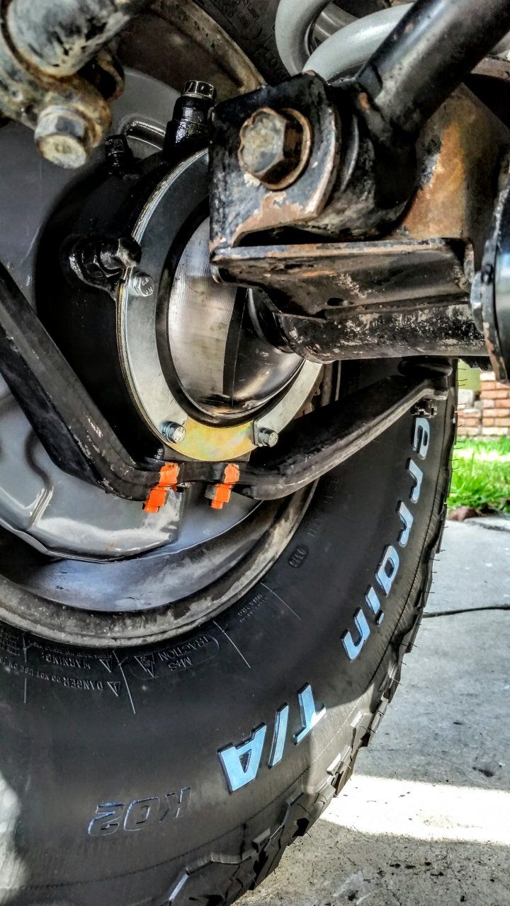

I found the knuckle studs to be loose. On my rebuild I used loctite and used paint to make it easier to see if the studs come loose..
View attachment 1287292 View attachment 1287293
Great idea The only change I will make is using the white color to match my 80:D
