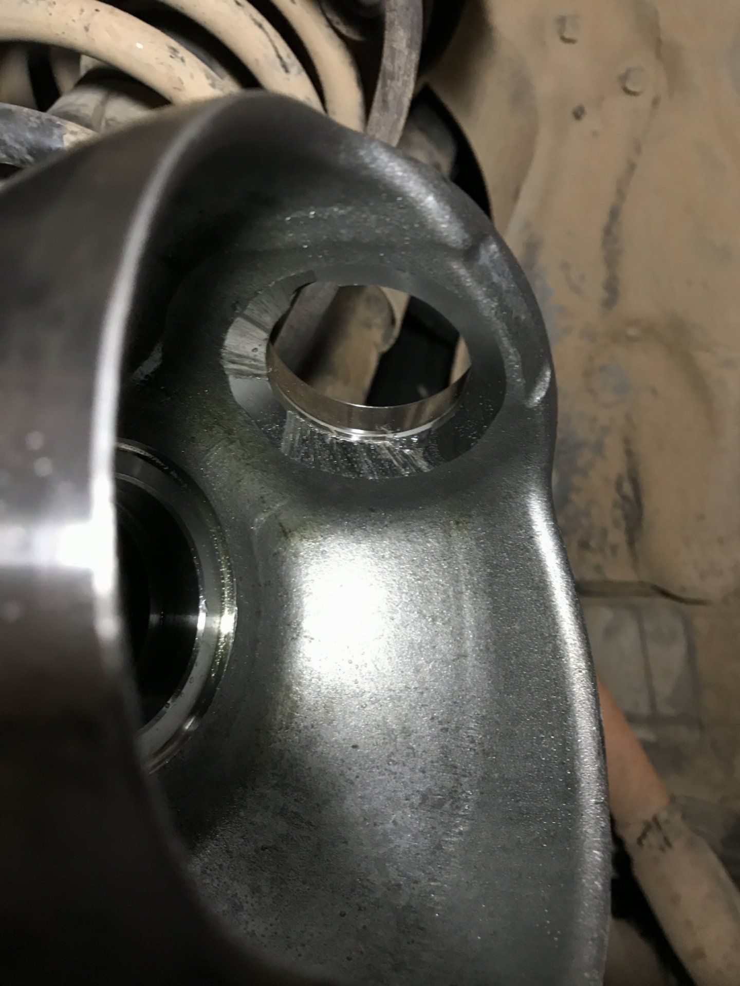

In the middle of my rebuild and noticed the top of the inner knuckle housing around the bearing races is extremely gouged (on both sides) - pics attached. Is this normal or do i need to replace the inner knuckle housing? I was just planning on switching sides with the birfs.
It was mostly diff oil in the housing when i pulled apart - could that cause this excessive wear?
Dont feel like the Lone Ranger. I have the exact same thing.
Exact same thing over here. I spun the axle free. At tear down I had a disintegrated inner wheel bearing as well. Did you do what you could with Emory paper and ride it out? Don't see what else you could really do.

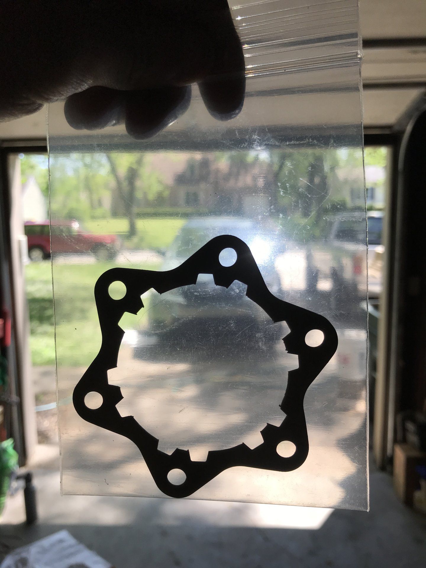

Soo, anyone know what these little guys are for (two gaskets)? They’re the only thing left from my rebuild kit and I have no clue where they go. I’m hoping they are for another year/trim/model?
That is not for your 80. That is for cars with part time hubs. The kit you bought is for several different toyota landcruiser series rigs.
Awesome. That was my hope/thought.

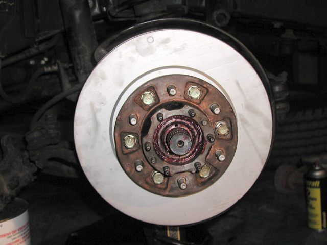

ugh sorry for that empty post. So I'm wrapping up the axles and I'm down to putting the rotor and hub on the spindle. Does everyone have such a hard time getting the damn thing to seat? The spindle I'm working with is really trash but I sanded it down and it should seat. Gave up on this one and buying a new spindle. @IdahoDoug said in the write up it can be tough but geesh. Didnt have time to get the other spindle and try the other side, but checking the fit of the bearing around it while off the truck looks to be just as tight. Any ideas on how to hammer it on would be righteous.
First timer here. I blame the TX heat but I realized the rubber between the spacer ring and felt I installed ridge toward the knuckle just now.... opposite. I got the housing bearings and spindle on. Should I keep on going or is that catastrophic? I'm hoping that it will flex and work just fine. Let me know your thoughts, thanks!
Man. I have. nothing constructive but sure am curious to know what you decided.
Hey Tom without any feedback I just kept on trucking and left it as is. I'll get it right on the other side and will have an experiment. Definite learning curve here with all the components involved. As far as getting it all seated, I had to use a 2 foot cheater and tighten the snot out of the jam nut before backing off. Otherwise my "fish scale" reading was very high. All the best!
Good to know thanks for the update. Your experimentg will be interesting. post back after a 1000 with some pics. Also thanks for your rotor seating info. After I couldn't get it on with my large arm muscles I thought I'd use the nut to just index it on the spindle race shaft thing. Wouldn't have thought about driving the whole thing on with just the nut. Threads are dainty as well as the depth of the nut. So I'll press pound press and cuss it on. Thanks bud.
I'll report back my less than scientific findings...
If you do manage to get it all seated with man power alone, we're going to have u tested for performance enhancers. In my case I was well over the FSM's suggested 43 ft-lbs... may have went too grease happy. But hey it's only precision machined, expensive replacement parts so what's the worst that can happen?
... Otherwise my "fish scale" reading was very high. All the best!
New grease, seals, etc, make for higher drag, one of the reasons I don't see that method being accurate, too many variables. Went to the torque it to a number preload, much more consistent, depending on use, tires, etc, somewhere between 25 and 35ftlb has worked well.
