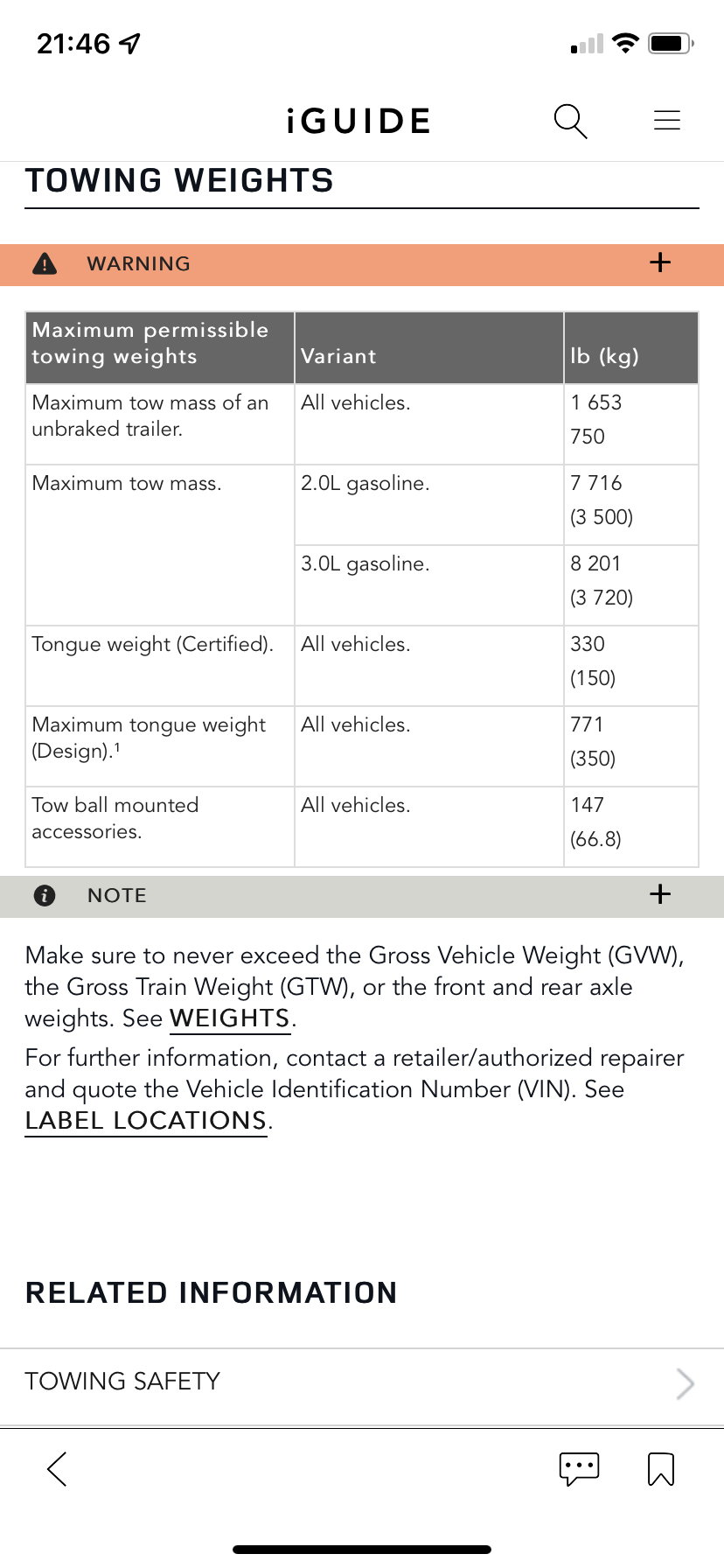

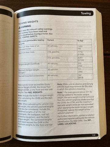

How does a defender tow 8200 with a tongue weight max of 330lbs? It's it only for using a trailer dolly?
I’m not sure where you saw the D130 has a tongue weight of 330lbs. That’s incorrect.
In the manual:
And online
There must be some nuance I don't understand. Maybe lost in translation between English and USA rating systems? I'm assuming it's not a lb/kg typo. My guess was that the 330lbs was something like a J2807 standard so that would be most equivalent to what Toyota would rate the LC tongue weight at.

771 lbs is the correct rating (without weight distribution). Weight distribution is actually “not recommended” by Land Rover because of the air suspension software. I’m sure most of us here in the U.S. still use it, but I don’t believe it’s popular in Europe. They have much stricter laws about towing speeds, weights, etc.
I'm not sure what those numbers mean. The 147lb max accessory weight doesn't give me a lot of confidence. I don't love the ratings for non-WDH being different for a few reasons. The main one being on rougher roads you usually don't want the WDH set very high because it not only transfer weight forward - it also transfers weight back to the trailer axles. In places you're worried about bending trailer axles on rough roads, you'll want to unload those WDH springs to reduce the loads on the trailer. If the hitch is limited, you're getting into questionable territory.
In England you can tow with as low as 4% tongue weight I think. Going short distances slowly changes the considerations a lot. That seems to then fit with 8200lbs and 330lb.
What is that based on? If that's the right rating - why would LR put 330lbs in the manual? Is there any JLR info on this anywhere?
Edit: Looking at the LR website it has some fine print that says:
"The maximum coupling point (nose weight) only applies to trailers with overrun brakes, without overrun breaks the maximum coupling point (nose weight) = 330 lbs. Furthermore, the coupling point (nose weight) must not exceed 10% of the gross caravan or trailer weight. For further information, please contact your preferred Land Rover Retailer."
The first part - unbraked trailer max is 330lbs vs braked trailer 771lbs. Okay. Makes sense... sort of. Why would the tongue weight be material to the braking? The trailer weight braked bs unbraked makes a ton of sense. Tongue weight? not sure how that matters. But it's not related to WDH apparently.
The second part raises more questions for me. Why would they limit tongue weight to 10%? That's less than what most travel trailers recommend and not really even within the range of what you could do in a typical travel trailer. (High polar moment => instability => higher necessary tongue weight to load). So for an Airstream Bambi that has a 3500lb empty weight and 525lb tongue weight - you'll then add 75lbs for a hitch and you're at 600lbs tongue weight. To meet LR spec you'd need to add enough weight to the back end of the trailer to cut that tongue weight in half. I think that would end up being legitimately dangerous to take on the road.
For me - JLR is telling me that they don't want people to tow. The only ways to stay within the MFG specs are nearly impossible in real world use and probably dangerous. There is almost no plausible scenario you'd ever safely tow an 8200lb trailer in the USA safely and within all of LR's specs.

There are definitely confusing nuances that I’m sure exist due to different laws and different applications in different countries. The number that matters here in the U.S. is 771 lbs, which is roughly 10% of the trailer tow rating (8200 lbs) as expected. A bit less than you’d find on a pickup truck…but not enough to matter.
Logically, if the tongue weight were actually only 330 lbs, there are plenty of men in the U.S. who wouldn’t be able to stand on the hitch without exceeding the vehicle structural rating.
There are definitely confusing nuances that I’m sure exist due to different laws and different applications in different countries. The number that matters here in the U.S. is 771 lbs, which is roughly 10% of the trailer tongue weight as expected.
The hitch accessory max is 147lbs. I think most American adults probably should not stand on it. Or at least not jump on it without exceeding the load rating. Is it made out of cardboard? :)
