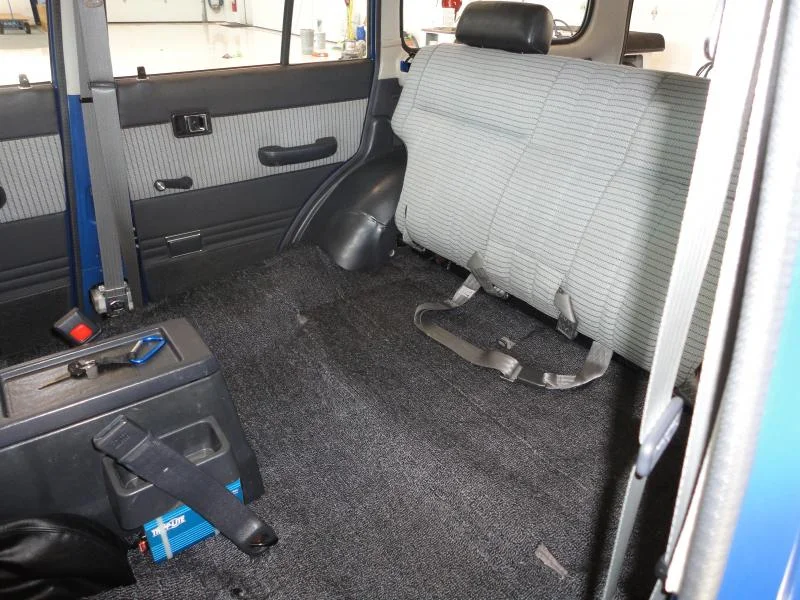

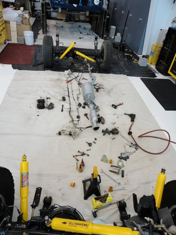

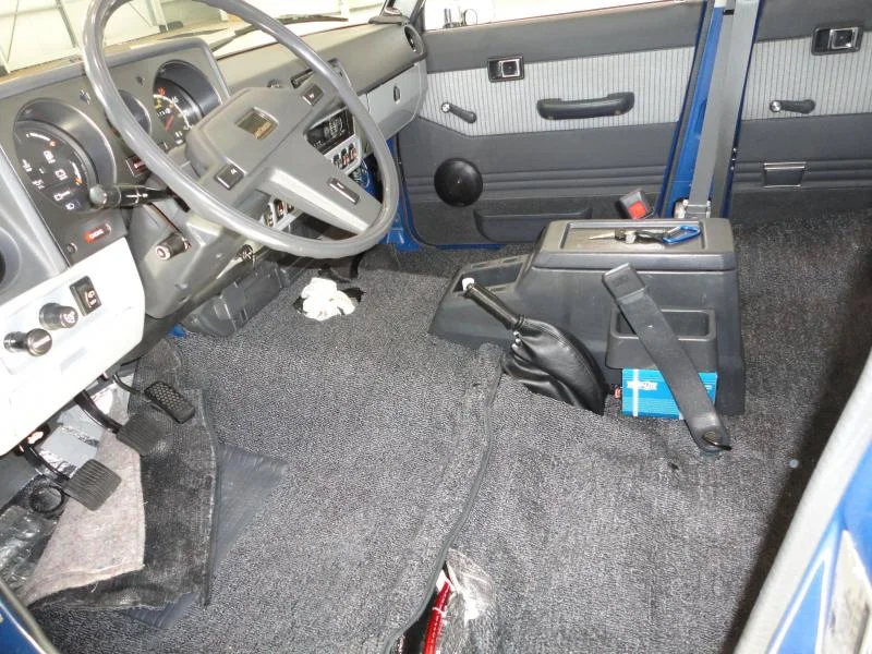

Before getting dirty from working underneath I pulled part of the interior to access the body bolts and gear shifter. I didn't have to pull the tunnel or the transfer stick.

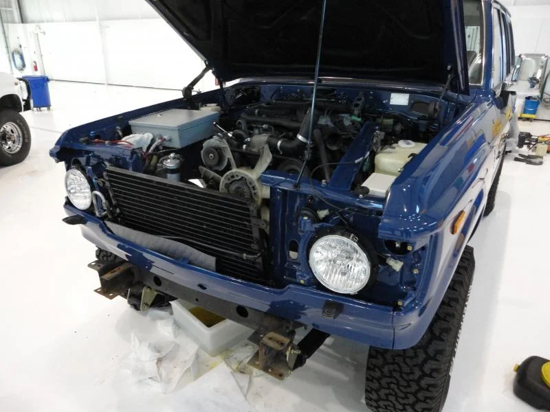

Then came the radiator and bumpers.

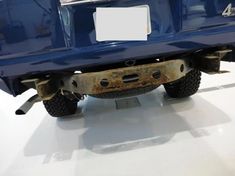

The rear cross member will have to be replaced.
After removing the radiator I unbolted the AC compressor, slid it forwards, and tied it to the fender. This allowed enough slack in the AC high pressure lines to slide the evaporator beyond the valence and rotate it down and out of the way. I'm hoping the AC will hold its charge despite the twisting and disturbance.

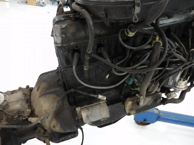

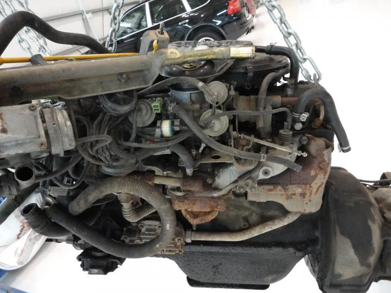

I think it's easiest to pull the engine with the gear train attached if your crane can handle the weight.

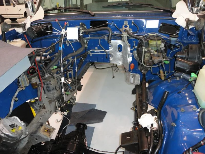

I left all the accessories and smog components on the engine. They'll be easier to pull while on a stand. Plus, the focus of the day was getting to the frame.
I haven't decided how much work to do on the 2F while it's out. It leaks pretty badly from both mains, the valve and side covers, and probably the pan too. I bought new seals, gaskets, and hoses; planning to fix the leaks, overhaul the carb, tune it up, and replace all the hoses.
Plus I've got a new clutch, pilot and throw out bearings, new H55, and a spit case overhaul kit from Marlin.
The compression is good on all 6, it runs happily, doesn't smoke, and was getting 15 mph on the highway with 31's. The flip side is that it has 200,000 miles on it (driven by someone else with unknown maintenance habits). And it's already out.
Any advice about doing an overhaul now?

All I can say is that I'm jealous you have the time to do all this work. My frame and body is marginal at best. Your truck is amazing! Keep at it. You're doing an awesome job.
If compression is good, I say leave it alone. Just fix leaks and clean it up. But it certainly, while out, would be much much easier to put new bearings and rings in, a "farmer rebuild" as it's called. Many have done that gotten lots of good miles out from it.
I started to do that with mine, but ended up with a full 40-over rebuild 'cuz of scored cylinder wall from broken rings on the POs rebuild.

I'll probably wait to do major work on the engine. It doesn't particularly need it and I may be doing a diesel swap on one of my 62's. That would leave me with a take out 3FE and an ideal situation to build a 2FE for Frankie. In the mean time, I like how Frankie is nearly all stock and my mods are removable.

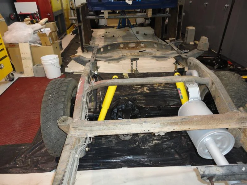

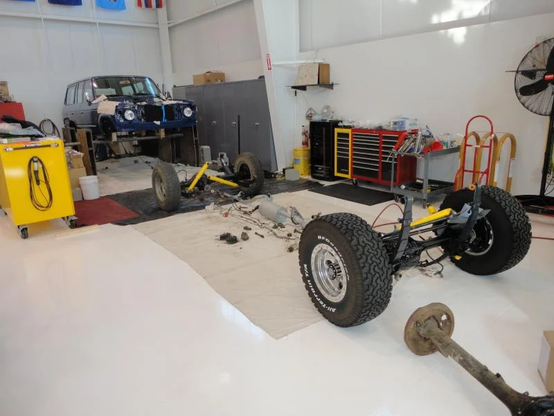

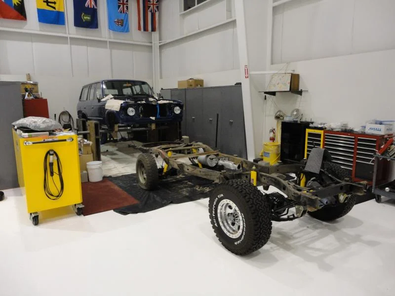

We used something of a 'shade tree' technique to lift the body off the frame; three jacks in a tripod, one in the rear and two at the firewall. It worked but had a few sketchy moments.
The homemade plywood horses have one corner rounded to use as a cam and rotate from a low stance to a high one. This worked the first time a couple of years ago but there were only two of us this time and I wasn't willing to risk something going wrong after investing so much work into the truck.

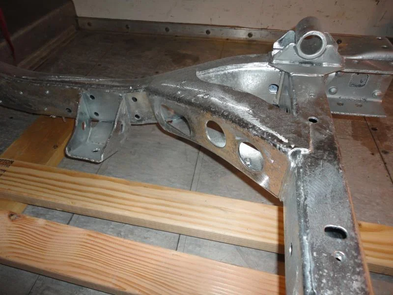

Typical to our Land Cruisers, the front half of the frame was in pretty good shape but the back half was showing rust at the rear cross member and at the C-Channel inserts just aft of the axle arches.

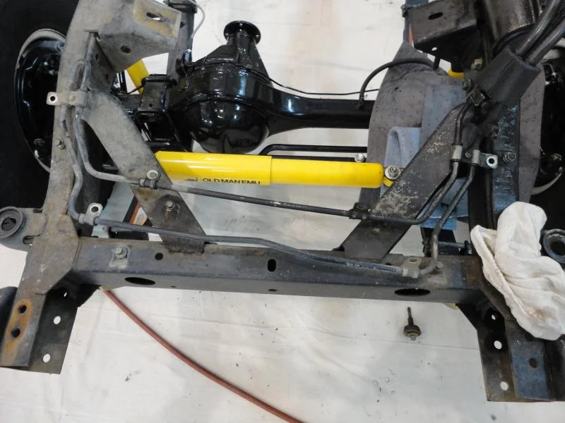

Removing axles and all the fuel and brake lines was very easy without the body. It was a treat to have clear access to bolts without dirt and drips falling in my face. With the frame loaded on a trailer the remnants look like an archeology find.
The frame is out to be sand blasted, pickled, galvanized, and powder coated. Hopefully I can get all the small parts and piping cleaned and painted by the time it is returned.

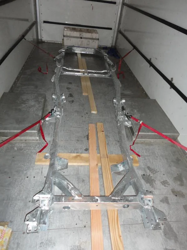

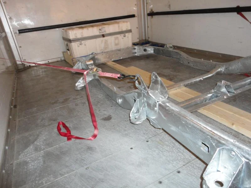

Here are a few update pics. I picked up the frame from galvanizing and delivered it to the paint shop.
It's so shiny now I'd like to assemble it as it is but I know it'll dull and look sad later. Plus the finish is rough and gritty in places. Paint won't fix that but it will hide the worst of it. Protection over pretty (at least underneath).

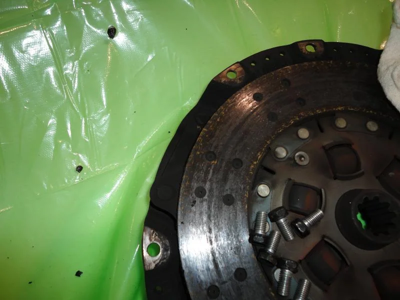

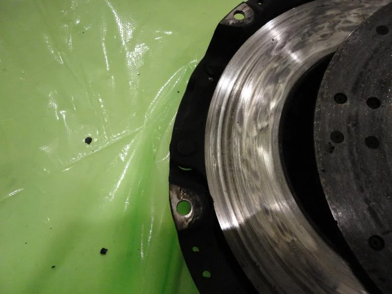

When I pulled the clutch and flywheel I noticed that it was worn to the rivets. :doh:
The fly wheel wasn't scored so much as having a rippled look to it. I don't know if this is common or not. Maybe it could be resurfaced but one of the ring gear teeth was broken too.
I went new OEM on the plate and picked up a resurfaced wheel from the guys out in Keene. It doesn't bode well for my hopes of delaying an engine overhaul to see this much wear. We'll see what the transfer case looks like.
