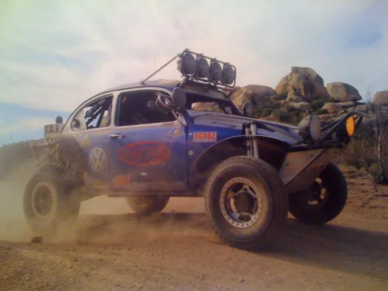

I have Fox 2.0 dual bypass and 2.5 three bypass shocks on my Baja race car. I wonder if we could use a bypass shock on the Landcruiser with the valving like what you have now and then using the bypass valves to tune the suspension for different types of terrain? My 2.5 triple bypass 12" shocks were $1000 each so I am not sure I would want to run these on the Landcruiser unless they would really make a difference. I probably would not be driving on extended wooped out roads like in Baja but I do drive offroad a lot and sometimes with the right suspension setup, the faster we drive over rough stuff, the smoother the ride inside for driver and passengers.
