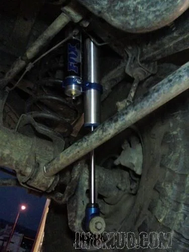

Got the rears on
I got the rears today, oh what a difference in the ride. No harshness from OME. I did a wheeling trip this last weekend and their is a huge night and day difference. I will mount the resi where it is out of the way of the LCA:
nice job dude. It's cool that the ID of the shock ushing allows to go right over the stock lower shock stud.
shock valving is very critical as you found out.
