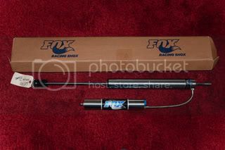

Well, Santa came early today...
Just recieved these from Downsouth...
Front Shock:
Rear Shock:

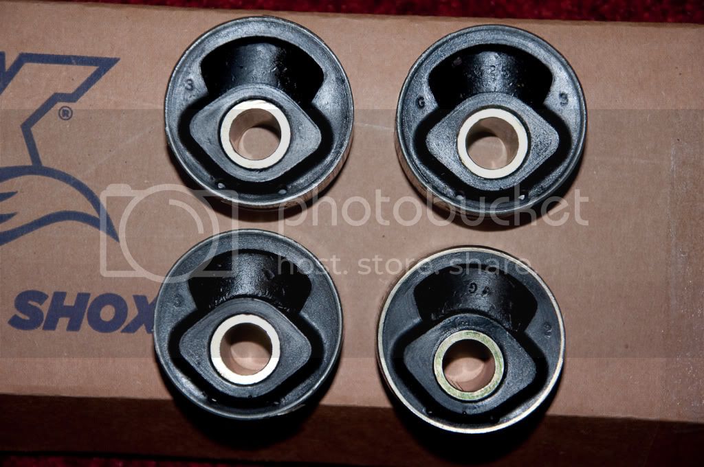

And some 3' Hi Flex castor correction Bushes from Slee Offroad
These apparently don't bind up like traditional caster correction bushes.
Front and rear shocks are 12" travel units. Can't wait to get these onto the cruiser :drool:
All I'm waiting for now is m new set of coils. They'll yeild a 3" lift and are progressive. Probably similar to what FOR offered but are from Australia. Apparently the muts nuts so as soon as I get em on I'll report back.
