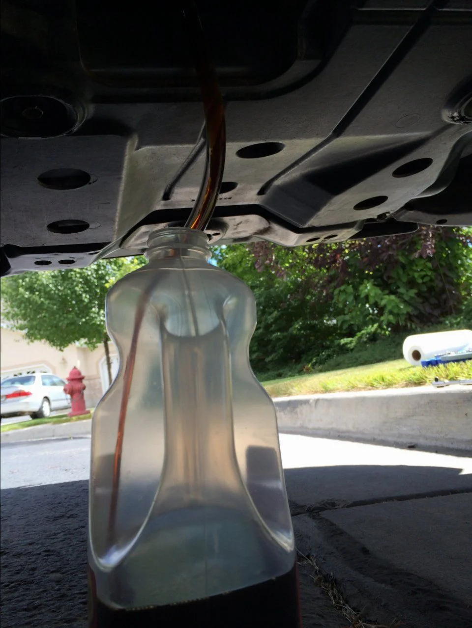

I have one, get the short nipple, so you can attach a house while draining it.
Literally the cleanest way to change the oil. You'll love it, no more oil splashing around while draining.

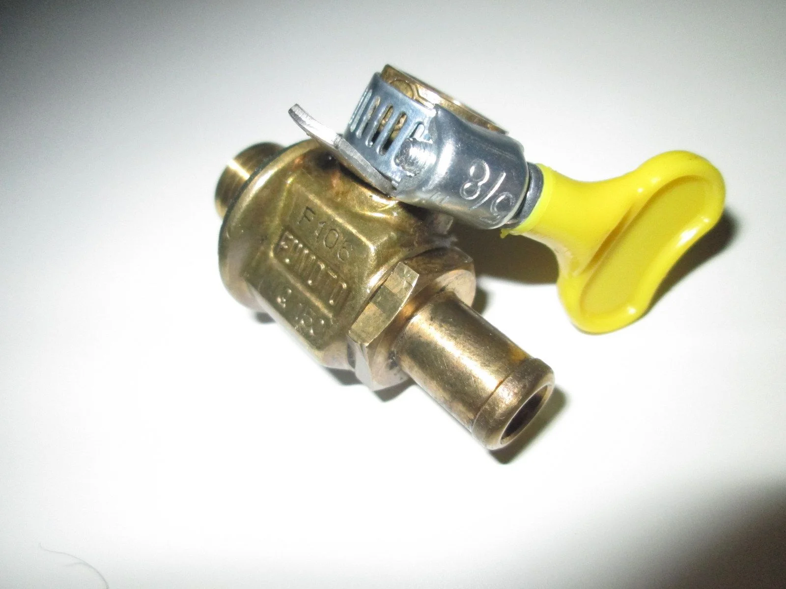

I've always used a hose clamp to keep the lever from coming up, over and open. They didn't always offer the plastic clip, which probably works fine. The conventional wisdom seems to be that you should have some sort of a lever lock for off roading. Btw, this is a similar but different model with a long nipple.

Just for ref, it looks like model numbers for the nipple versions are F103S (short) or F103N (normal)

I installed 2 on mine/brother's 100s and don't recall it being any different to thread than the normal drain plug. Took less than 15 seconds to install. It was the F103N like you are holding.
Pre Slee skid plates and they work great with the plastic or steel skid . . . F-103N
