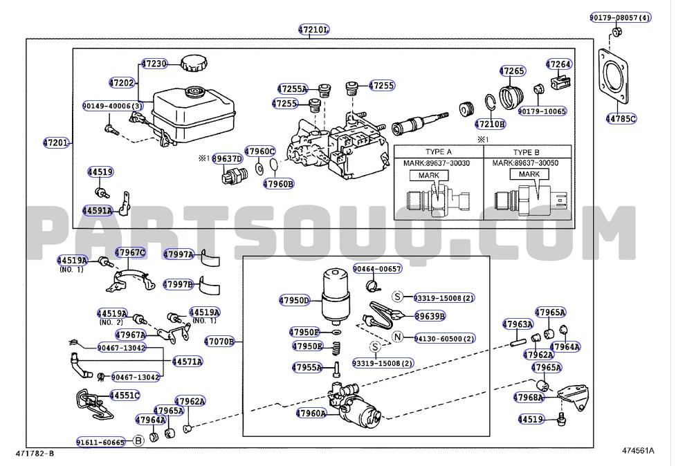

Can you identify which seal you are looking for on this diagram?
That would be a Bosch part

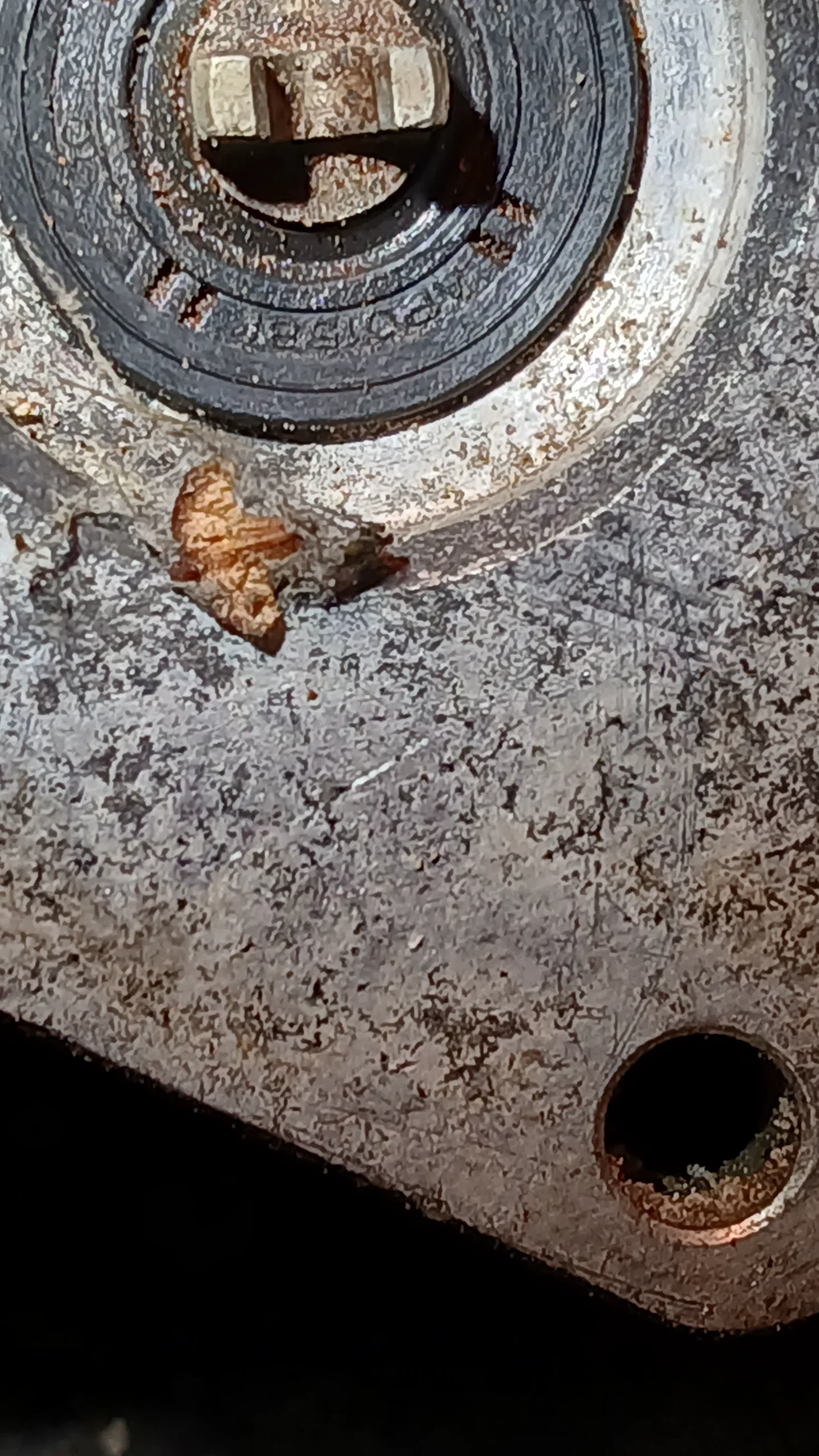

This seal leaks, if air vent hole clogged. The pump, as it spines, creates vacuum. If pump not vented, pump then sucks fluid from seal. This seal, is not a pressure seal. If in okay condition, reusing may be best option.
Do you mean the vent in the void between the pumphousing and el-motor, because that was definately clogged. The previous ovner was a 'mechanic' and the vent was clogged with silicone. He have also used silicone to seal the el-motor casing, resulting in moisture inside the el-motor. You won't belive the crap-ass work he has done to it.
The pump builds up pressure, and I cant see any leak. Just want to replace it now as the system is already open.
But that makes me think that a NBR or Viton seal might be good enough after all.
I did source a teflon coated seal made for som nasty stuff off-shore, but at U$D90 a piece its kind off out of the question.

Yes! Air vent to motor, must be open.
There's also a channels, that drops down from seal. This must also be open/clear of obstruction. It's a weep hole, for small amount brake fluid that may pass the pumps seal.
Brake fluid getting into motor, is second to brake control wire increased resistance (corrosion). Resulting in sudden brake failure (dead booster motor)
Someone, sealing brake booster motor. Didn't understand function of air holes.
