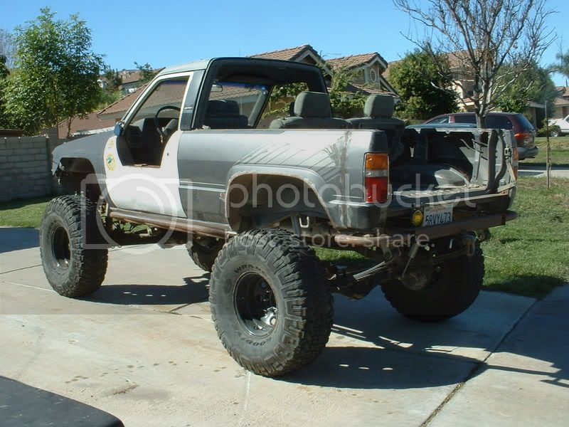

I am no welding expert by a long shot. In my years of welding ****, the best brand for me is Miller. I have done a bunch of welding on sheet metal. I have a Miller 210. I set it on the lowest setting and use .023 wire. I have had good luck with stitch welding sheetmetal
Here is the best shot I have of the 4runner, I use to have (sold it for the 40 :D). The picture shows the 10 inch bob and the 4 inch stretch on the fender. There is no body filler on that stuff.
One more thing to watch out for is grinding. I have had sheetmetal warp from grinding not the actual welding!:doh: I like to use flapper wheels to grind. Taking your time is the key to sheetmetal work. Goodluck!:cheers:
