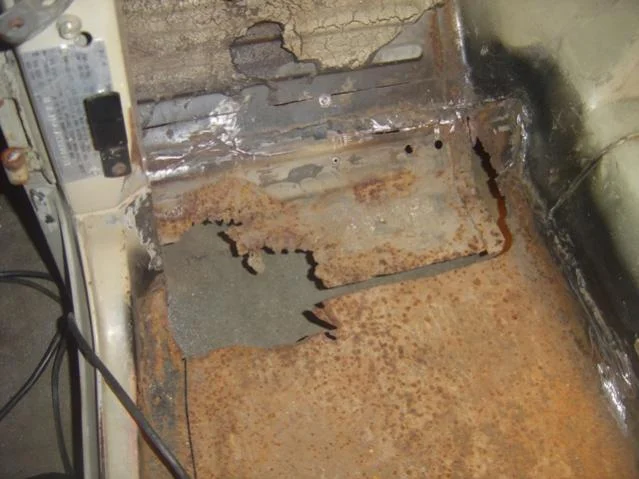

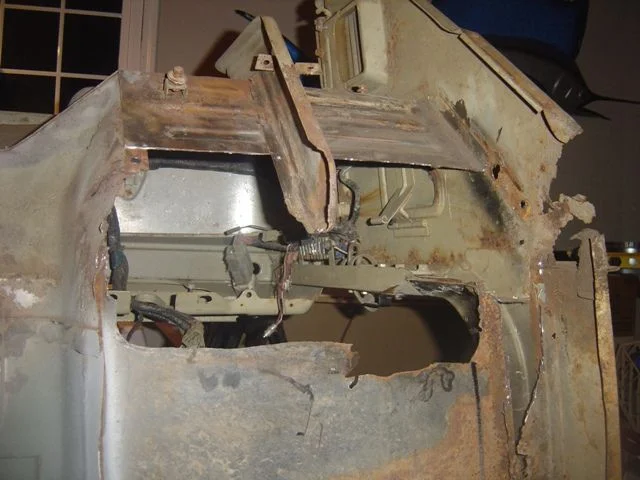

I'm going to document the floor pan repair of my 81. I'm beginning to think Im totally nuts for attempting this. I think pictures speak for themselves.

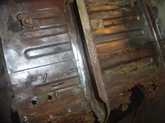

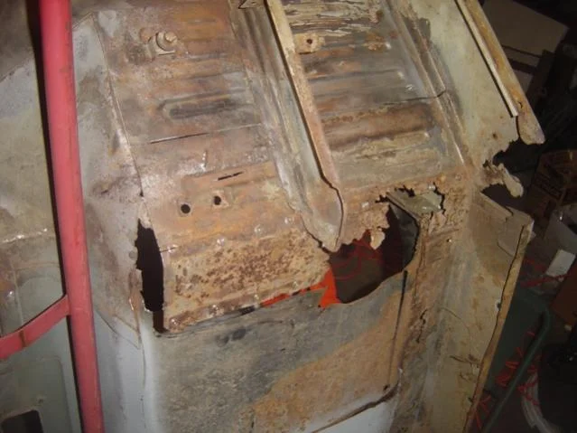

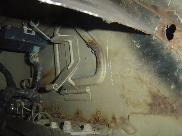

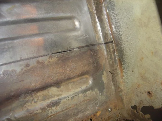

So I found some more rust in my Kick Vent panels (see attached pics).
After removing bottom of the firewall I could see up into the cowl from underneath. What Im seeing is rust bubbling around the seams of the Kick Vents.
So my plans where to repair the lower 6" of Kick Vent, and using Rust Bullet on interior underside but now I'm considering buying NEW replacement Kick Vents for $200 per side.
Thoughts?
Cool! Another brave soul taking on the rust monster!
I would repair the area, it does not look that bad. Remove the rust to get a better idea then start cutting/welding in patch panels.
Try to get all the rust out. Welding to even slightly rusted metal does not go so well when it is as thin as that. Does no look too bad. Check out the build in my sig to see some worse floors. :D Good luck. Tim
So your saying I can wire wheel, grind, whatever all the rust along the seam of the kick vent and then Rust Bullet ~OR~ does it need to be cut out and repaired?

I would not try to get the rust out of the seam. Wire brush to bare metal, then douse the area with muriatic acid along the seam. sand and prime.

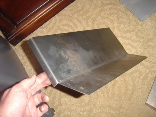

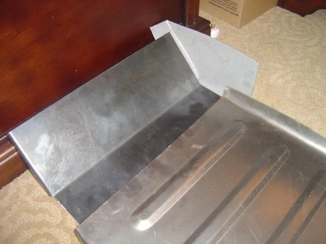

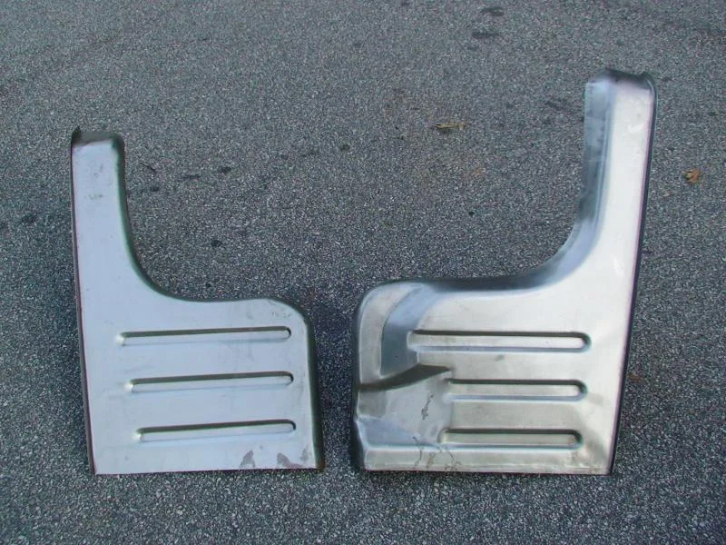

a couple more pics..

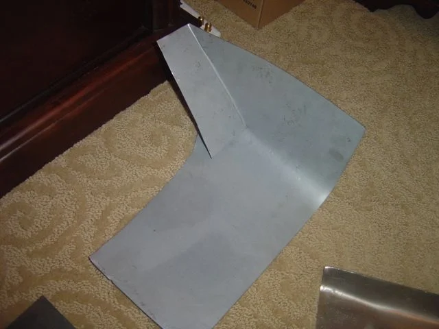

I bought the floor pans from Oscar at PACOL in Atlanta, GA.
He is just getting started and no website, but I liked the guy when I talked to him on the phone so I bit.
I got the number from IH8MUD but I will list again 770-403-8026.
