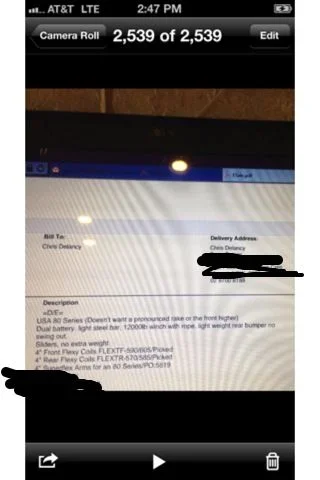

Quote from first email with coil producer-
"On a side note, you are going to change coils on the rear, I would suggest 15mm coil spacers and go 15mm lower in the free height. This is to reduce noises caused by the coil hitting the coil tower."
-End quote
Quote from second email with coil producer-
"The coil spacers are to stop the 3rd row of coil hitting the coil mount on the rear, otherwise it will grind away at the coil and make noises.
Be sure to drop the rear a further 15mm to suit the coil spacer."
-End quote
And last exchange, after my reply that I'd never experienced and coil grinding, quote-
"I have always known about the problem that you are NOT (**) experiencing but I haven’t always had the solution."
[(**) I stressed the NOT in bold for those that skim and don't read.]

If I can ever get a reply from Superior regarding the difference between the Superflex Arms at varying heights, then an order can be placed and on down the road we go.
Until I hear from SE, don't know if it'll be 4", 4.5", 5", be it replacing all four or just the two rear.
Coil producer has offered a deal on coils and have a buddy who can reasonably ship, so a win-win and y'all had your fun for the day.
