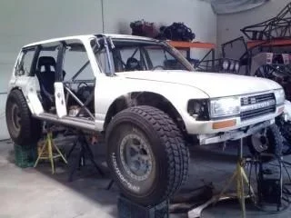

Well, got bored last night so started chopping her up.
Hahahaha.
Money shot.
Kind of have to admit it looks pretty cool, at that point, no debating the merits of the platform choice for intended purpose.

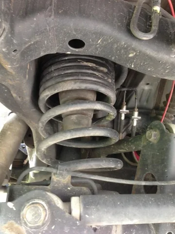

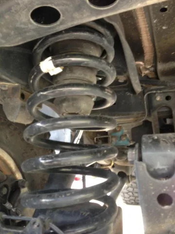

SA coil lengths for Pat's 80 (update with link shortly).
These are to net 4.5" of lift.
Front: flextf605
Rear: flextr600
Does that help at all? Its the only tags i could see on em.
Edited: In comparison to mine that netted well above 4", these are longer.

Here's what I've got and why I don't believe coil cutting is an option, since I'd have to remove all the dead coils to lower, therefore losing the ability to benefit from 30" shocks.
Rear 80
Front 80
Now, if they were more like the FJC dead coil spacings, I could see it, but they're not.
Rear FJC
At static movement, the right coil for the weight will not allow the vehicle to get to the bump stop when twisting it up.
I couldn't get the primary coils to contact one another, either.
Best I can describe, the primary rate it relatively stiff (going to determine later today, the best I can with online calculators) and may be the reason that I'm sitting inches taller than a coil this length should elevate.
