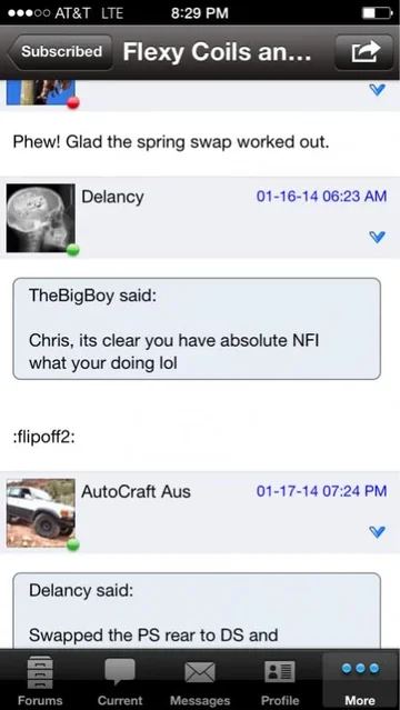

:flipoff2:
For the record, I was perusing this thread attempting to find the measurements I took of shock lengths with the axle completely extended when I happened upon this:
Pretty much, my response was saying "touché"
