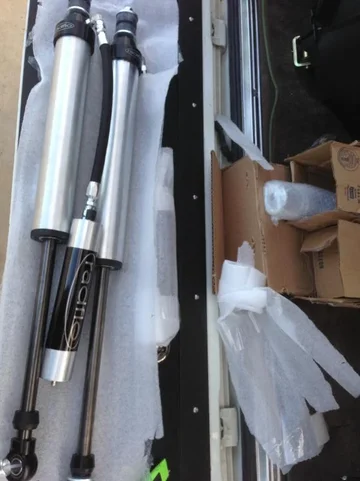

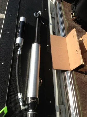

Right now, butt dyno says it needs A LOT, but these arrived
And charged, they're friggin' stiff.
Put the OMEs on without a jack. That ain't happening with these.
