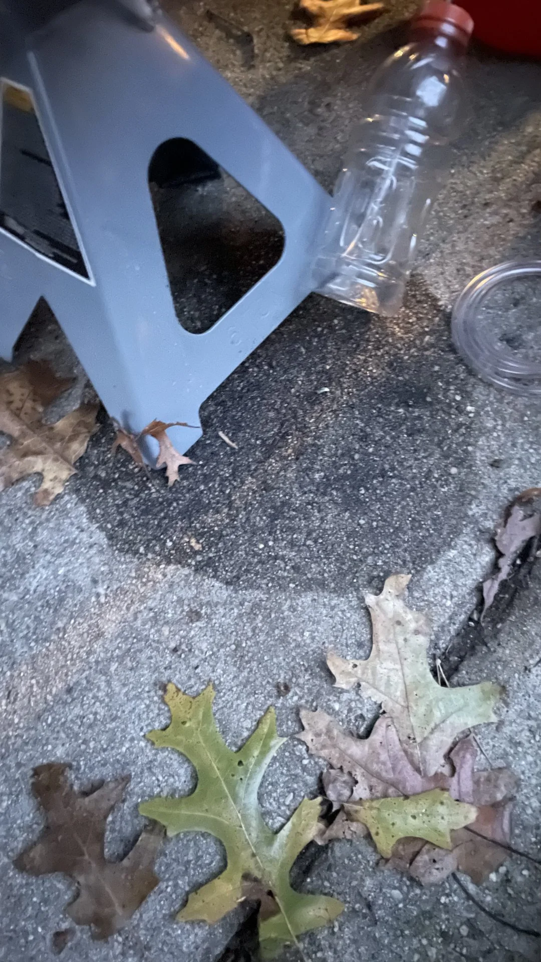

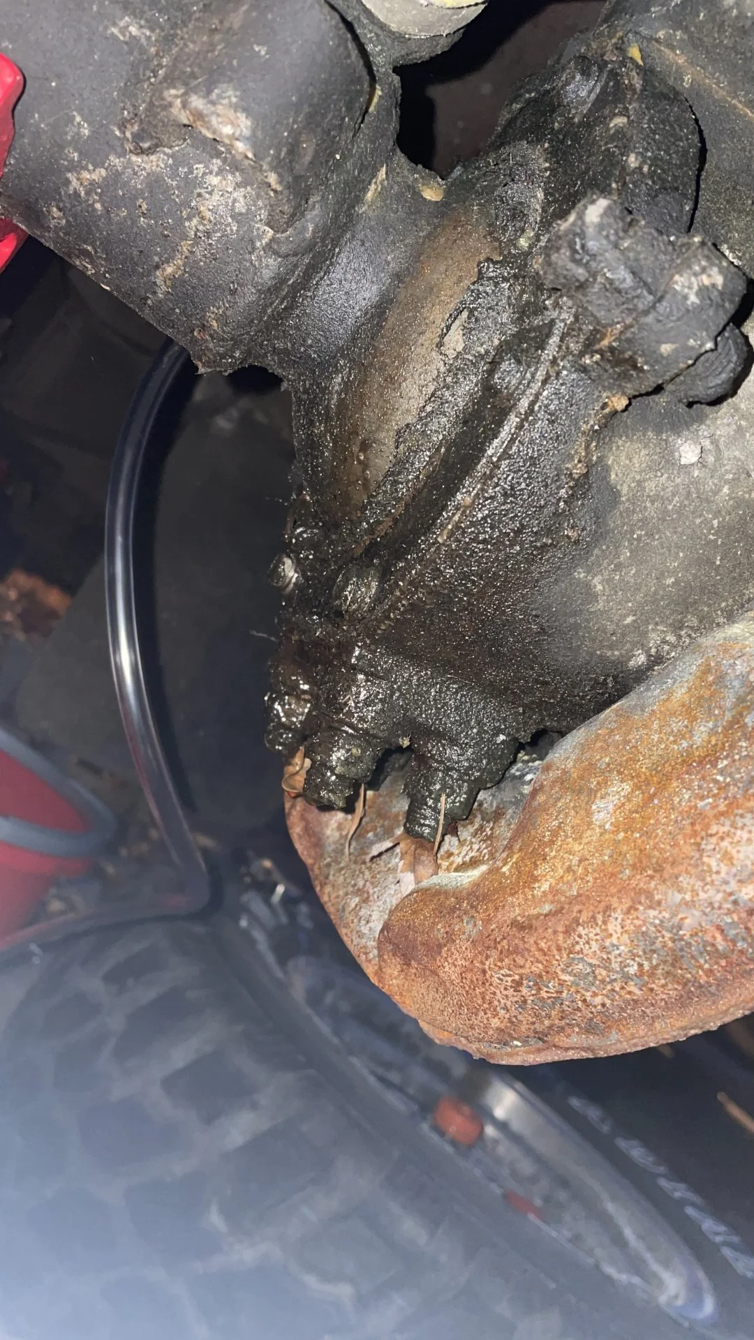

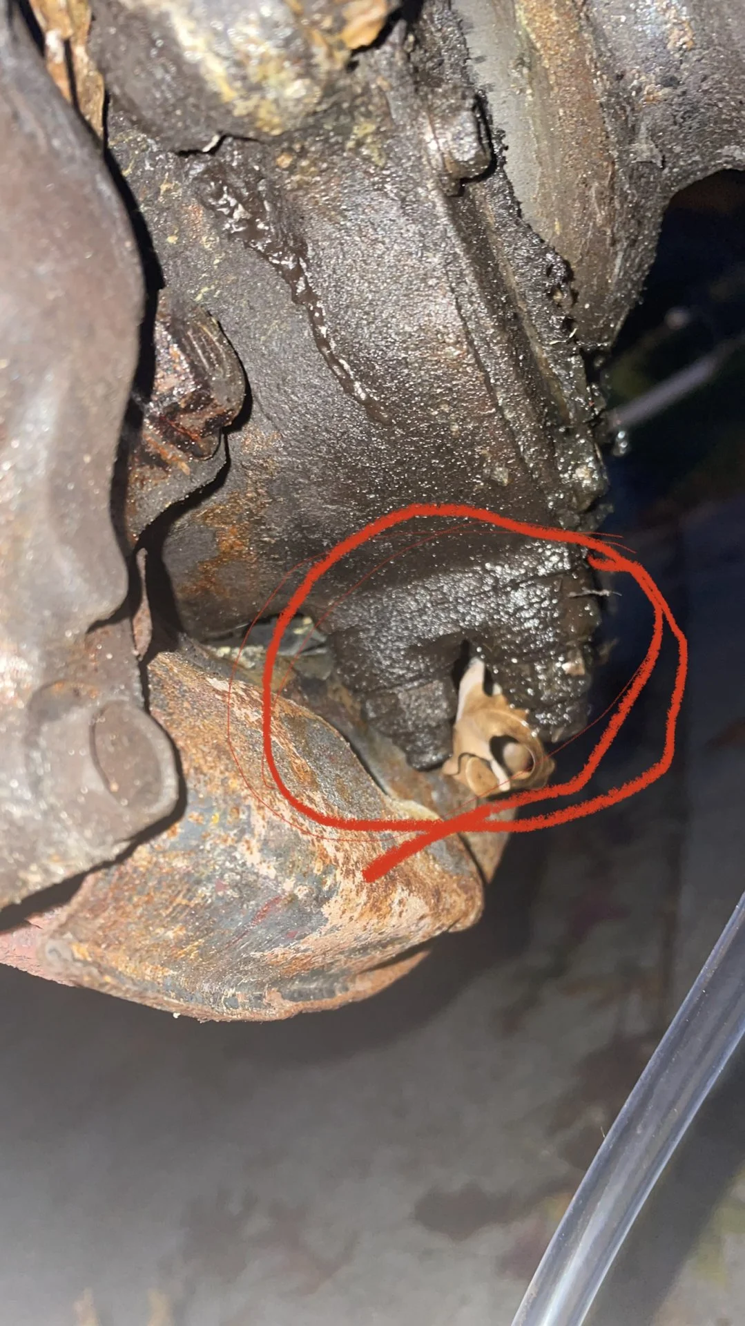

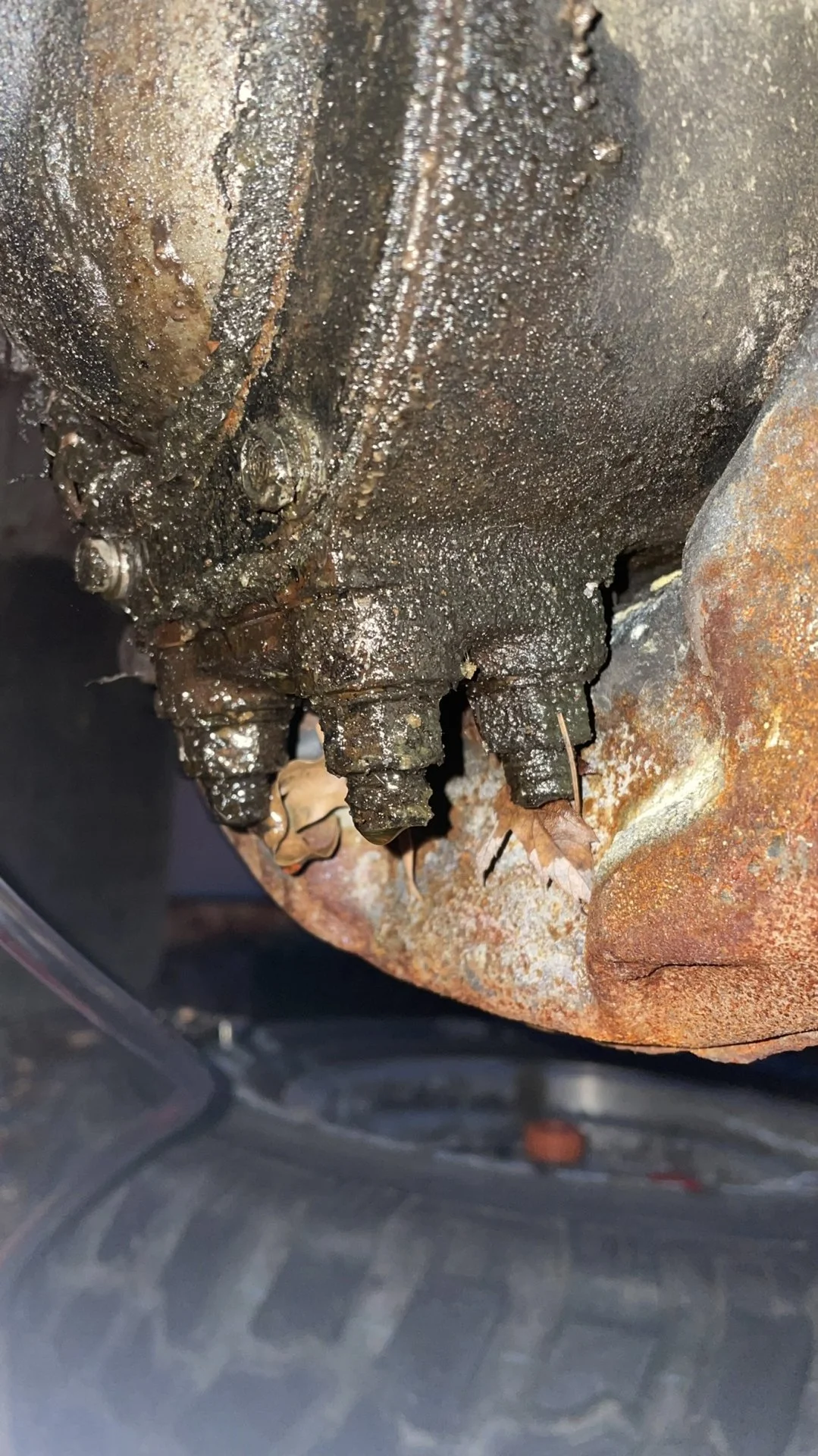

Are we looking at brake fluid dripping off the knuckle?
Yea that’s what it looks like. I poured new fluid in the reservoir and then a pool of fluid formed, and fluid started dripping from the knuckle. Maybe it started from somewhere else but it looks like it was from the knuckle

I mean I unscrewed and took out the bleeder bolt because it was rusted, but no fluid came out when I took it off. The hole in the inside was covered with rust so I opened it up with a toothpick and tried bleeding it again but nothing happened. I’m going to take a closer look tomorrow but the fluid was dripping near the leaf in the picture above.

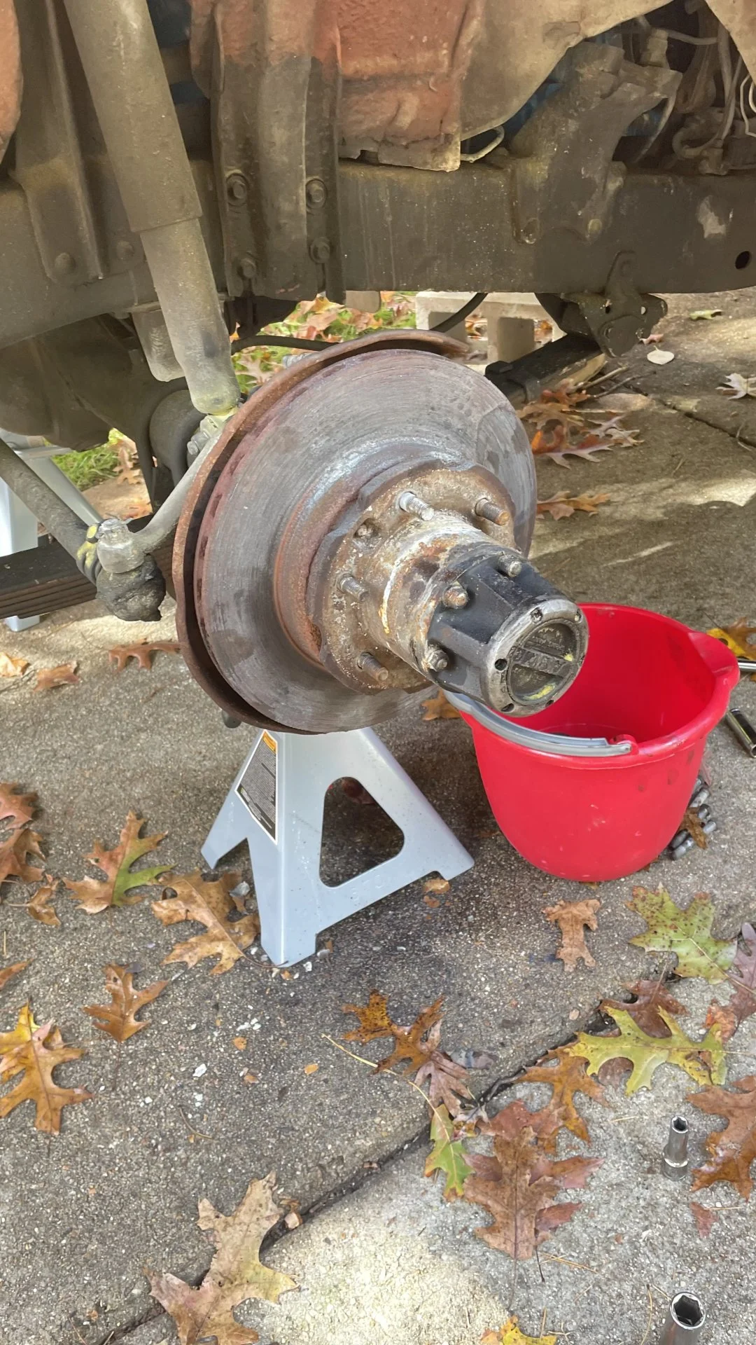

I got the caliper off but I can’t figure out for the life of me how to get the rotor off. Any suggestions?
You have to take the hub off and basically start tearing into a knuckle rebuild. I suggest watching the axle rebuild videos.
