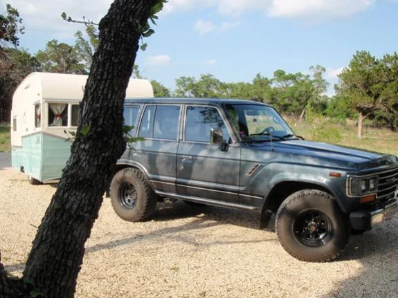

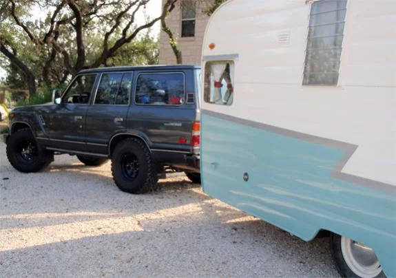

Some background on the rig (pics atached): !35,000, super clean, no rust, never been offroad by PO (light offroad by me). She now has a H55F 5 speed tranny with about 3,500 mis.

Highly highly recommend you get your hands on a FSM. Nice looking truck, BTW.

Pulls like a dream. With the H55F and 411 gears my LC62 is very "torquey". When pulling the trailer, I usually run in fourth gear (try not to exceed 60 MPH) at about 2800 rpm. I find that by traveling at lower speeds it gives fellow motorist time to admire the LC and the trailer. Taking that all in is probably a little overwhelming for the mini-van crowd.
