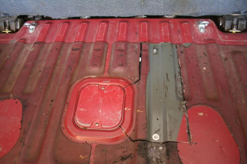

If you're all about looking factory, how Toyota would do it, and overly concerned about looks of a panel under the carpet we're not even close to the same page. :D
I don't think mine looks "like a pile of dick" even though it isn't exactly straight it doesn't let in additional noise, doesn't rattle, won't generate rust, etc. I will promise you if we're wheeling together and both of our fuel pumps fail you'd change your view. ;)
Oh yeah, I sealed the gaps made after cutting this using a cheap angle grinder.
:D If we're out wheeling and my fuel pump fails, it's not going to matter because I don't carry a spare $260 fuel pump...
I finally finished putting everything back together. Thankfully it started and it was indeed the fuel pump! I used a Denso, and if this one last as long as the first one (200k miles) I don't think I'll be pulling the tank any time too. soon. So I agree, an access panel would be nice, but do it right the first time with a factory part and its not likely you'll be in there again.

How are you guys sealing the cuts up on the floor? Dirt roads would be very dusty inside the truck.
