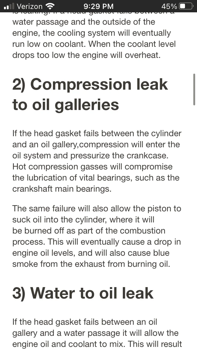

I’m not convinced the head gasket was in good shape prior to the galley plug failure. According to Hayes, if the head gasket fails between the cylinder and an oil gallery, it could cause overpressure in the oil system. This overpressure could be responsible for an oil galley plug popping out. Thoughts?
