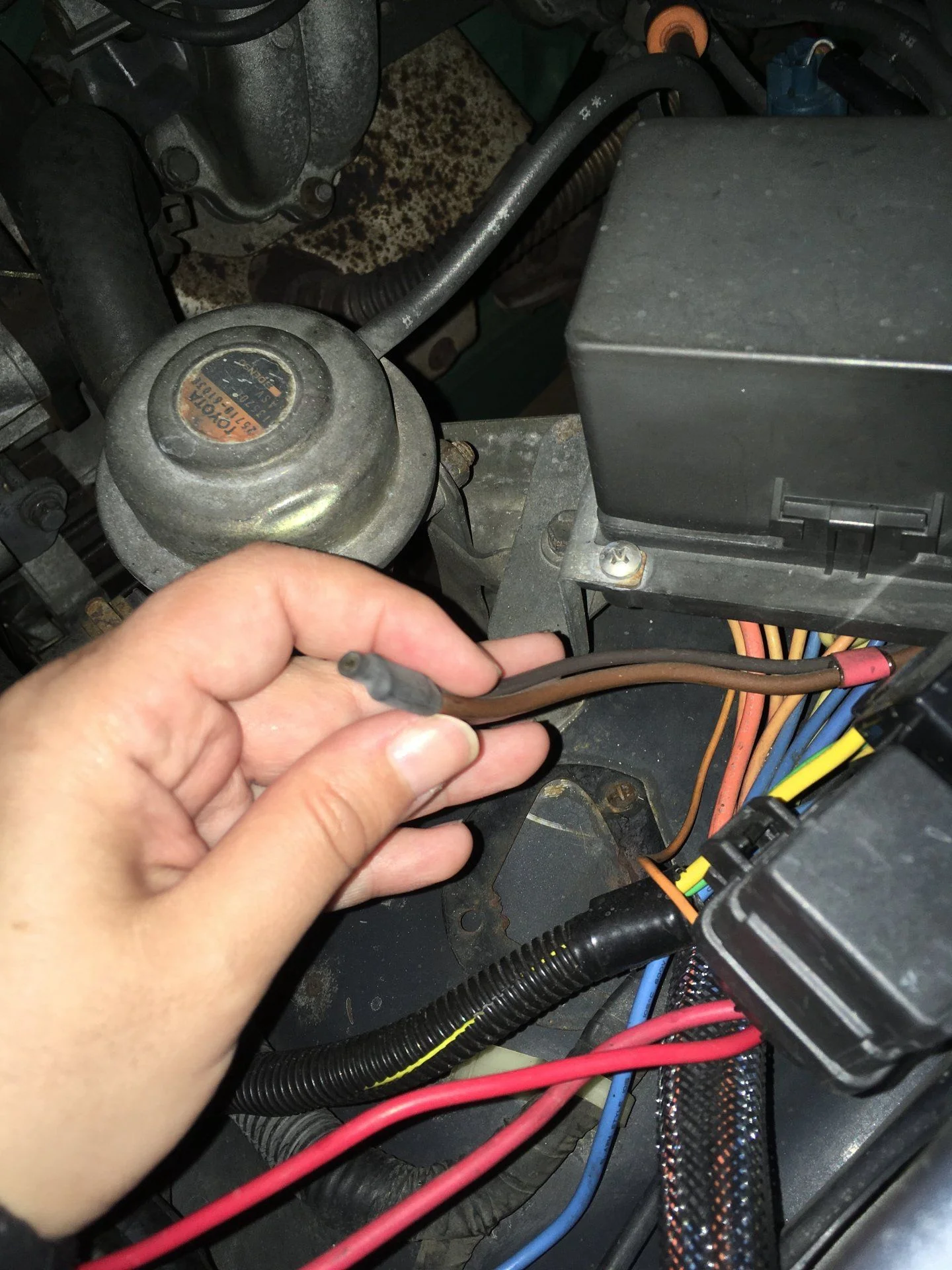

Also, in the engine compartment, drivers side toward the front end, there is a brown wire that’s just loose. What does this go to? My first hunch is it has something to do with the radiator fan that’s been replaced with an electric one but I have no idea.

The black plastic box under the hood is a bussmann accessory relay box, most likely a headlight harness upgrade that was made by @slcfj62 once upon a time. Great units. That free pair of wires is an additional relay circuit to use as you choose! Fat wire is power coming from the relay (to power an accessory device up to 20/30 amps I believe), the thinner wire taped to it at the end is the relay trigger wire.
