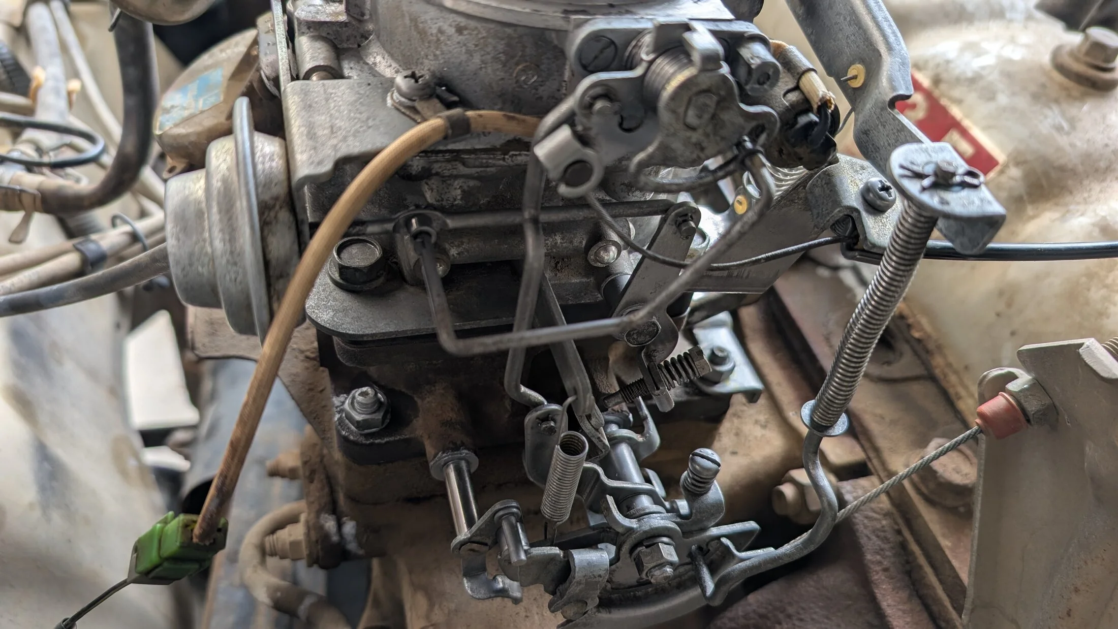

First timer here with a freshly purchased 1989 FJ62 with 3F Carb and glorious 5 speed manual.

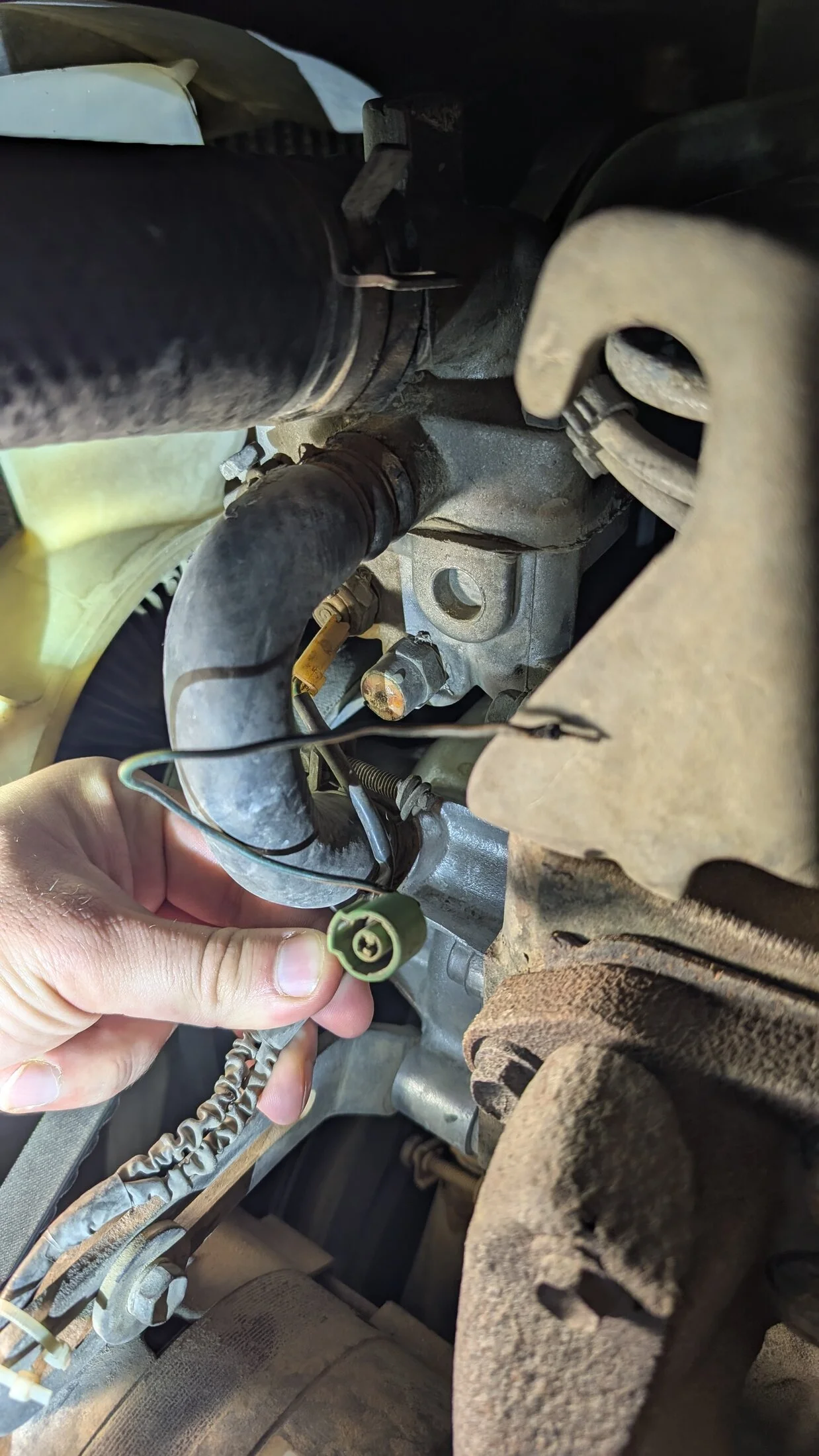

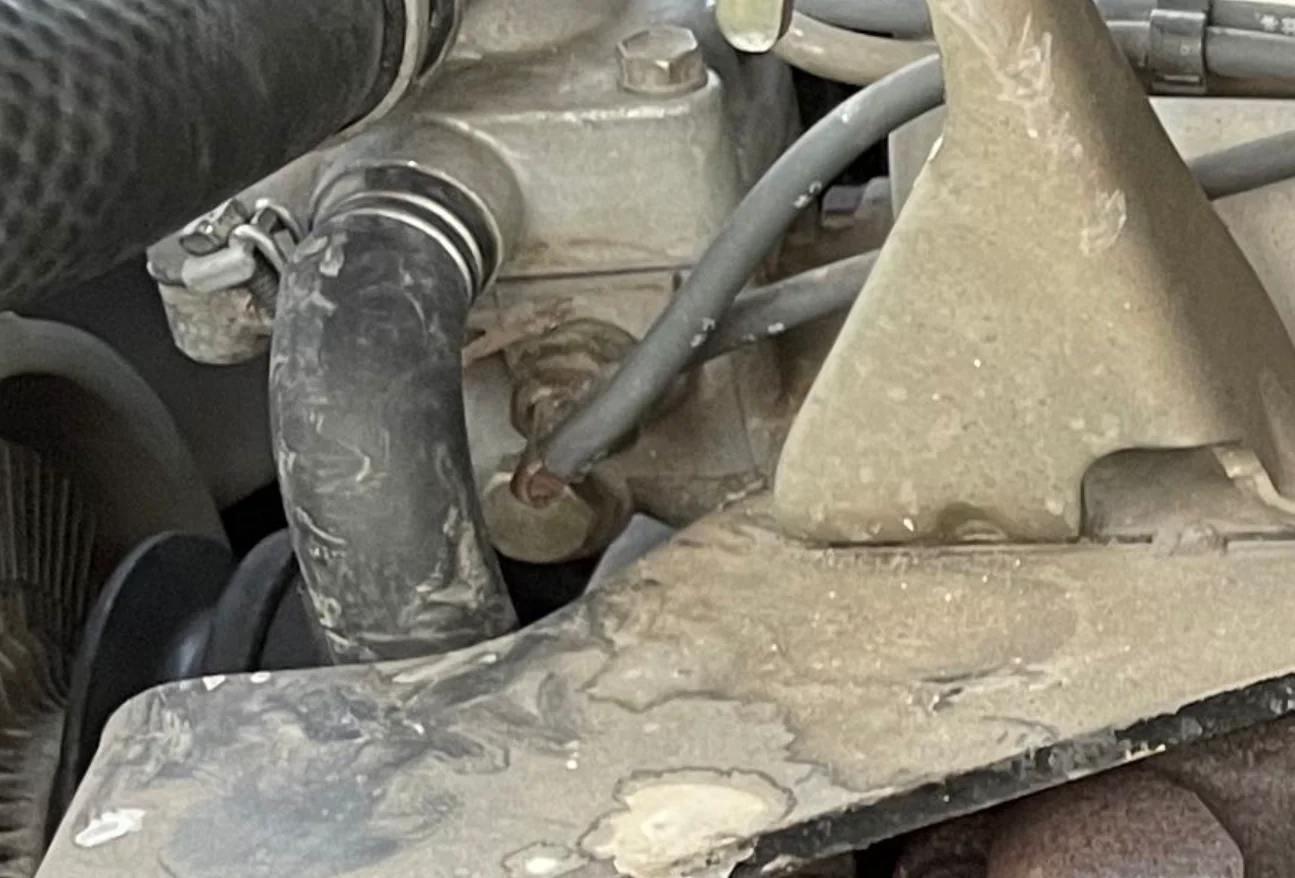

The issue is simple, I cannot, despite much research, find the sensors needed for my cruiser.

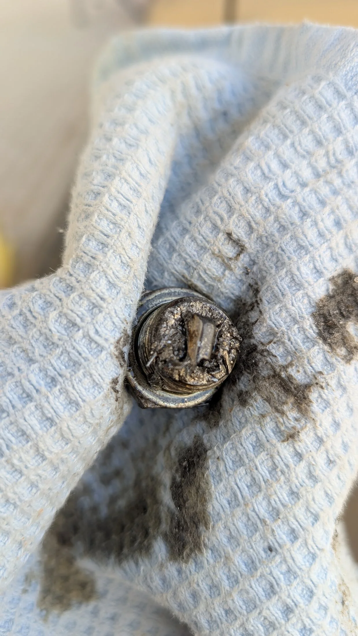

Coolant temp sensor has snapped off leaving a O-Shaped green connector and random wire hanging.
Oil pressure sender wires are destroyed and need replacement.
These are the most pressing issues I have at the moment, but don't worry....there will be more.

Photos attached for clarity.
Your help is greatly appreciated!!
My 3F Fire Truck has no sensor in that location, and a VSV above it where you have a pipe plug.
The Frame Number on that tag is your VIN.

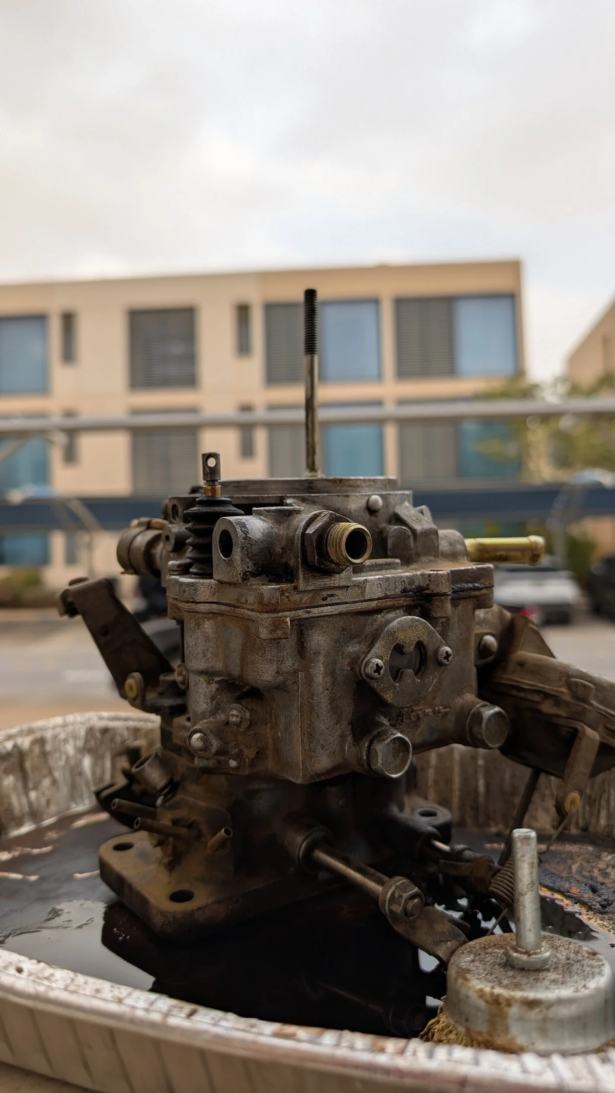

So i cleaned the carb up to prep for the rebuild since it was just covered in grim. (Parts on the way)
Now I have an over fuel issue I believe.
Coal rolling might be an appropriate term.
Have you tried leaving the carb in a bucket of some sort of cleaning agent? Or kerosene even?
The carb guru I asked to rebuild mine said he would only make a hybrid from a china made reproduction carb and install parts from my original in it.
He said the throttle shaft bushes can be difficult to remedy, and also the needle tipped mixture screw seating. I want to keep it all original so that option isn't for me...
I hope you can rebuild yours with the correct kit. Please let us know what you end up doing! (I likely will be doing the same soon!)

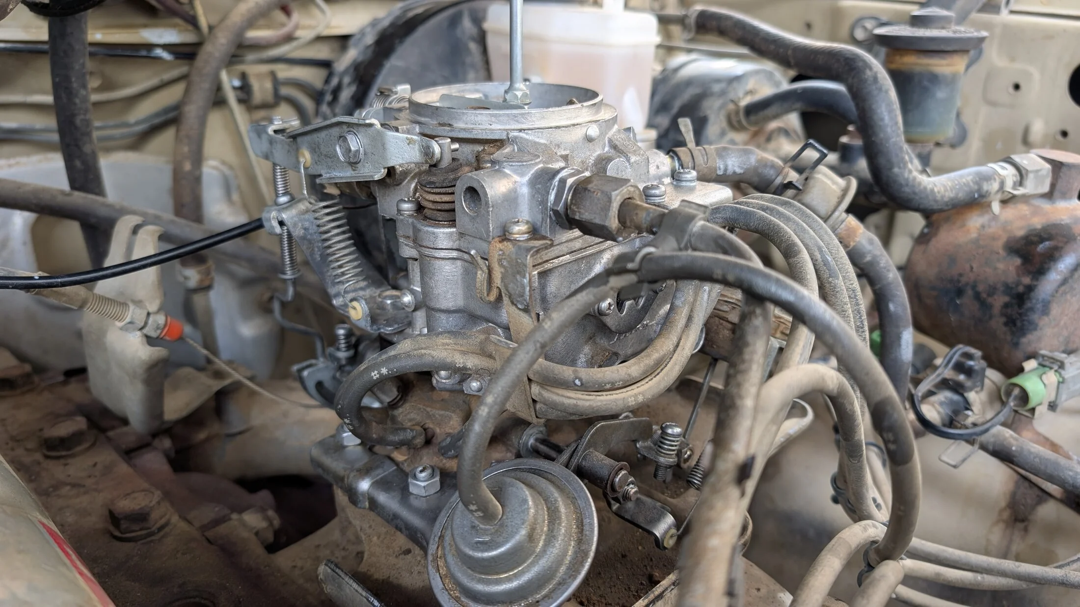

I ended up running most of the carb parts through an ultrasonic cleaner, and it made a huge difference in removing the built-up gunk.

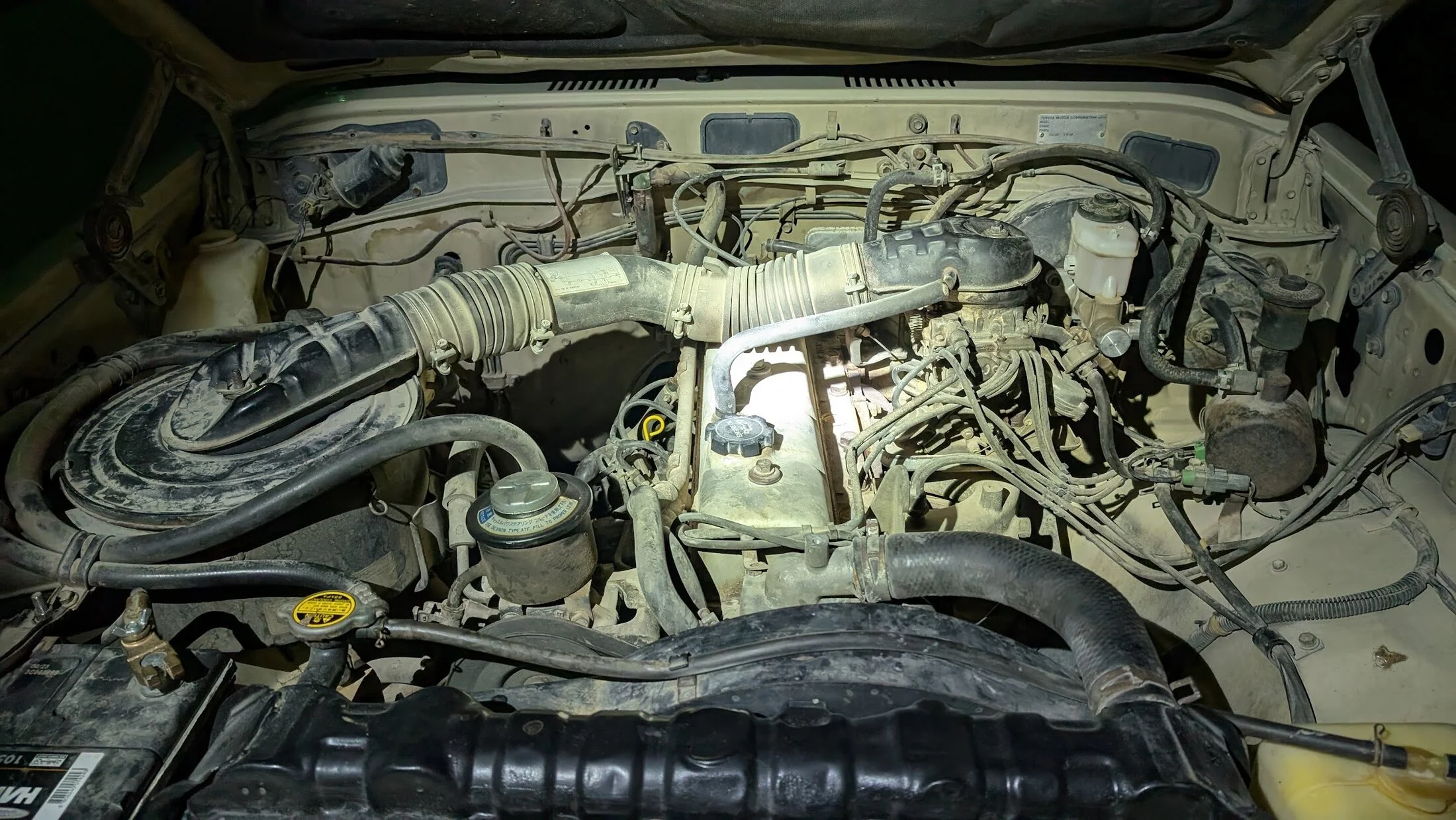

That said, I’ve noticed something interesting—the engine seems to be racing at idle, yet none of the idle adjustment screws are even touching. This leads me to assume I’ve got vacuum leaks throughout the system. After 35 years in the Saudi Arabian desert, rubber and plastic don’t exactly age well. I have a full set of vacuum tubing on the way to replace everything I can, along with rebuild kits for both the engine and carburetor, a new fuel pump, filter, and a few other essentials.

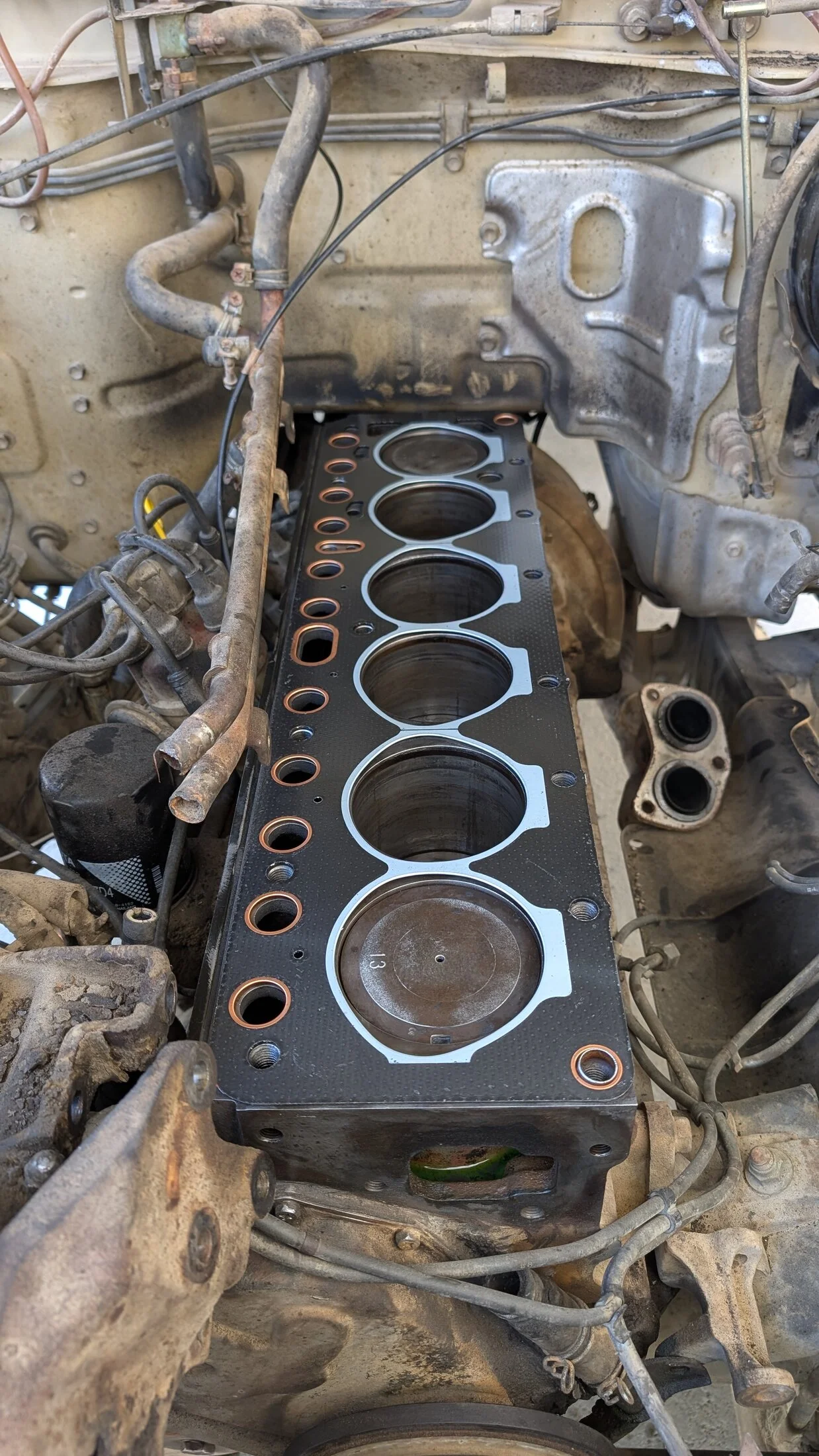

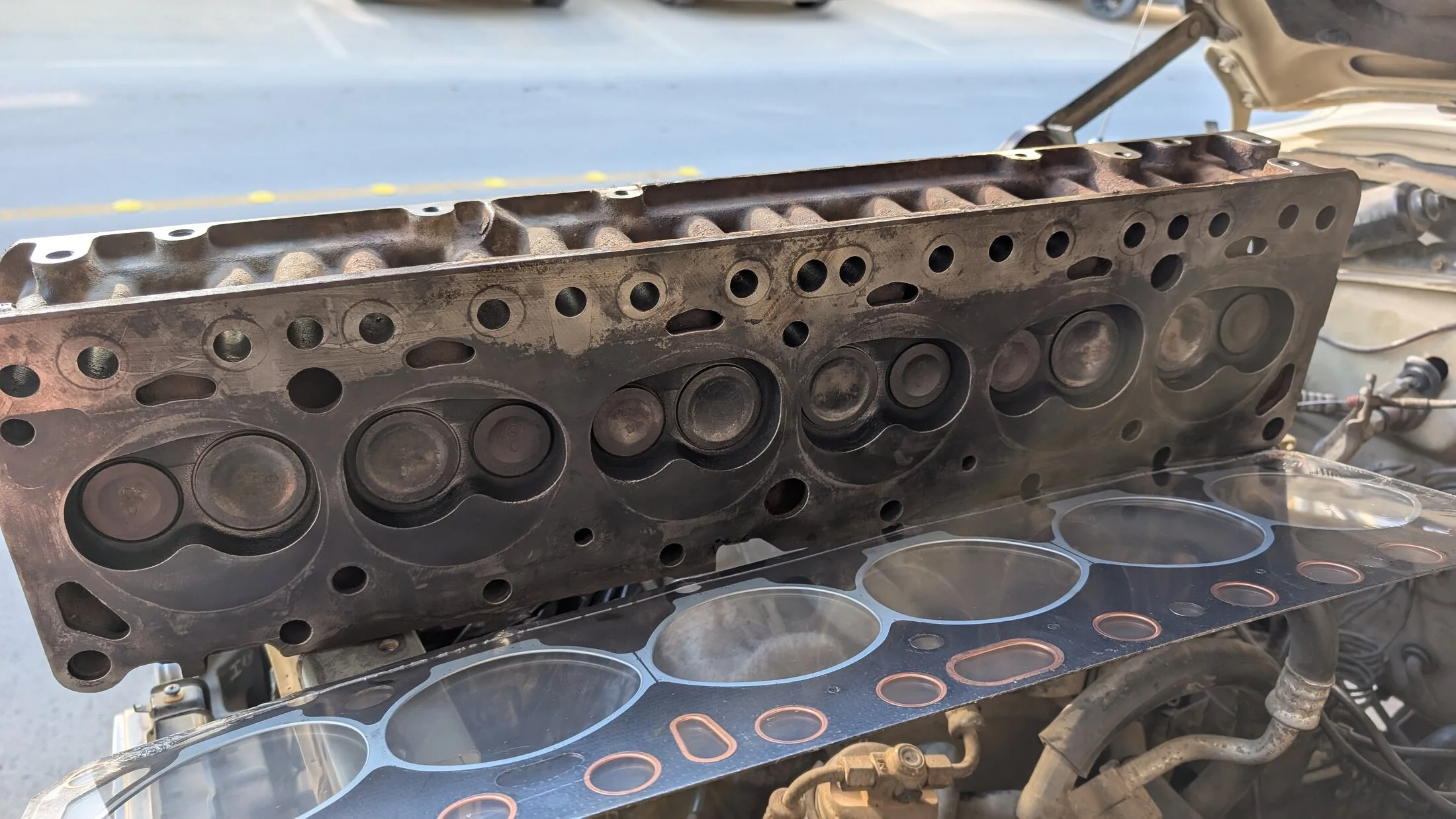

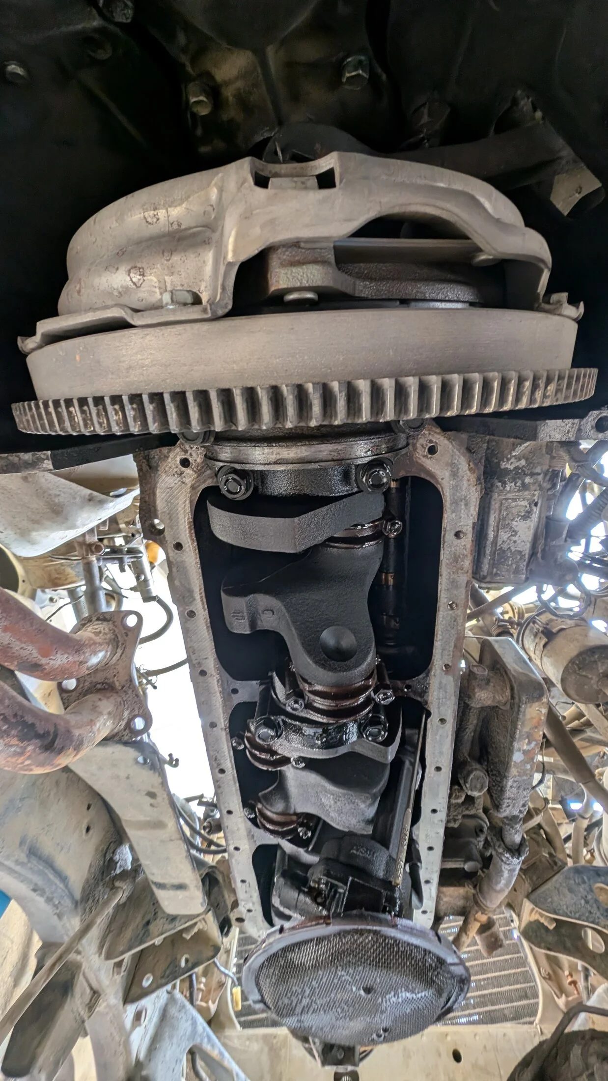

I'm very confused,

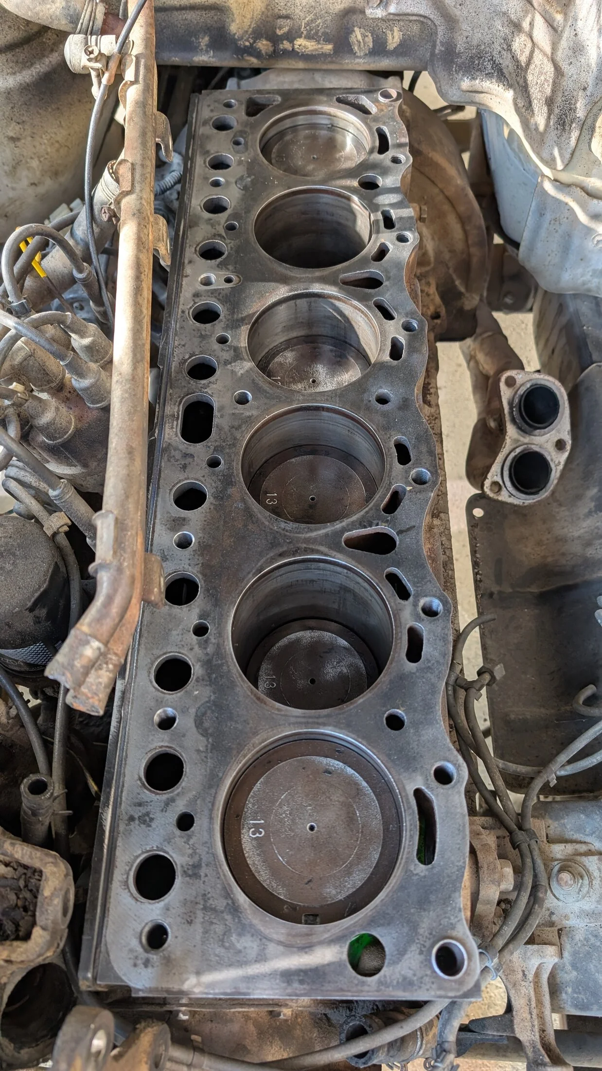

I pulled apart the engine to double-check, wear and tear and to replace gaskets.
After I look at my head and block. They don't match each other. And the gasket doesn't fit either properly. But it is exactly the same gasket that was already on the engine.
Did the previous owner replace the engine or head block??
I appreciate the help
Is that an OEM headgasket? When I did my headgasket on my 2f, aftermarket ones I bought did not fit well either. Some port holes were different. Go OEM. Also check casting mumber on head and block to see if they are compatible. Were you having any overheating issues?

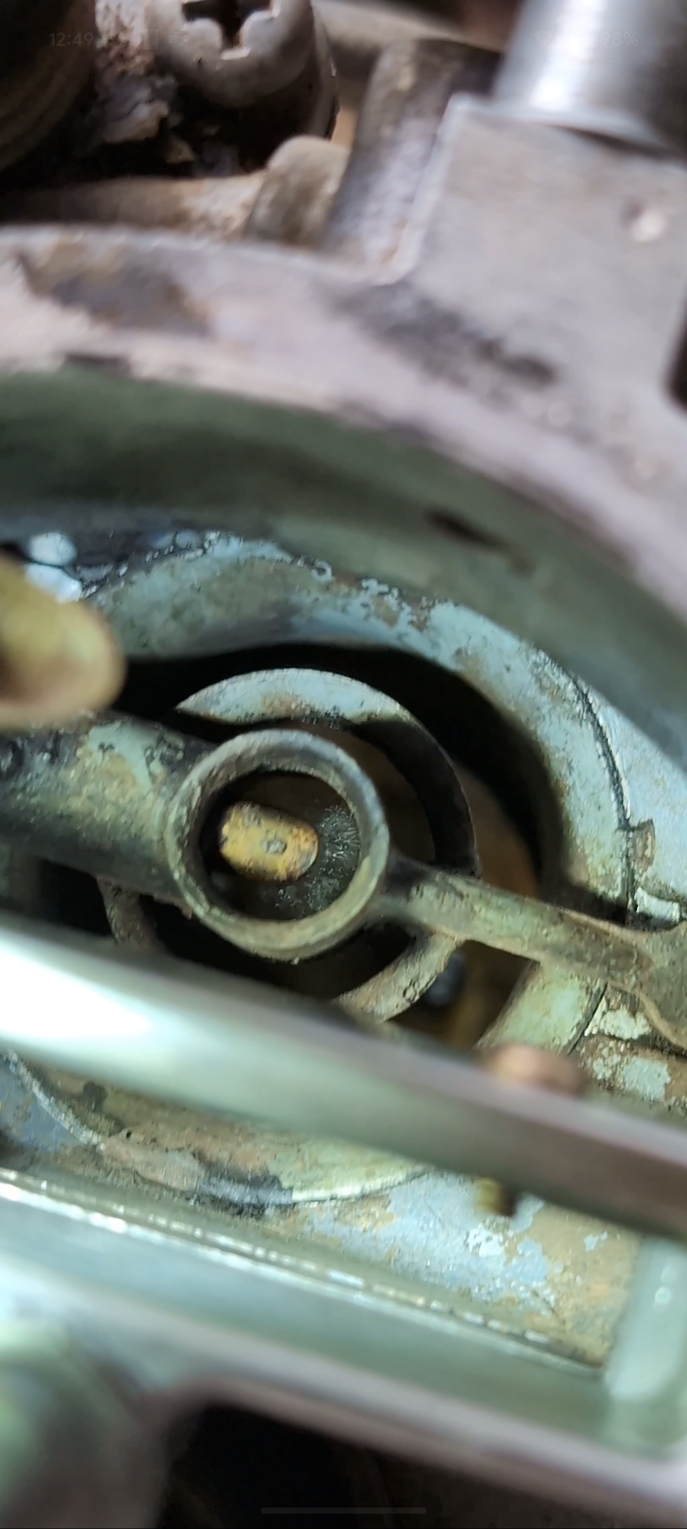

Alrighty then—found the overfueling issue. Turns out I might’ve reinstalled one of the butterfly valves in the carb upside down. Oops. After correcting that, the engine is now running pretty darn well, all things considered.
I’m still tuning the carb, but without many of the proper tools—I'm doing all this in a parking spot outside company-shared housing, so it’s very much a DIY situation.

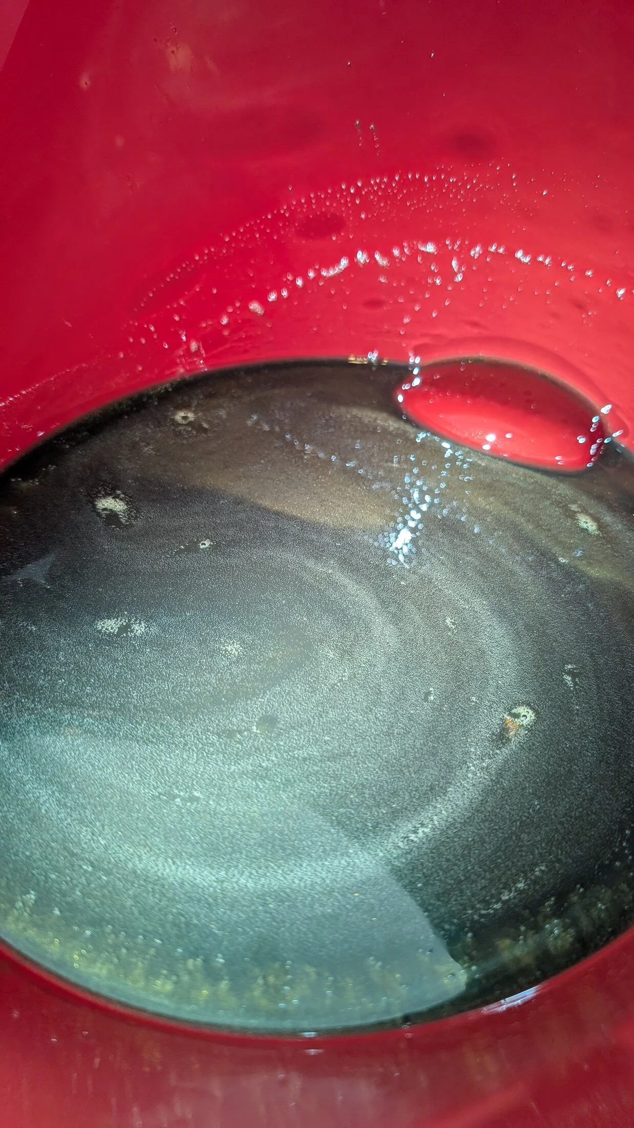

The cooling system has also been mostly rebuilt. Judging by the look (and smell) of what drained out, I’m pretty sure it was just tap water in there for years. The rust was palpable.

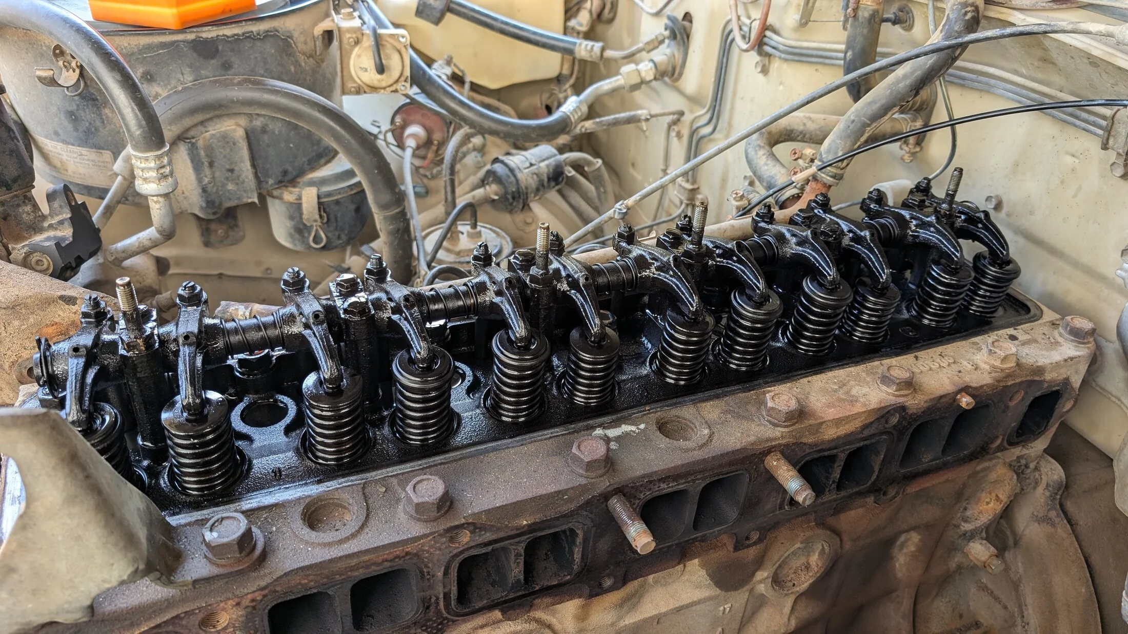

That said, the engine now has a noticeable ticking noise. The valves have been adjusted, and it doesn’t sound like a knock. The ticking seems to be coming from the back of the engine or possibly further down the drivetrain. I’m currently on vacation and will dig into it more once I’m back, but if anyone has ideas in the meantime, I’m all ears.

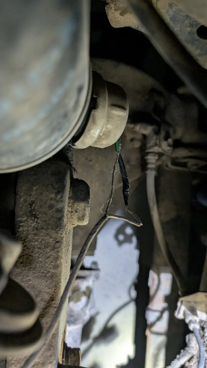

On a separate note, I’m trying to track down a missing sensor—part number 89428-60050. No luck finding a replacement so far, new or used. If anyone knows of a compatible alternative or where I might score one, I’d appreciate the lead.
One lingering mystery: there's a green and white wire with a burnt tip that appears to be part of the bundle going to that missing sensor. Any idea what that’s supposed to connect to?
Lastly, I’m getting no coolant temp readings on the dash. I’m assuming it’s related to the missing sensor or that burnt wire—but has anyone dealt with this specific issue before?
