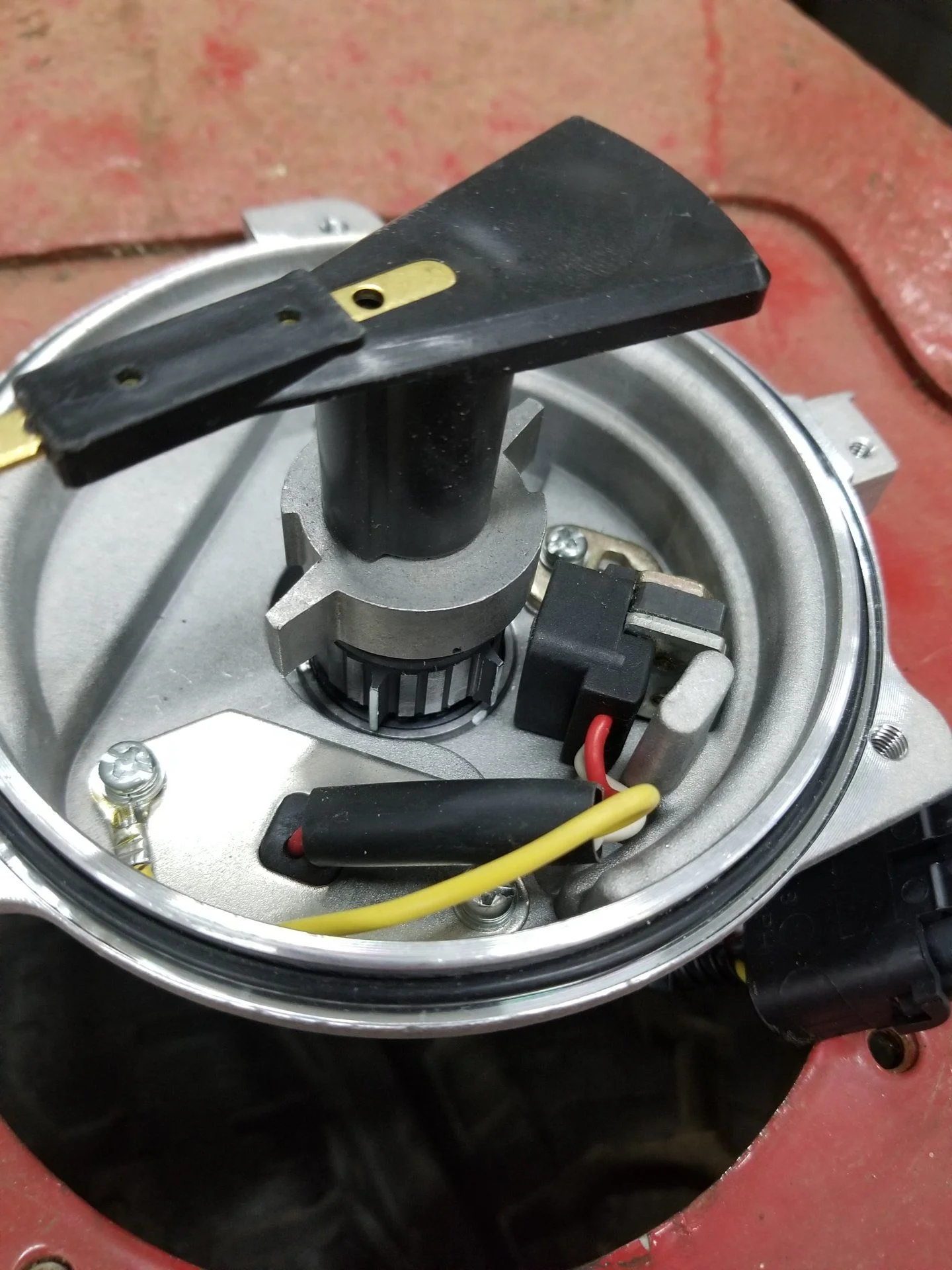

Not much to go wrong with the 3fe dist supplied by AFI. Glad I did not go with the DUI hei dist.
Ive just heard a lot of people having problems with the chinese dui distributors as far as the bushings in the shaft wearing out. Is that what AFI supplies or is it a aftermarket dui? The factory toyota japanese distributors seem to never have any problems. I use the fj60 distributor for timing control. Its not as well packaged as a aftermarket dui but does the same thing. The programming is the same.
AFI uses a 3F-E distributor and mills of all but 6 of the 'teeth' on the reluctor ring. This provides the trigger for the coil and the EFI and presumably also serves as a crankshaft position sensor. Needless to say, the 3F-E dist. drops right into the Toyota engine.
