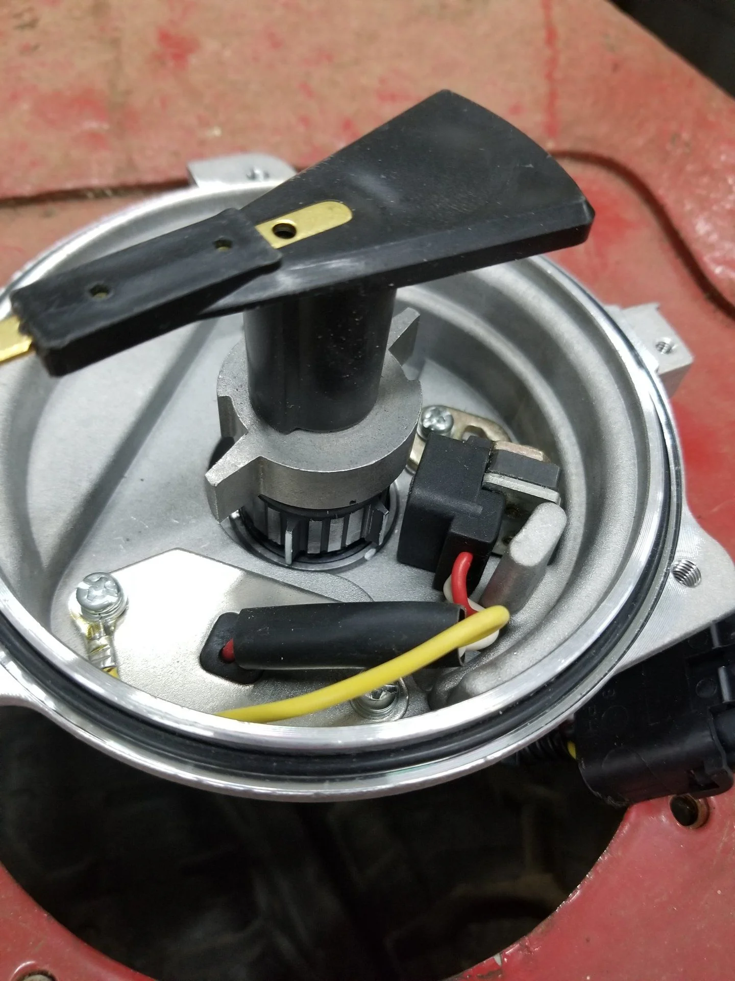

I will be using the AFI stuff on my conversion. I went with the 3fe dist. Why do you recommend the 60 dist over the rest?
I don't know what the difference is between the fj60 distributor vs the 62. I imagine either would be better quality than the one in the kit. I imagine fj62 distributors are harder to source.
@White Stripe do you use the 60 dist for timing control or do you program it in the chip?
Not much to go wrong with the 3fe dist supplied by AFI. Glad I did not go with the DUI hei dist.
