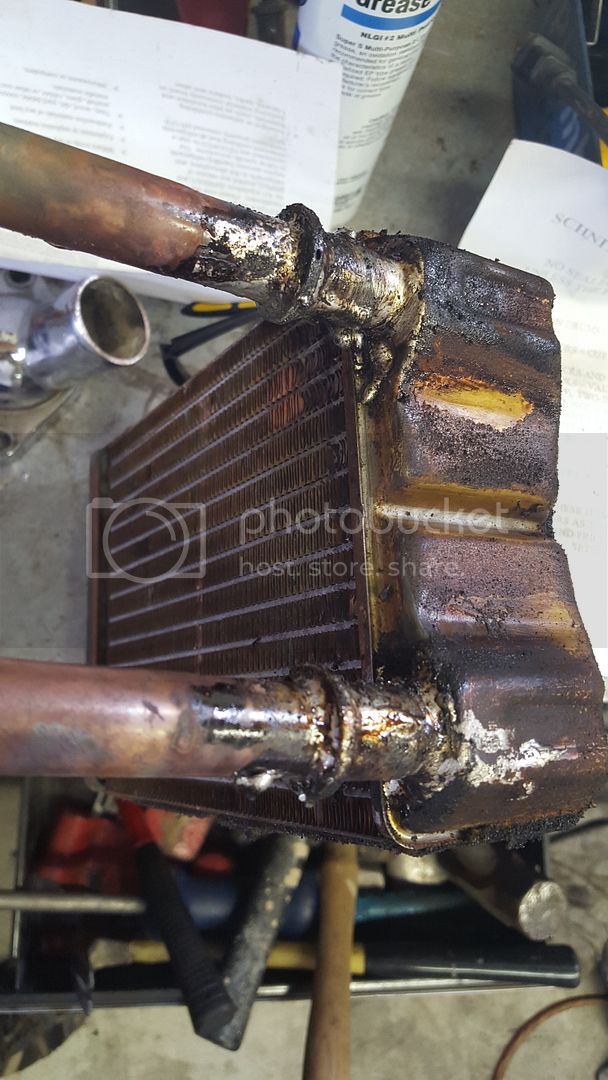

Bought my 60 with the dash torn apart, discovered the heater core was fine but the o-rings were leaking and it is a piss poor design with a hard to get to joint inside the cab. I was contemplating taking it to a radiator shop but then I figured any idiot can melt solder. I smeared flux all over the joint and then took my cutting torch on low heat and melted a bunch of solder into it. Don't overheat it because it will pop the tank solder joints. Pressure tested it with a garden hose on low, no leaks. Took all of 5 minutes to do. It will absolutely roast the heck out of the occupants in the cab and it heats up as fast or faster than my wife's 2015 4runner. Dash disassembly isn't hard, just tedious. On the bright side you won't get greasy and you only need like 3 tools to do it. When you reinstall it you may have to slightly bend the pipes to get them back in just right BUT since it is now soldered together it won't leak when you tweak on them! WIN WIN! Oh yeah, it'll probably melt the foam surrounding the core so you'll probably want to get some new stuff. That's what the black goo is on top of the heater core.

Well that's interesting... Heater lines not necessary..
$50 well spent

I have what I have been told are the last set of new heater tubes for FJ60 in the world. Bought from CruiserDan about 6-8 years ago. Not bragging, just saying it's a job I need to do. I really like the idea of soldering them to the core.

are the modified tubes long enough to clear the firewall?
They are not really modified.. and I'm concerned about that as well. Time will tell...
