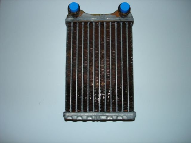

No, they don't. It is not the correct heater core.
what makes it wrong? I see its out of stock right now...
I can't "see" any difference but the part numbers are the same from the two different web sites and the pics look identical...even with the one side tube that looks deformed.
Guess I'll find out and see what happens on my 86
Go ahead. This is what I got from two different places.
Go ahead. This is what I got from two different places.View attachment 1207276

The left one is the stock one. The right one is the one Rock auto sent me.
You get yours a while ago?
yes my "new" core has been sitting on the shelf for a while... here is what I have...the blue things are just plastic plugs that came with it...and I
I stuck my o rings on there so I could keep up with them. These pics are showing the one I received from rock auto a few months ago. Their web site shows out of stock...but the pn listed there is the same from the oriely web site. Most likely someone is just stamping their brand name on some part sold wholesale.
Yes, the old rock auto one is correct

Orilies auto is where I just got mine. It fit very well.
the next option was to have a heater core made. But that was going to put me out of pocket like $300. THe one I got was about $50. It's brass and seems to be (at least superficially) the same general quality as the one I removed.
