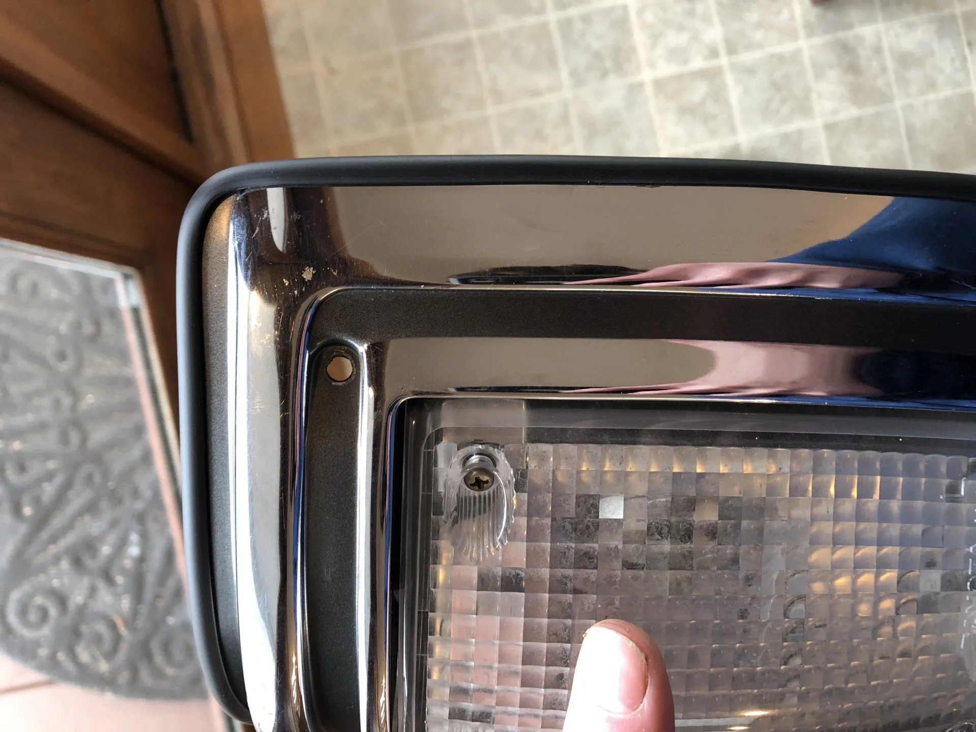

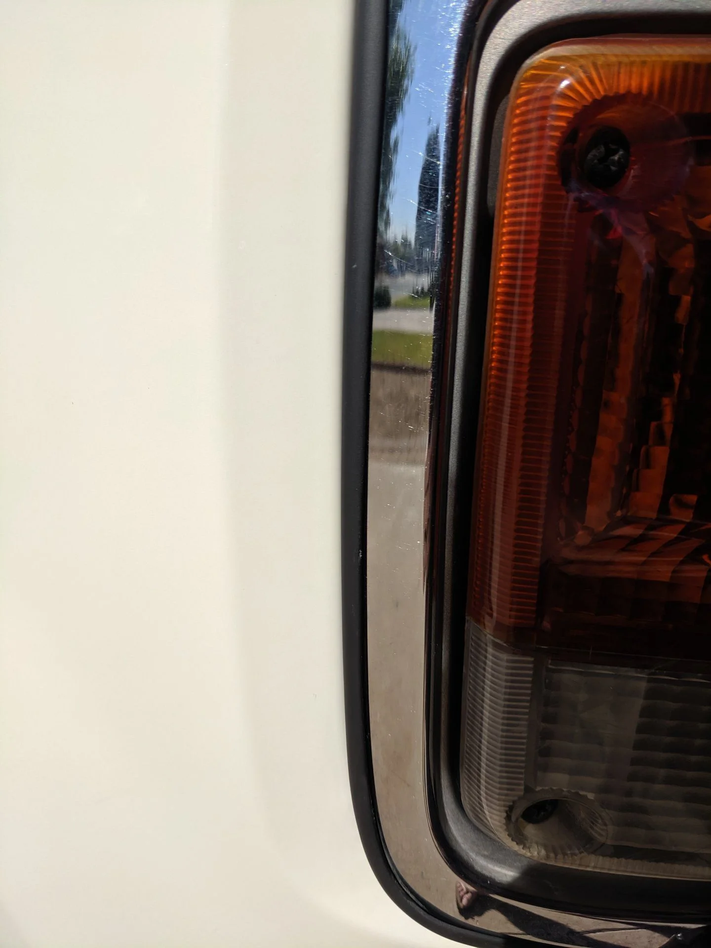

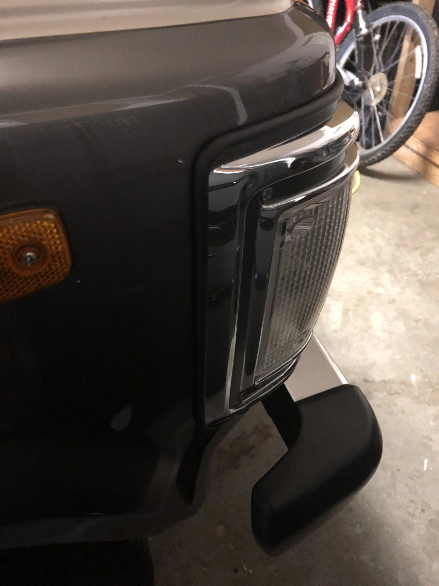

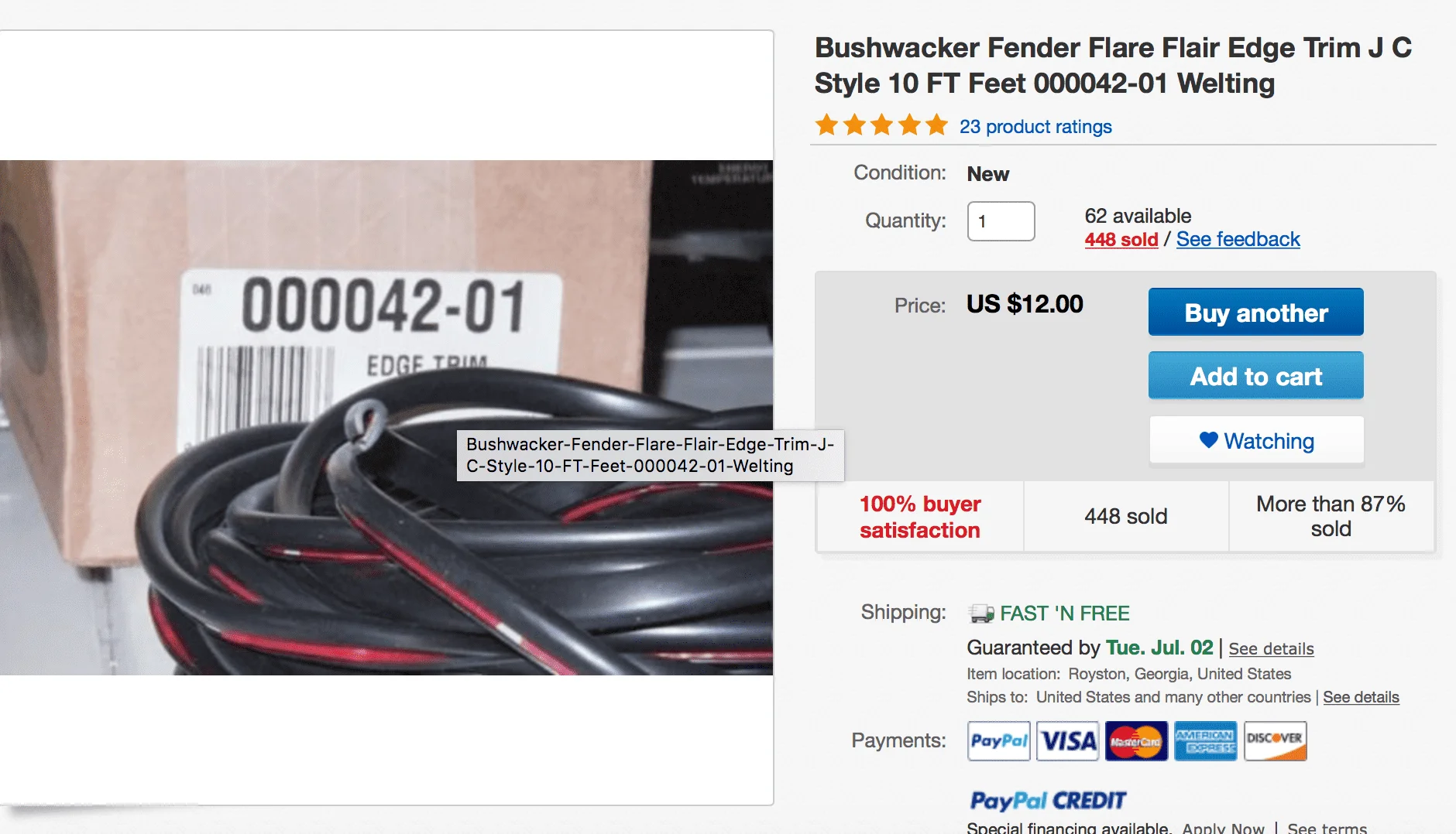

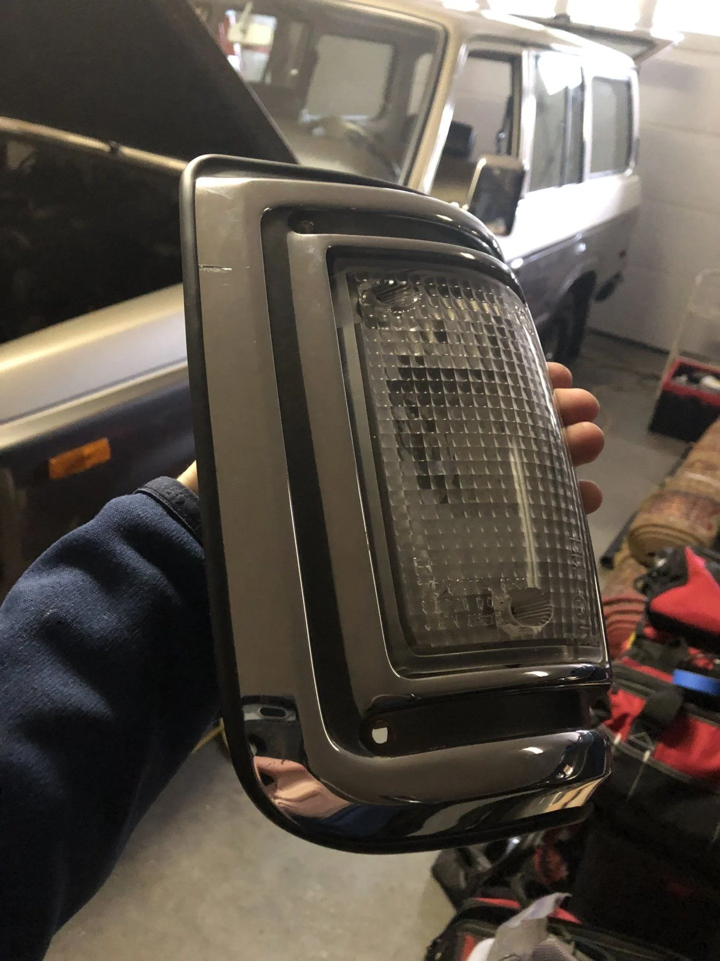

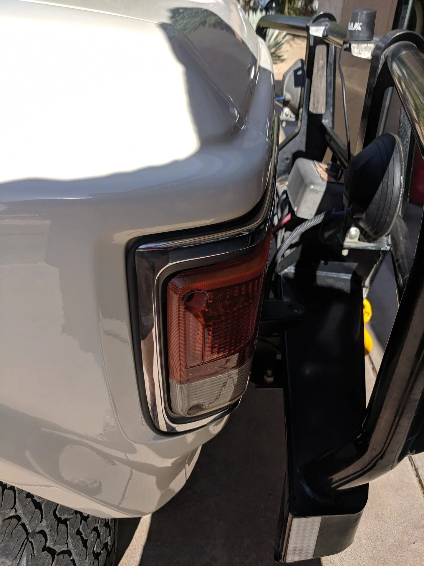

About a year back I was in need of a headlight Bezel Gasket for my Fj62 as the old one was cracked and half of it was missing. Toyota does not make a replacement whatsoever, neither do any popular cruiser parts suppliers. A solution and suggestion I used by other people was to use Bushwacker Fender Flare "C" style Trim. I ordered mine off of eBay and it worked great (see pictures). IMO it looks much better than the OEM gaskets and seals better too. Hope this helps someone if looking for this part.

How many feet does it take to do the job says it 10ft of it..
I wondered the same thing but figured I could measure. There are other packages of different amounts avail as well.

Good part match for this gasket. I installed some today on the 60. Thanks for sharing this.
Just found this as mine is all dry, cracked and one is hanging out. I am wondering how far around you went on the top and bottom with this gasket? Looks great. Ordering today. Got a full pic of the light with it installed? Thanks for posting.
