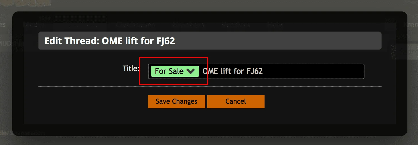

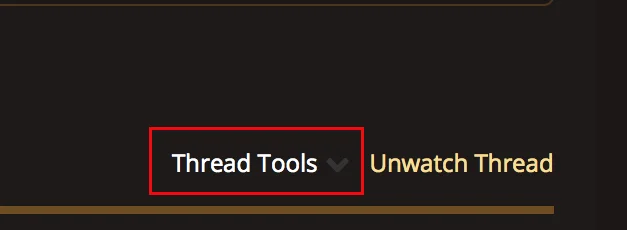

P.S. how do I put the "BUILD" filter by the name? Thanks!!

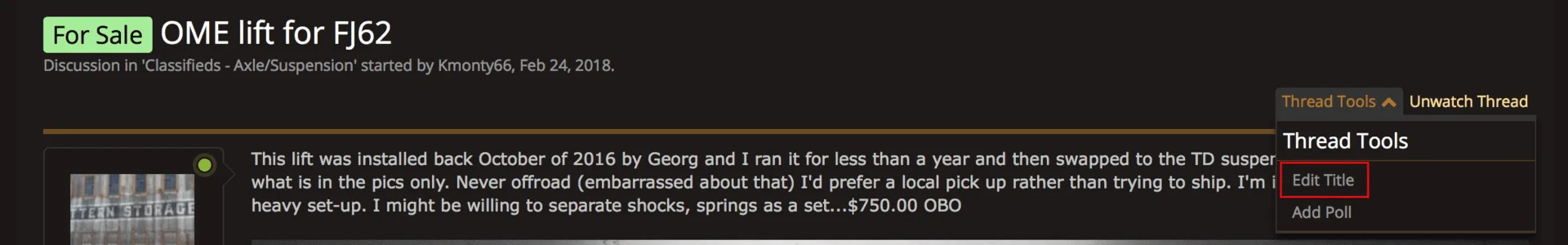

Thread Tools. Right hand side top. Click on the arrow select edit title. Then edit title. I obviously did this on a for sale thread but I ASSUME it would be pretty close....

Thank for the tip!! Just tried it but it didn't have any of those options. Oh well no biggie ill leave it as is for now. Ill try it again maybe on my phone...

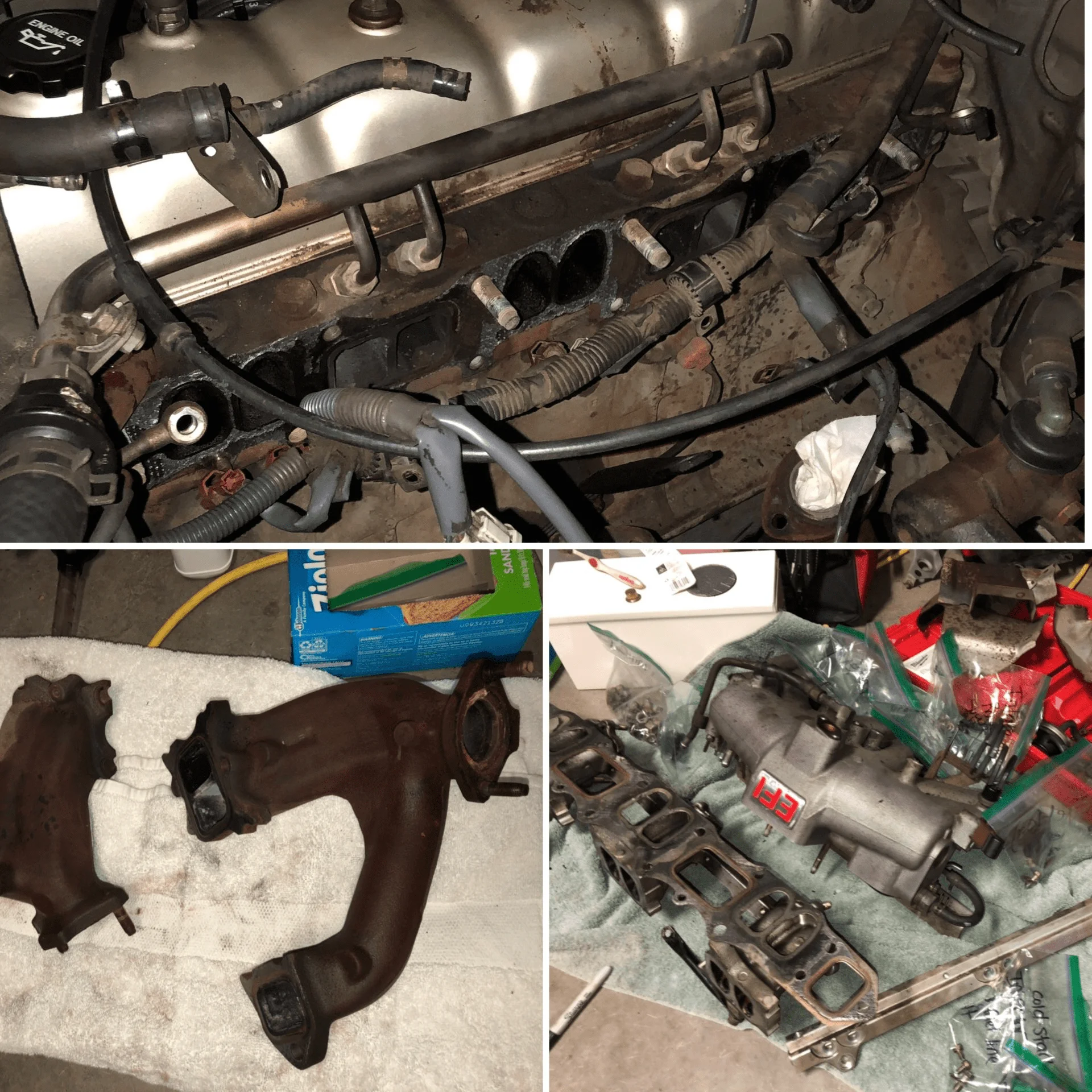

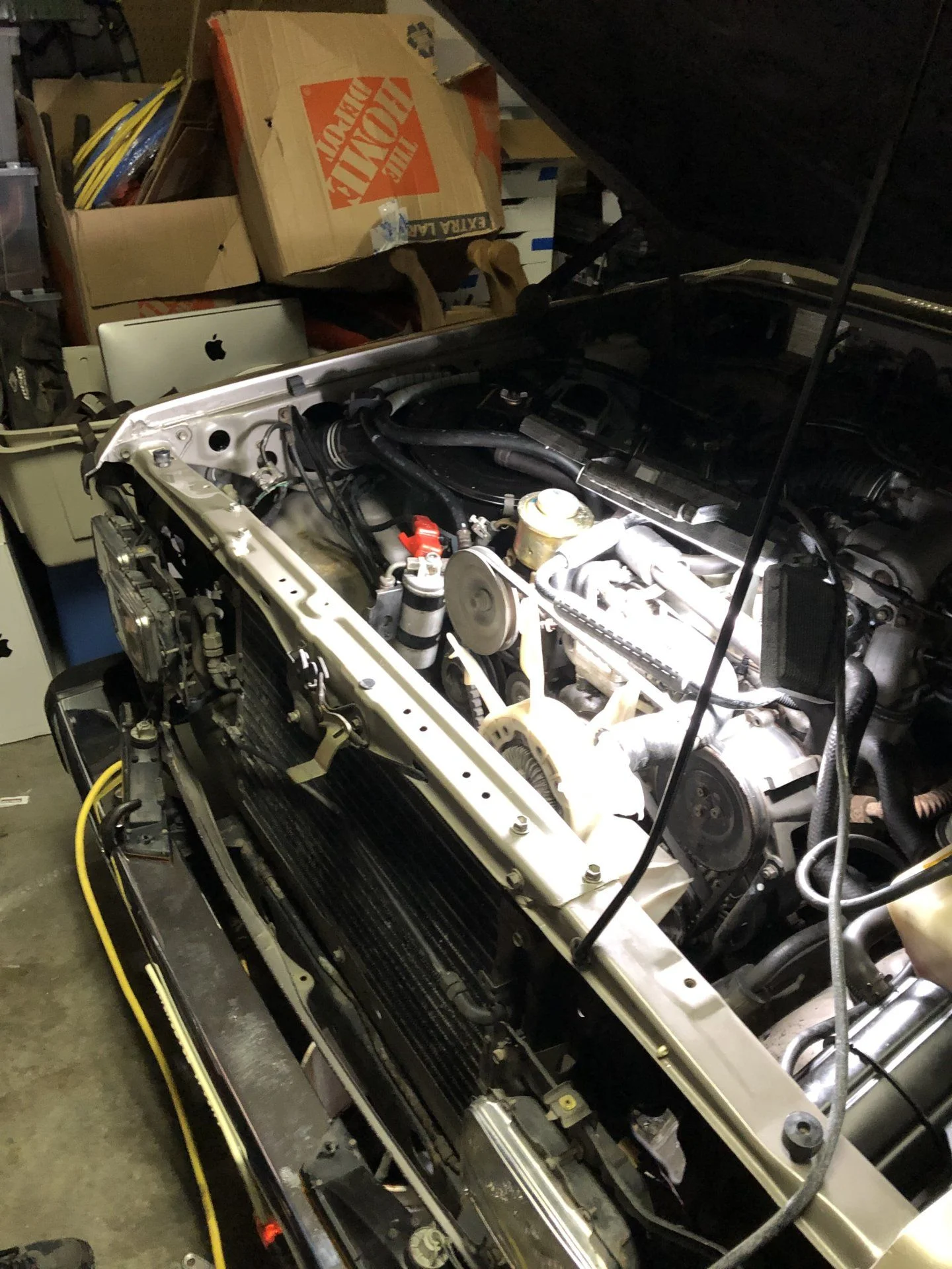

Well, yesterday I started to disassemble the right side of the engine bay to get to my leaking exhaust manifold gasket. I was a little over my head at first because that's the first time I've ever done anything like that. I was sweating bullets taking out the fuel rail and injectors today, but it went good I think. Made some new gaskets for where the Upper intake manifold meets the lower intake manifold, and have a rem flex gasket for the main manifolds. Hope to get it all done this week. Have my radiator coming back from repair this week and am going to send my injectors off for cleaning at witch hunter performance here in Bothell WA. Ive heard this is a good thing to do... Link to thread: FJ62: 3FE Exhaust Manifold Leak Advice
1990141
**Manifold and Injectors done at 98,800 miles**

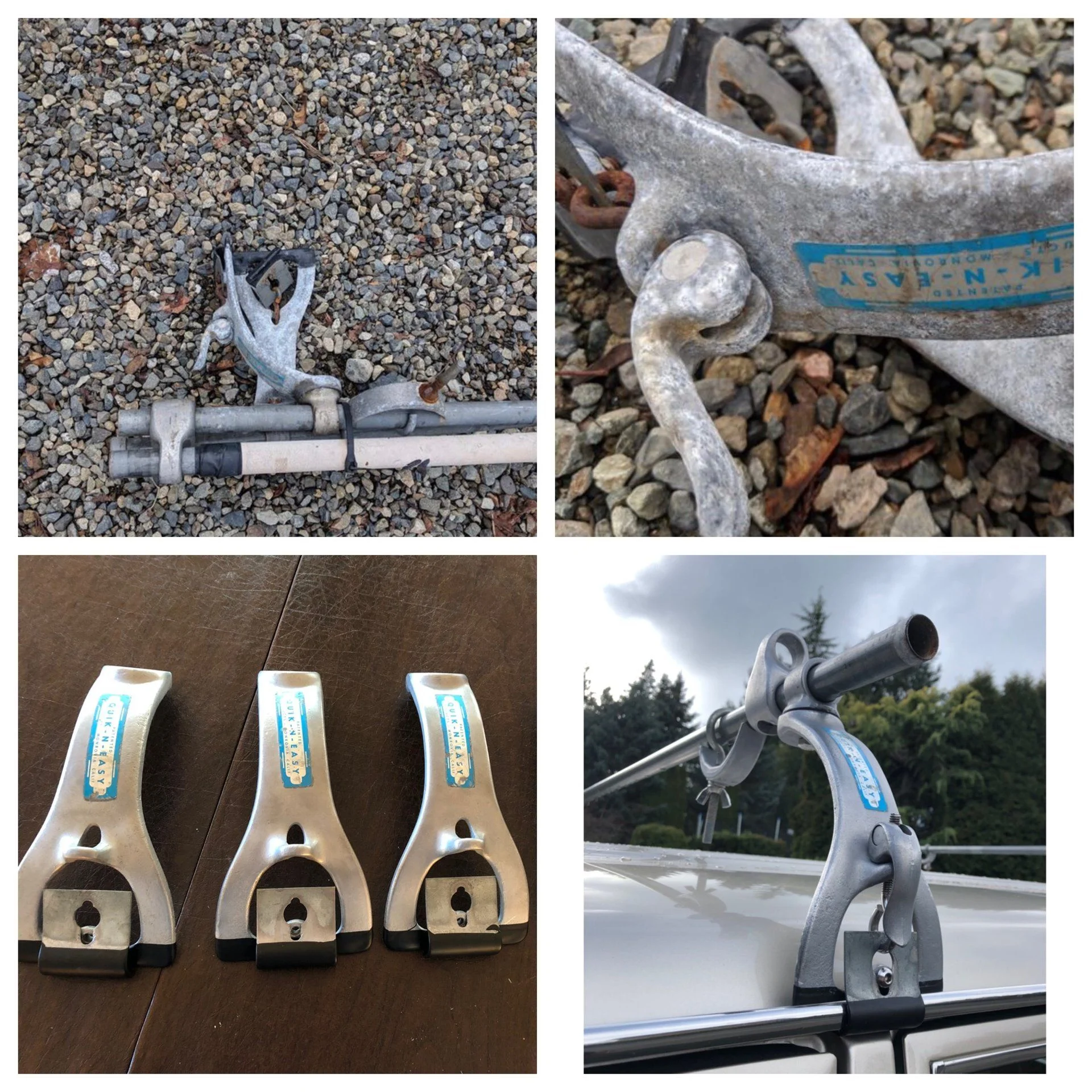

I've been trying to find a roof rack for a while now for the 62 and stumbled across this old rack on offer-up for 20$. Turned out it was a super nice Quick-n-Easy cast Aluminum Rack. It was in terrible shape, so after bead blasting, light polish, and re-dipping the black rubber on the bottom, they look better than new. Most of the original hardware was so rusted they broke off in the aluminum, so I had to heat, and use penetrating oil to get them out. Overall wasn't expecting to put bars on the 62 but they look so good and era correct. All new stainless hardware too so no rust I hope.

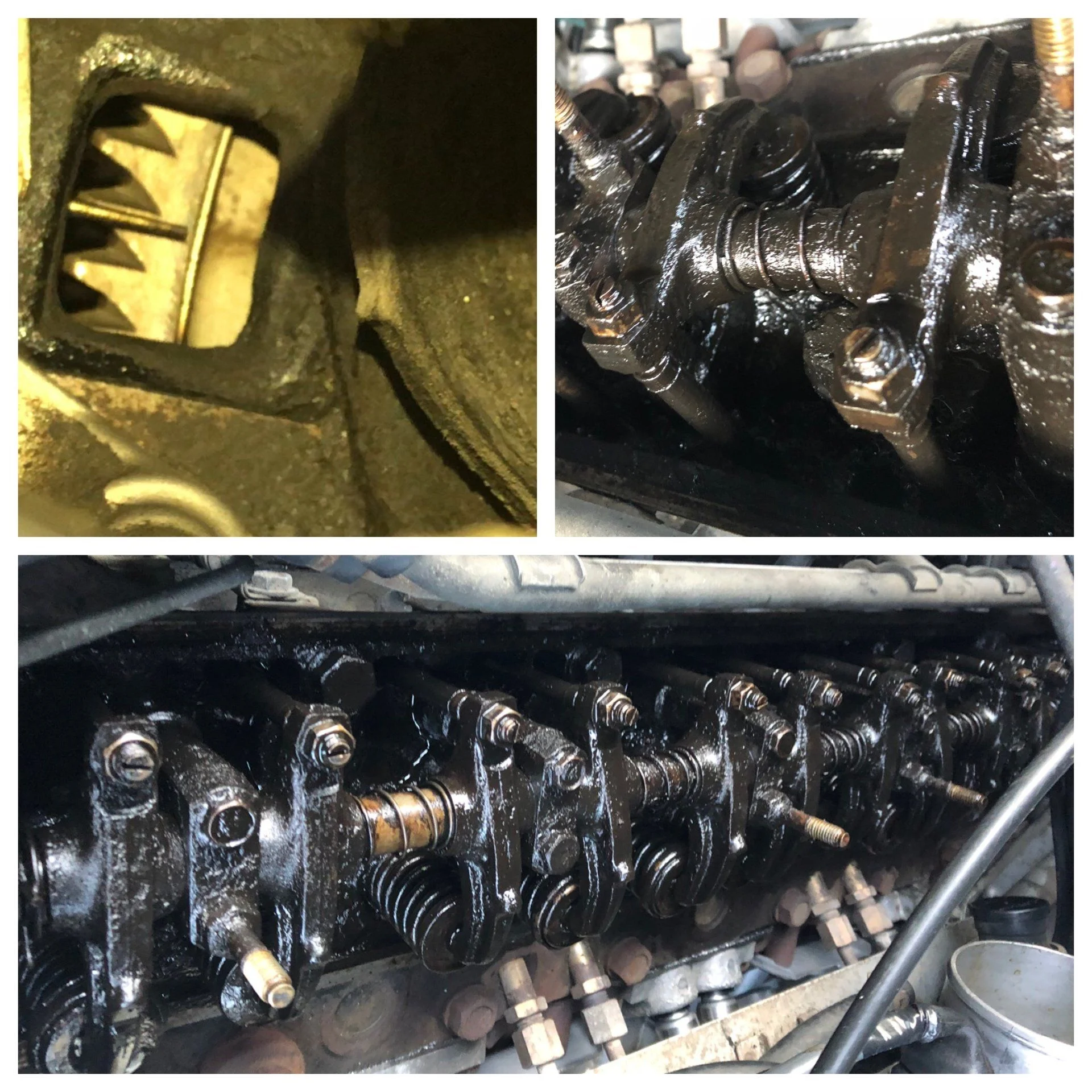

Did my first valve adjustment about a month back. Wasn't very tough, just a race against the clock and was a two-man job in my opinion. I ended up having my mom use the camera on my iPhone to find TDC, while I turned the crankshaft pulley with a 46mm wrench. I ended up having a ton of valve gunk on the valves, so I spent a couple hours chipping and cleaning it off. It doesn't surprise me though that they were so dirty. I think the cruiser had been neglected so I'm just catching up on maintenance.
After the adjustment, it still sounds like a sewing machine or a loud printer: Hopefully, its printing me more money so I can keep affording gas ha! The valves nearest to the cab were the loosest so I think that's where all the noise from the valves was coming from.
1990171
**Valves done around 99,500 miles**

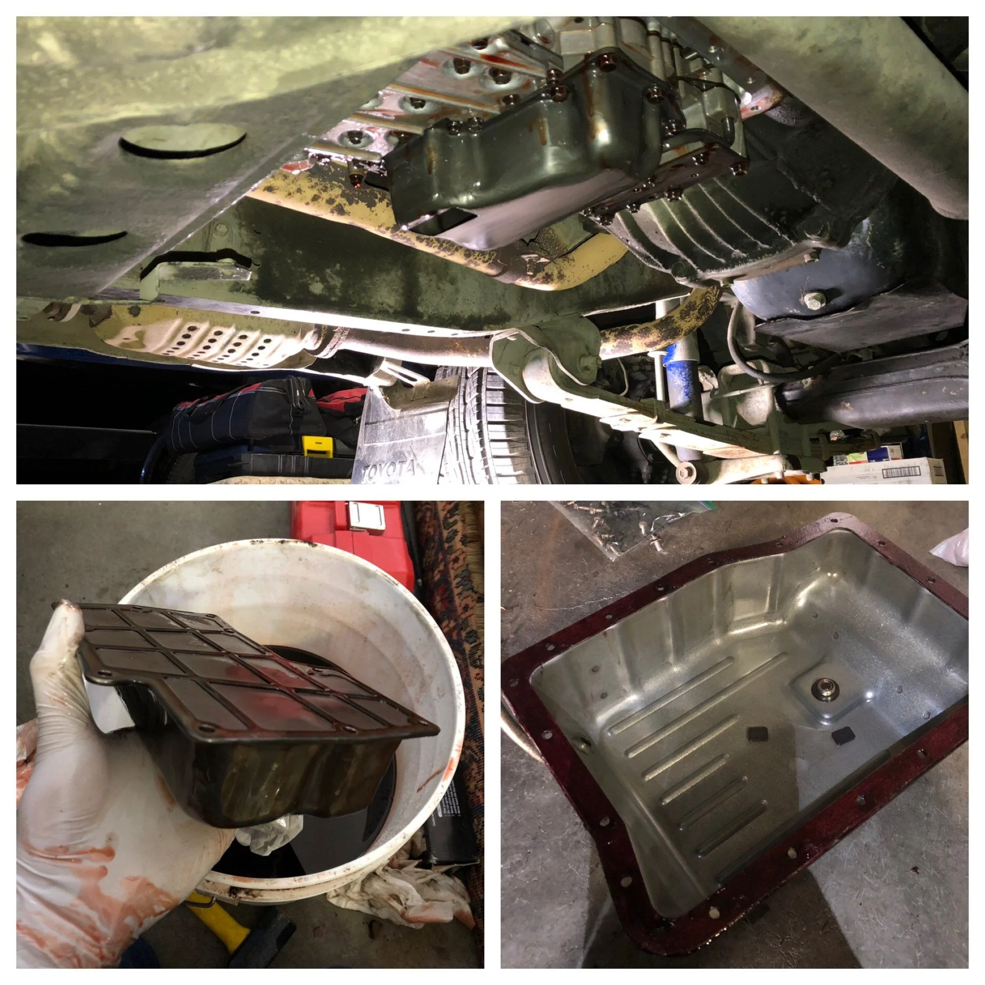

Catching up on this thread a bit but I changed out the tranny pan gasket after I bought the truck. Really the worst part was getting the tranny fluid all over everything lol. I bought a new OEM cork gasket and after a recommendation from a buddy to coat it with red gasket sealer I did so and I haven't had any leakage. He said if you don't the cork gaskets can leak? Not sure but it hasn't leaked. I never changed out the filter gasket (I didn't even realize there was one), the filter was a lot beefier than I predicted and I just sprayed out the gunk with carb cleaner and reinstalled.
