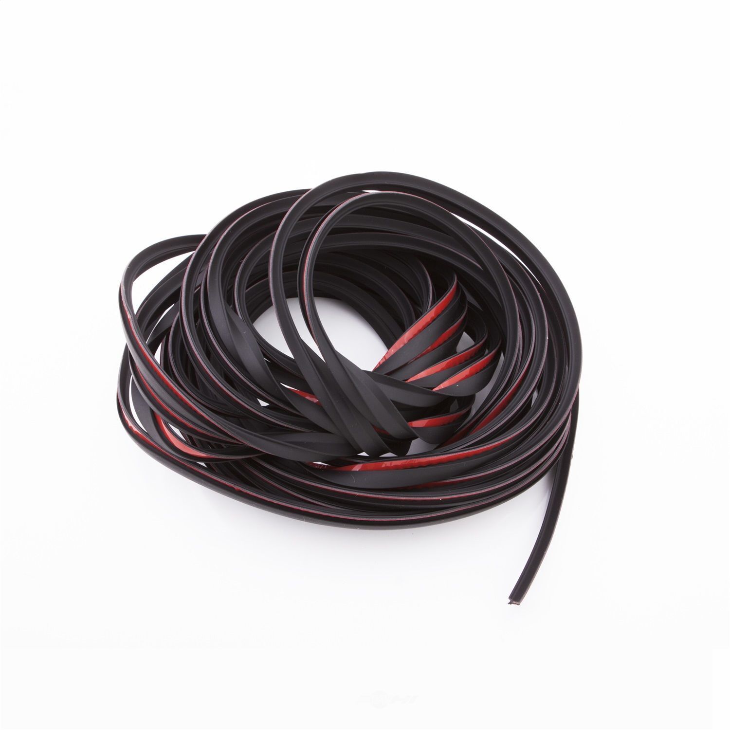

This is great! Now, what about the gasket behind the turn signal and the headlight bezel...(FJ60)...?

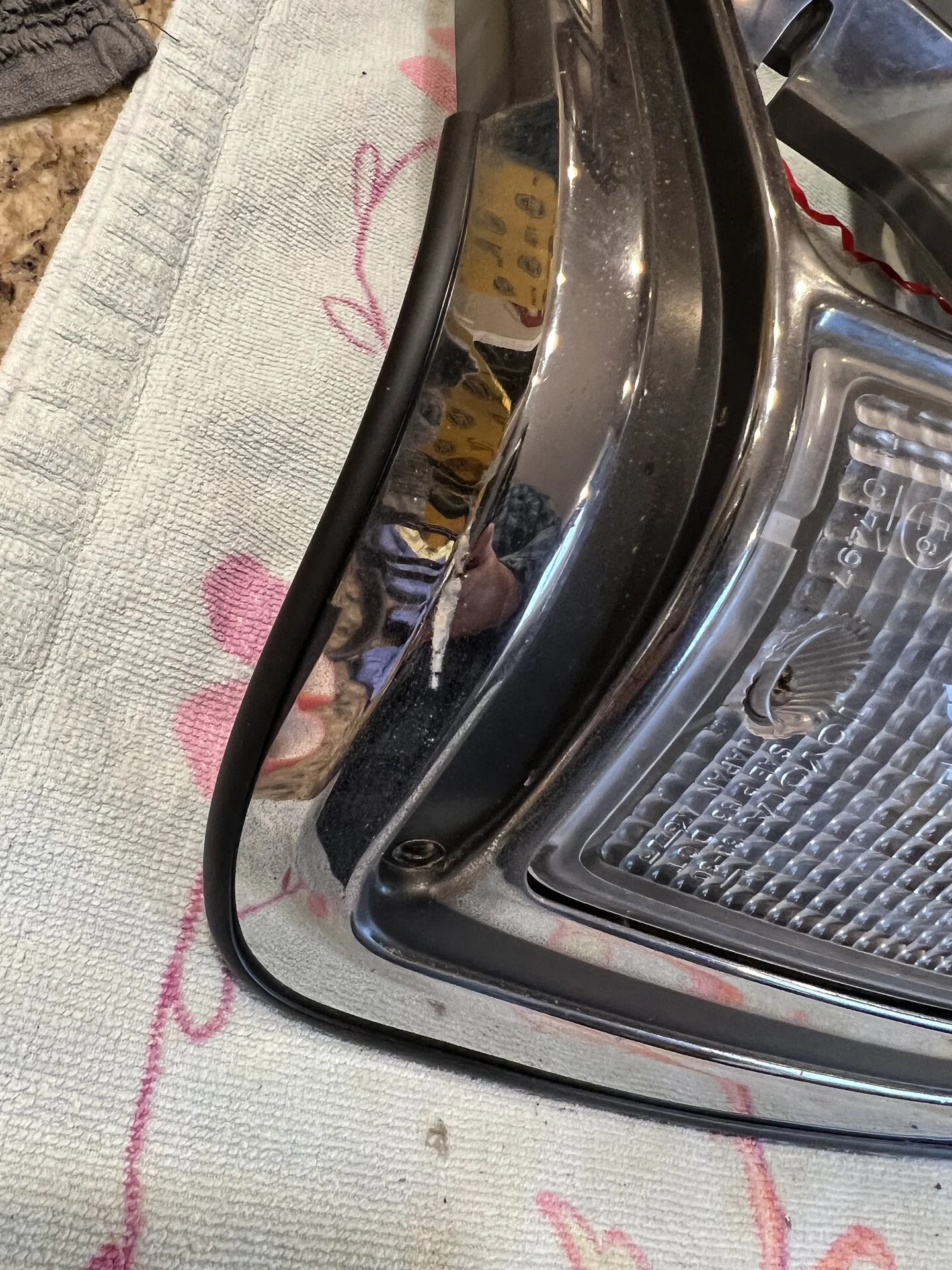

It has a adhesive strip on it, with removable tape.I just purchased this for my headlights. Do I glue them on (what do you recommend for glue) or just slap them on? Thanks!

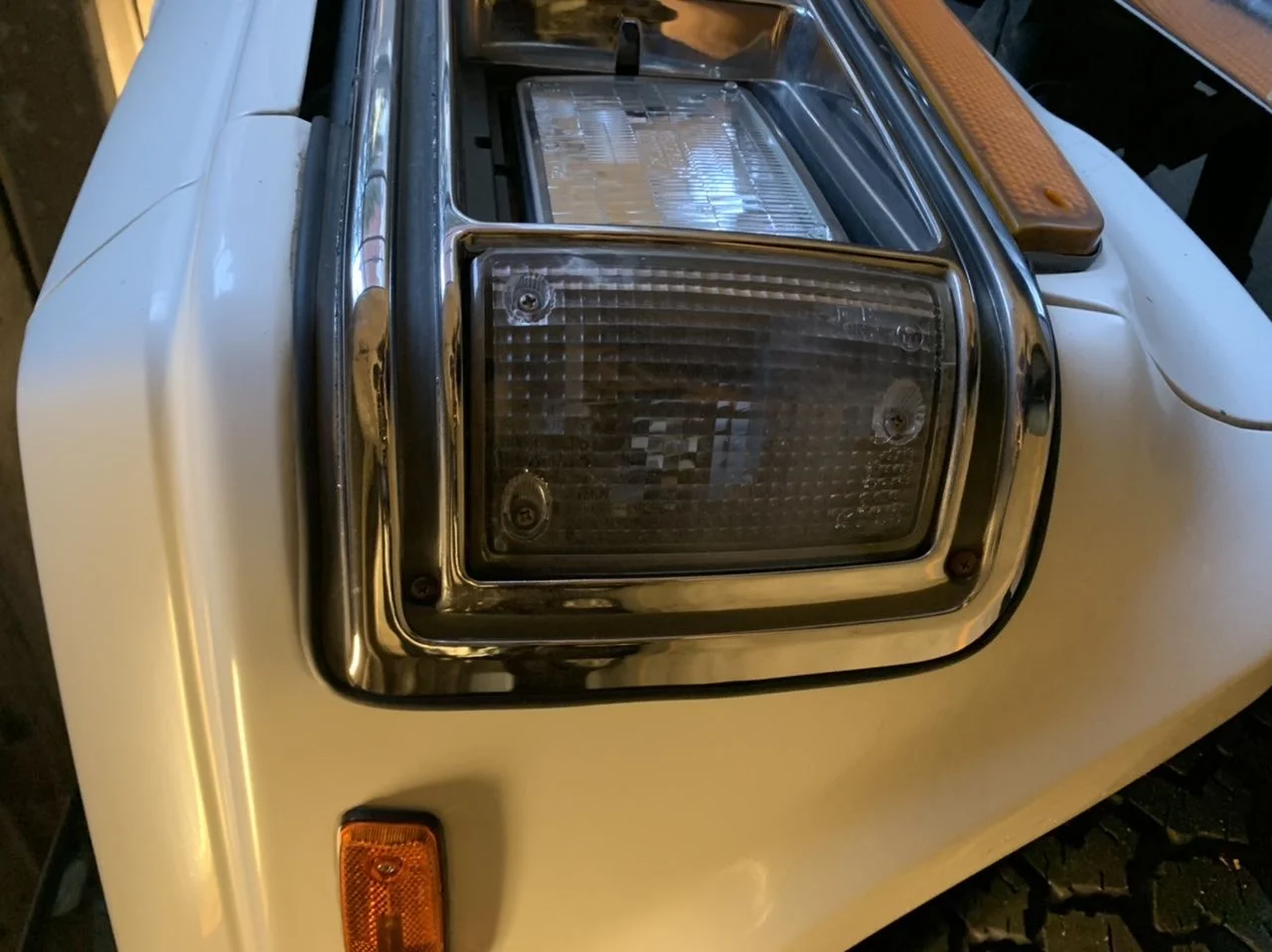

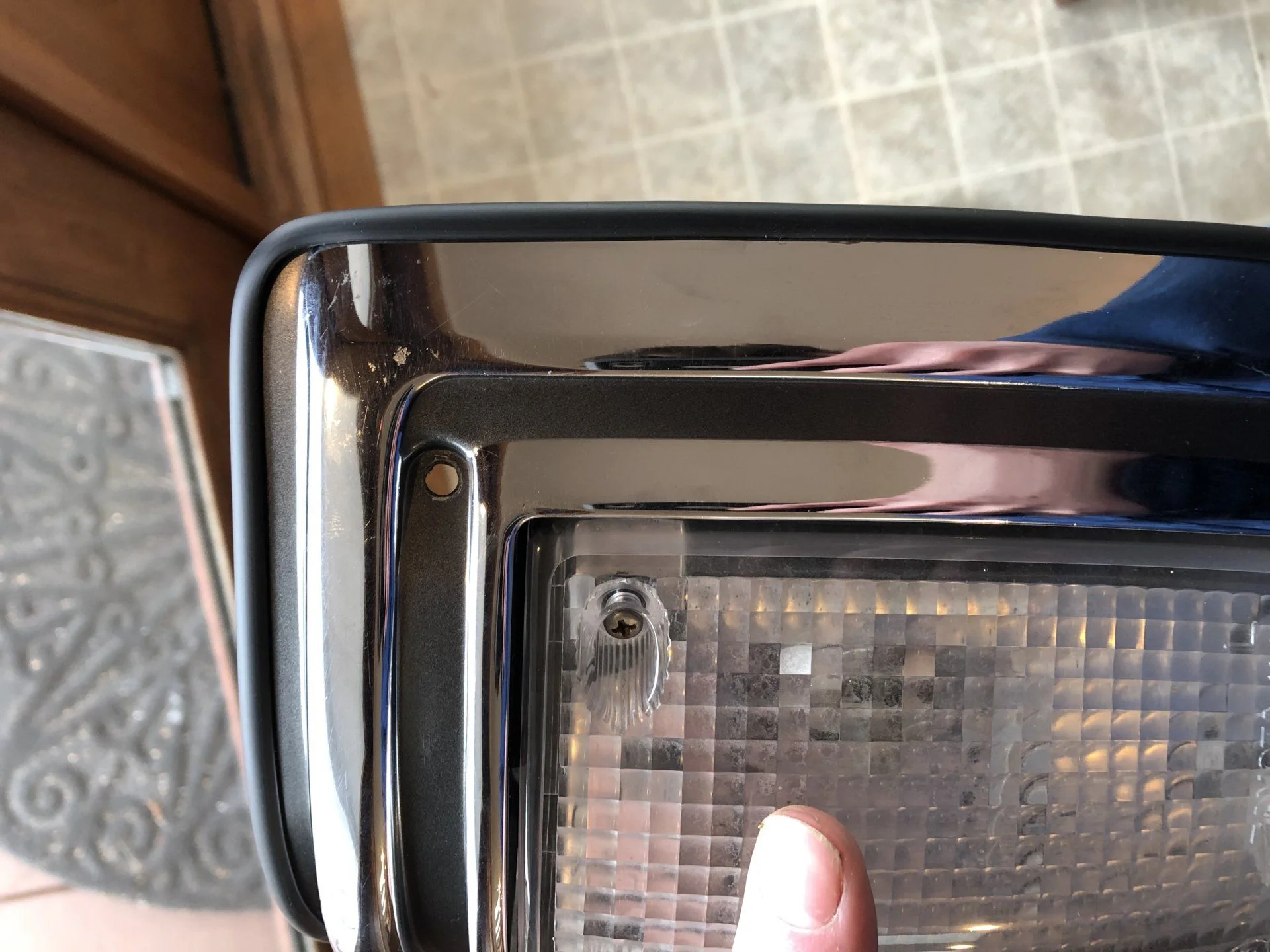

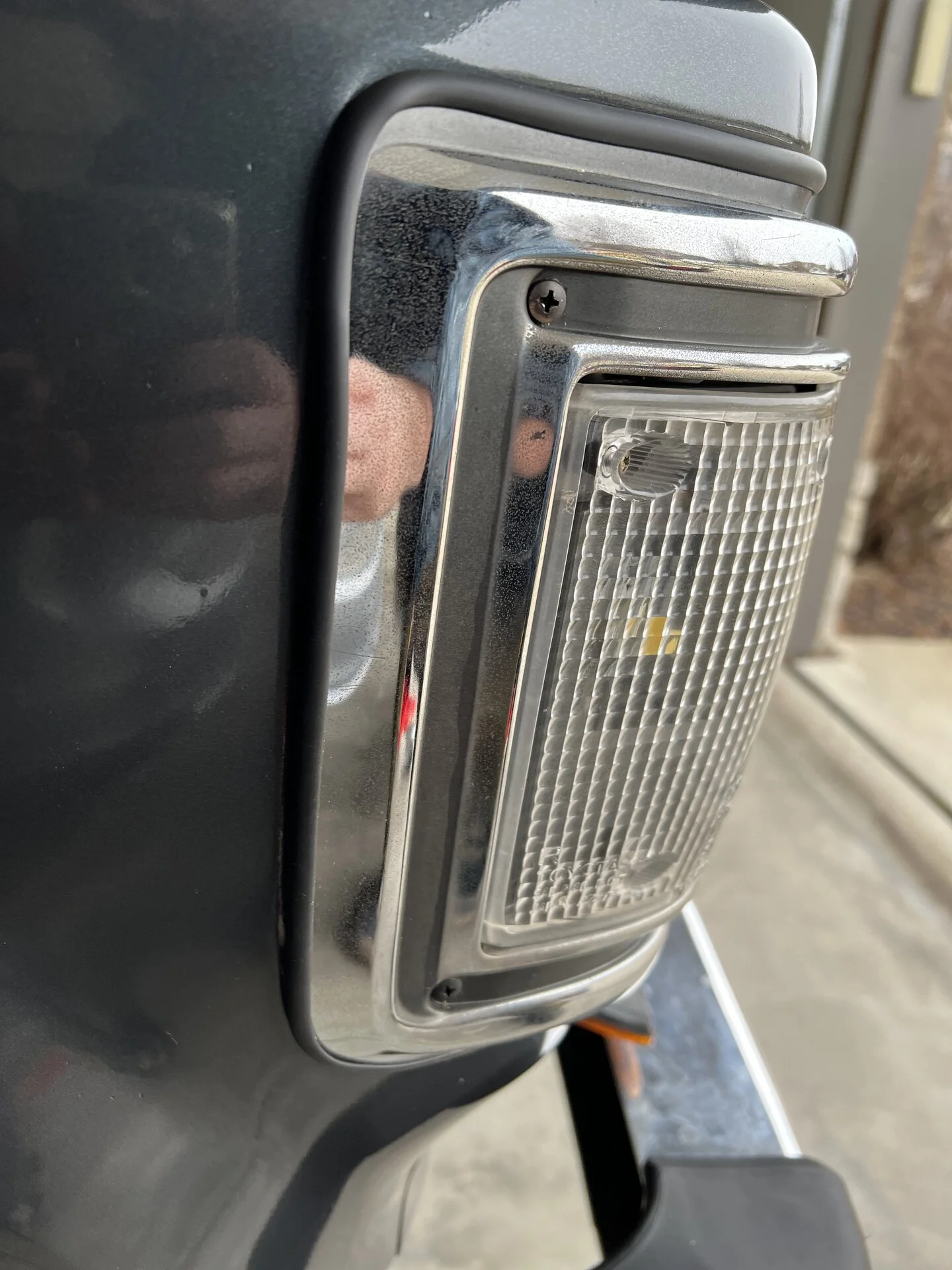

Thanks for the tip @thecadefire. Ordered 10-feet and it arrived in the mail today. Will be installing it on my FJ62 headlight bezels this coming weekend.About a year back I was in need of a headlight Bezel Gasket for my Fj62 as the old one was cracked and half of it was missing. Toyota does not make a replacement whatsoever, neither do any popular cruiser parts suppliers. A solution and suggestion I used by other people was to use Bushwacker Fender Flare "C" style Trim. I ordered mine off of eBay and it worked great (see pictures). IMO it looks much better than the OEM gaskets and seals better too. Hope this helps someone if looking for this part.
