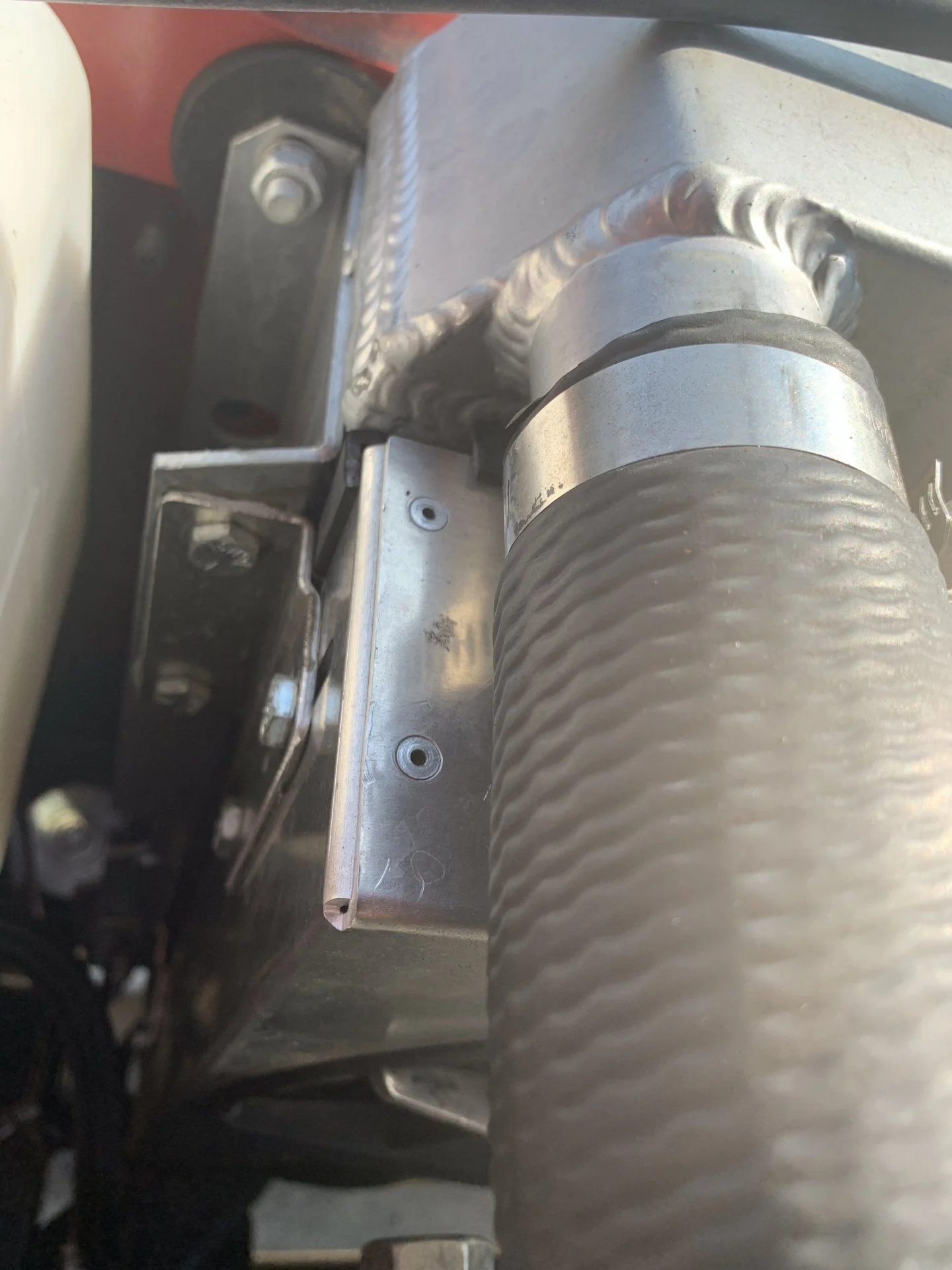

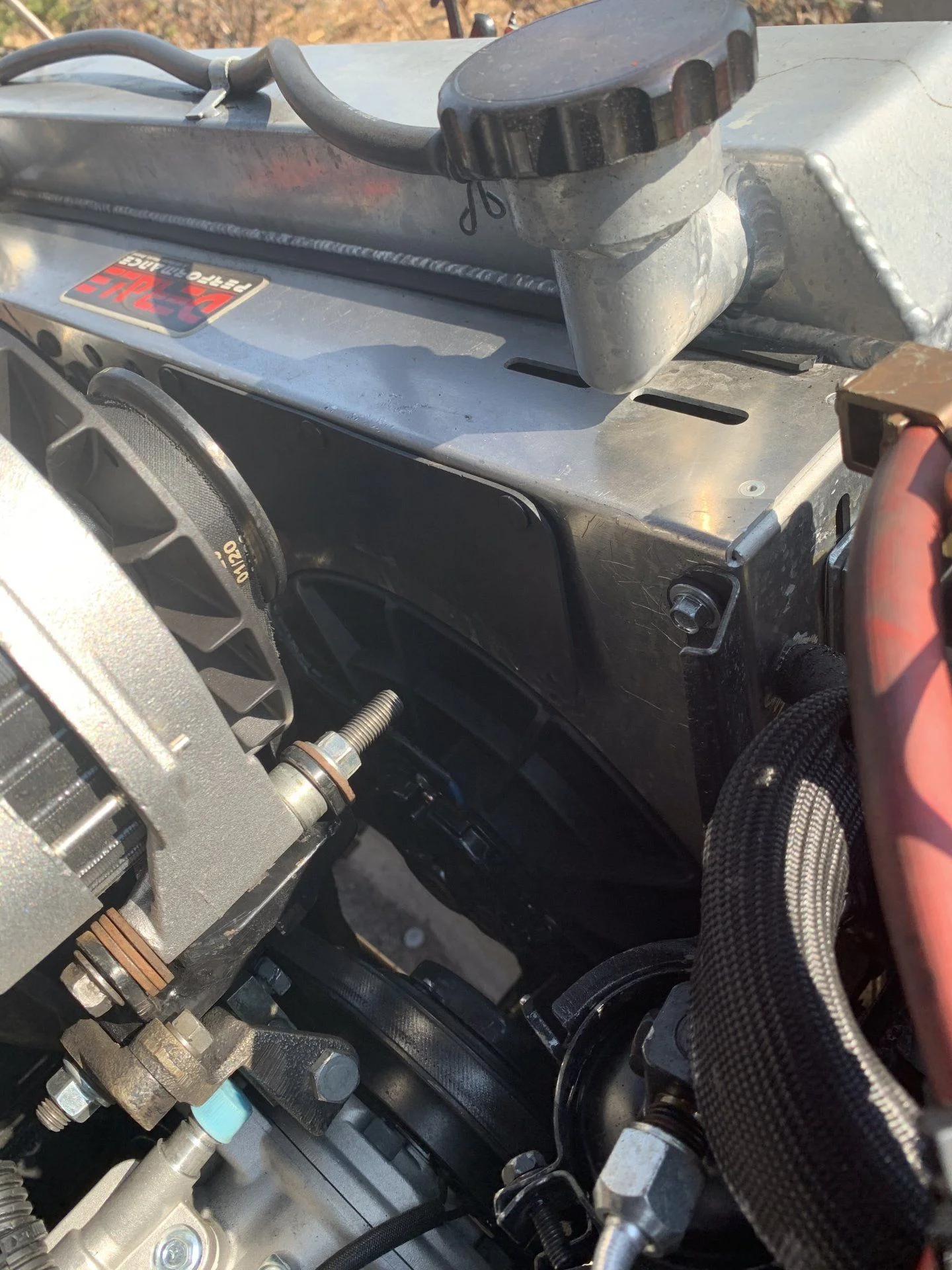

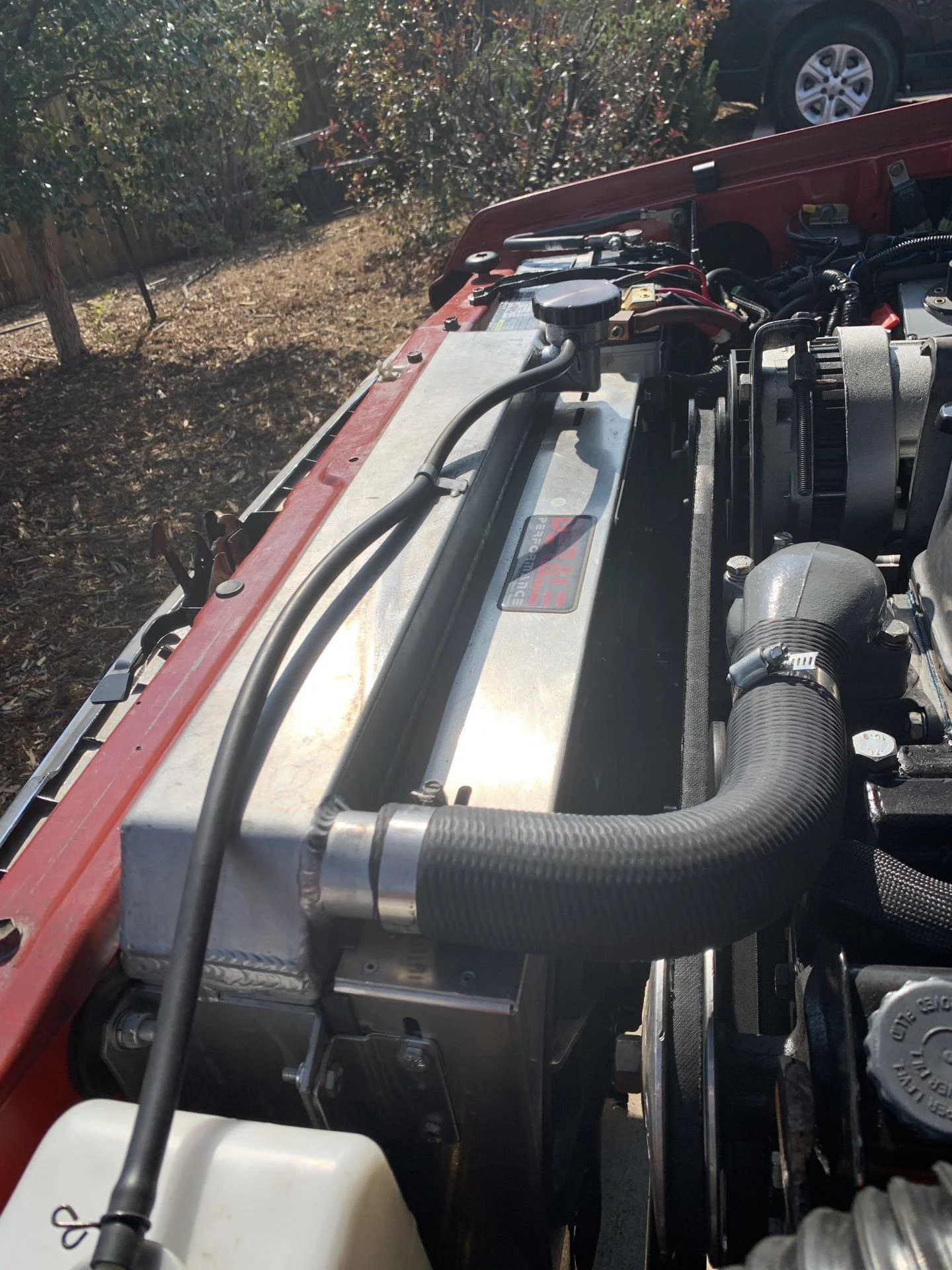

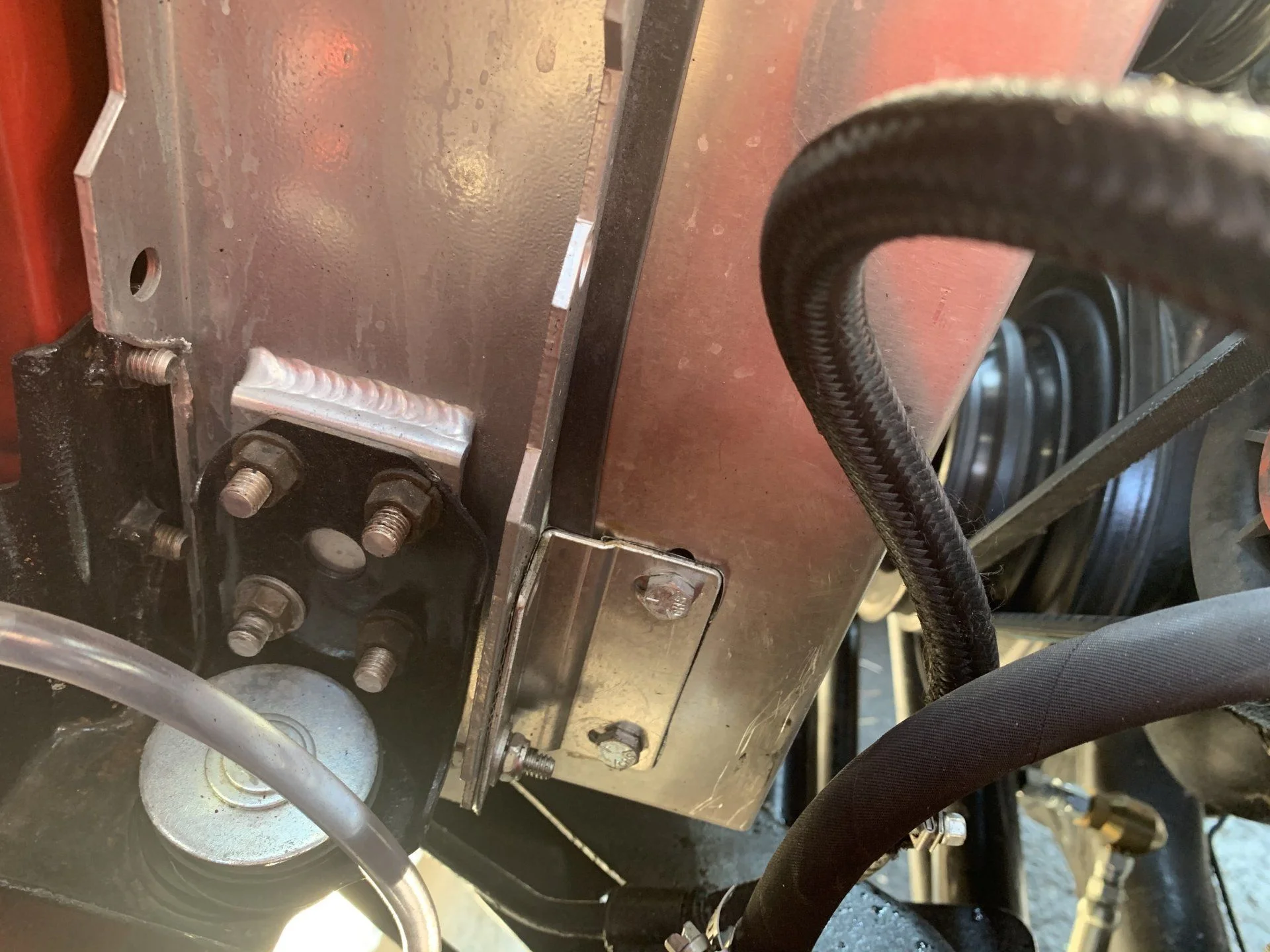

Here are some photos of my mounting of the dual fan behind an new aluminum radiator.
thanks so much for these photos... tempted to give this a go as my current electric fan setup is not working cause the shroud is very minimal and the vans are right up against the rad limiting air flow... has a hard time staying cool even at speed. the shroud on this looks huge, and i like the extra air vents which look to open up at speed. ... gonna decide b/w this or just going for the full mechanical setup. this would def. be easier if it can handle the deserts with a/c , (i'm in socal)
