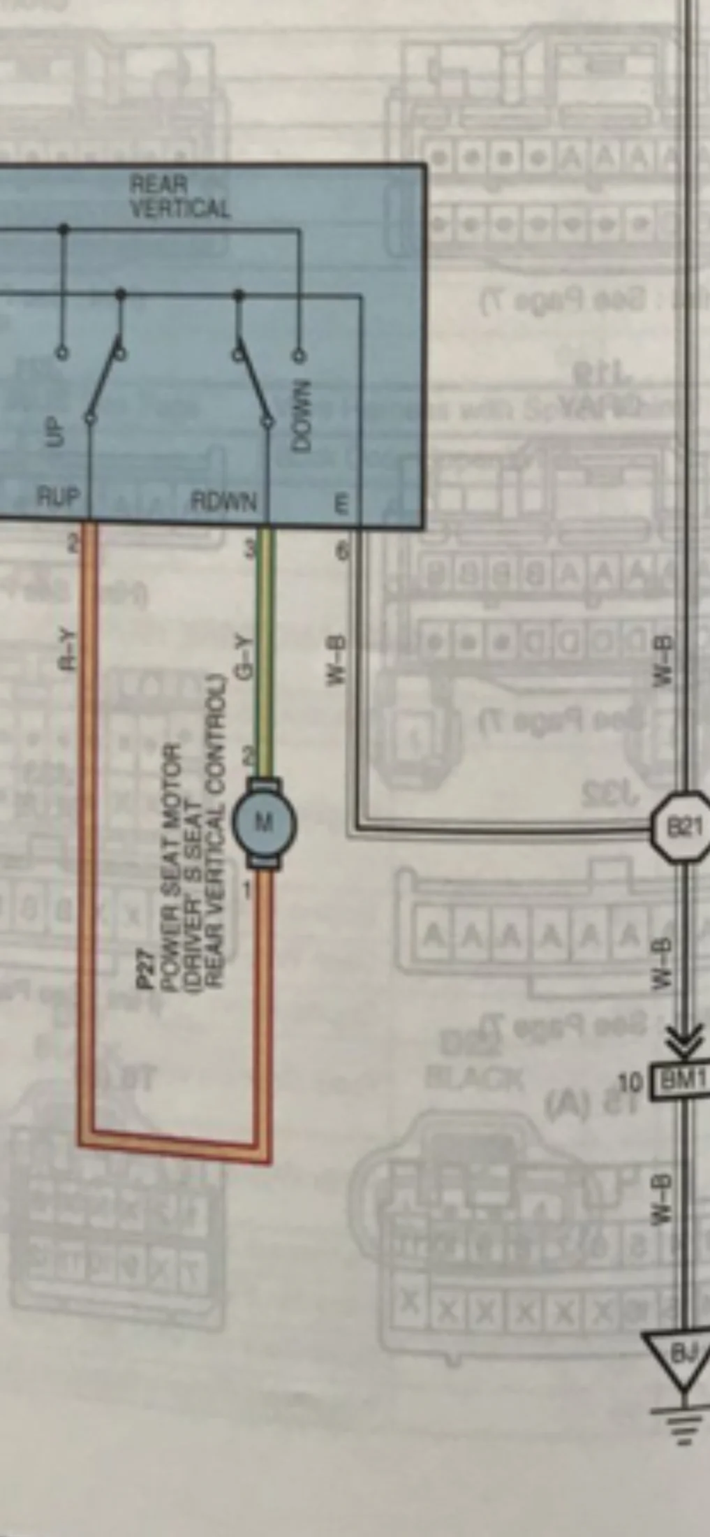

Here is the LX 460 wiring diagram for the one seat motor (thanks to Ayune) MUD member, years ago.

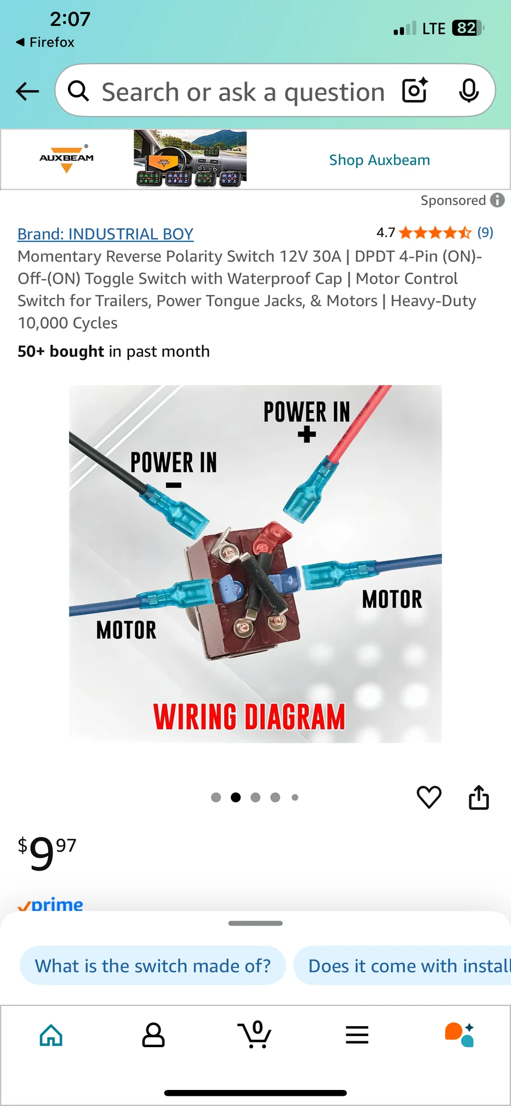

Well-didn’t get any replies to help me…maybe someone with answers didn’t see this thread..maybe my honesty regarding my brain diminished due to grief kept people from responding—-so, I researched online for sometime and found consistent info between auto window switches and a marine forum; bottom line solution was a 4-pole switch with momentary up/down toggle.
Here’s the schematic;

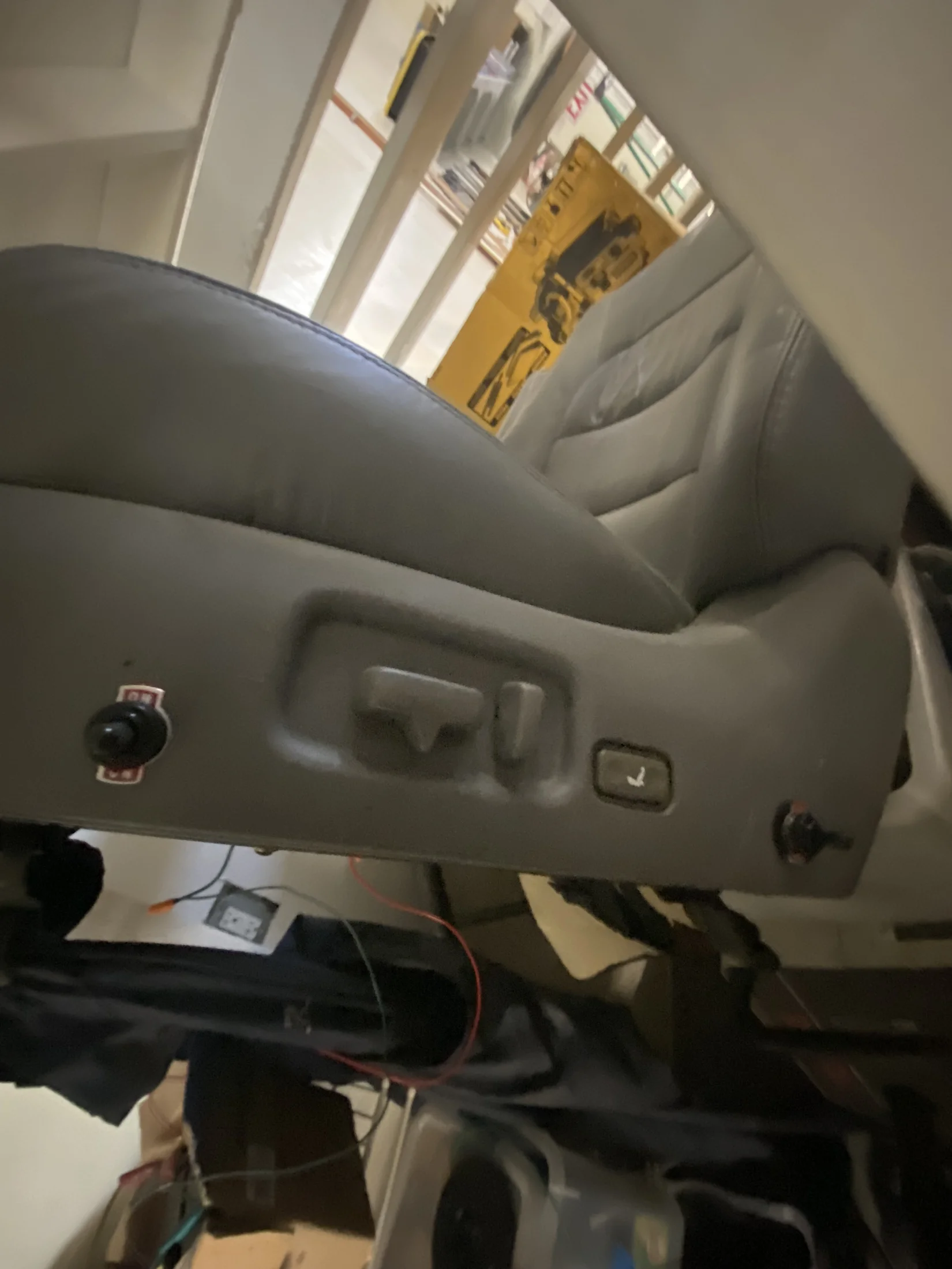

Here’s the photo installed switches—they work perfect so now all seat functions are good;
