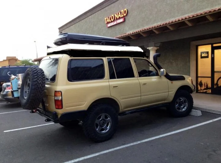

So curious on what the group would think looks best for the top. I thought black would look cool but the heat would be bad (I don't have A/C either). So thinking white or color matched, found this 80 which is all color matched and I think it looks good. Or maybe base color match and top white? Any thoughts?

I vote for a color matched top. Black would definitely be too hot. Maybe a color matched base and white top. I’d have to see an example of that.
Yeah dude,I'm thinking the color match base with white top. Since it's visually seperated I think it could look good, and fit the style. Need some photoshop masters to weigh in
Yeah it really wouldn’t look much different than a rig with a RTT on it.... although that being said... what about a black base and white top? Lol.
@ProwlerDriver admire the finger painting done by yours truly on my iPhone. Just don’t zoom in. It gets the point across :D
I was in the back of my 60 the other day, working on it in the sun. I have ripped out the headliner. Mine is silver and even then, holy cow that roof was radiating heat like an oven. I decided then and there that the roof will be painted white. I vote for colour matched base and white top.
Color matched base,white top here too.
