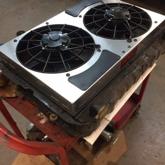

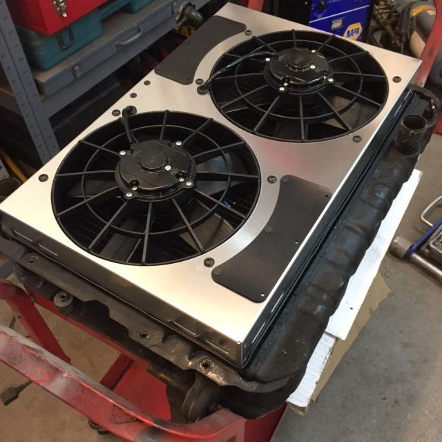

Just thought I would throw this up, as members are always looking for ideas. I picked up this fan setup from Summit. They draw 18.5 amps each, 3750 CFM. The shroud fits the stock radiator with 100% core coverage, and will mount to the existing fan shroud bolt holes with supplied brackets. Good reviews! Manufacturer is Derale

what is the demonstrated performance of this setup (if you have it installed), what are you using as the fan controller? Assume your A/C is functional too?
I don't have it installed yet. The ECM will control the fans for temp and AC. 1 is set to come on at 195, and the second at 205. I am using the PSI wire harness, and it has signal wires for Fan 1, fan 2 and AC

Ok, you might want to scan through some of the threads dealing with electric fan setups, if you have not checked that out. The real test will be off-road in 4wd on long extended hill climbs in low speed/low range in 4wd with reasonably high ambient temps. Add other electrical loads and a/c in the mix too. I think SPAL has a similar configuration. Setup looks good and fit looks good on what you've posted. Not sure what the recommended CFM rating is required for cooling GM small blocks.
I prefer the old school GM fan clutch and related fan clutch mechanical fan for cooling, thats whats on my 5.7 swap. From what I've seen the fans that really perform, draw some serious amps with respect to electrical fans. I don't recall many having good luck with overall cooling on electric fan setup, those that run off-road and have a/c and everything functional. I messed around with electric fans for a little bit because at one time I was concerned about the clearance between the engine and radiator core on my setup (5.7 swap), but later on found out that I just had enough clearance to run a GM fan clutch setup, and custom fan shroud.
Post up when you have things running and you can test performance off road on cooling. The "good" on electric fans is that you can have 100% cooling capability at zero vehicle speed but high engine temps, the bad is that if your cooling needs overwhelm the capacity of the electric fans its a no-win.
I think the radiator size in exposed surface area of the core is an issue that is problematic with cooling of V8 swaps on the LC family of vehicles which of course is not something that is easily solved. I've found that the 4core OEM style radiator combined with a GM fan clutch and associated GM fan that match the GM donor engine, along with the custom fan shroud solve the cooling issues, such that can be dealt with, within reason. Plus no worry about electrical load or other gremlins.
