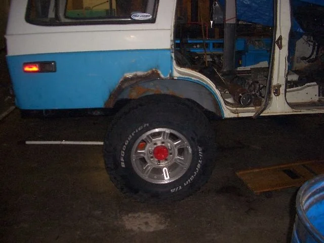

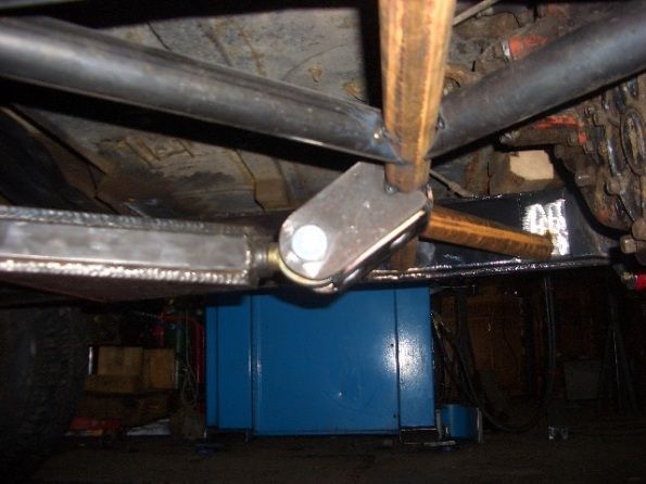

i built a custom swing arm for the rear and custom radius arms for the front. coil springs front and rear. chevy 360, sm465-205-203.

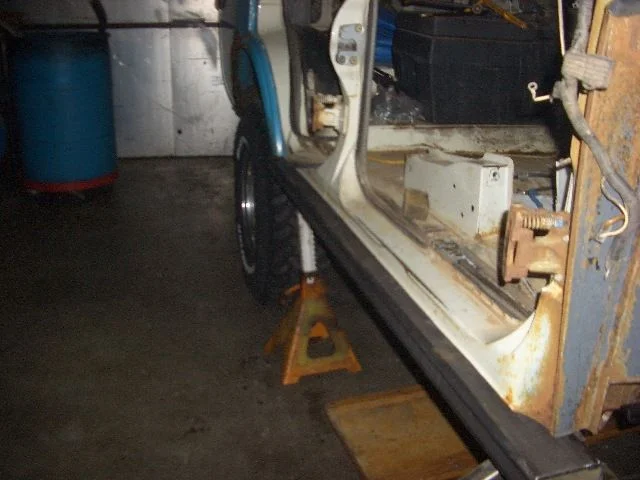

i am in the process of rust removal and repair. i cut off my rockers and chopped off about 8 inches off of the rear quarterpanel.

the rust is not too bad, but 3-4 of the body mounts are being completly redone, Most the other rust was cut off this weekend :grinpimp:

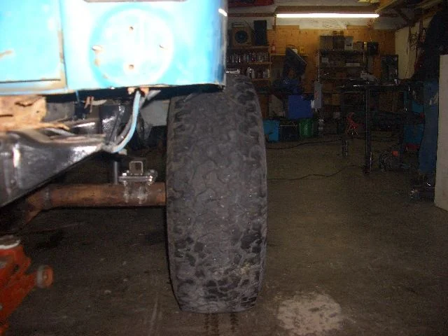

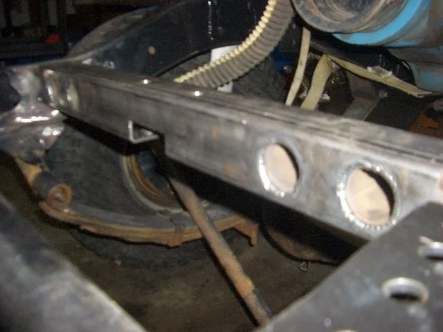

Ben Built a new front Crossmember, and got the Rear Suspension almost together.. it may sit an inch or 2 higher at ride height.. 37" BFG's on H2 wheels..

the plan is FJ80 Front Coils In the Rear, the swingarm shown. plus a track bar. Ben was working on the Buckets and Spring mounts last weekend, he should have it all figured out this weekend, ill get some photos up soon.

Its definatelly really cool lookin though... but me bein kinda new to this whole thing i cant tell what im lookin at with the little amount of pictures. even though what i can see looks very well built! AND some very pretty welds i might add...

Yes it will be wider than stock, but as you see in the photos, only about 4" of tires outside of the body.. Wider is better, especially on a top heavy wagon like this.. We have pretty wide trails here in the west!
We are trying to keep it Low, in the photos the body is not sitting down on the frame perfect just yet, he has alot of rusty body mounts to rebuild.. the goal is to have minimal up travel and lots of down travel, with center limit straps..
