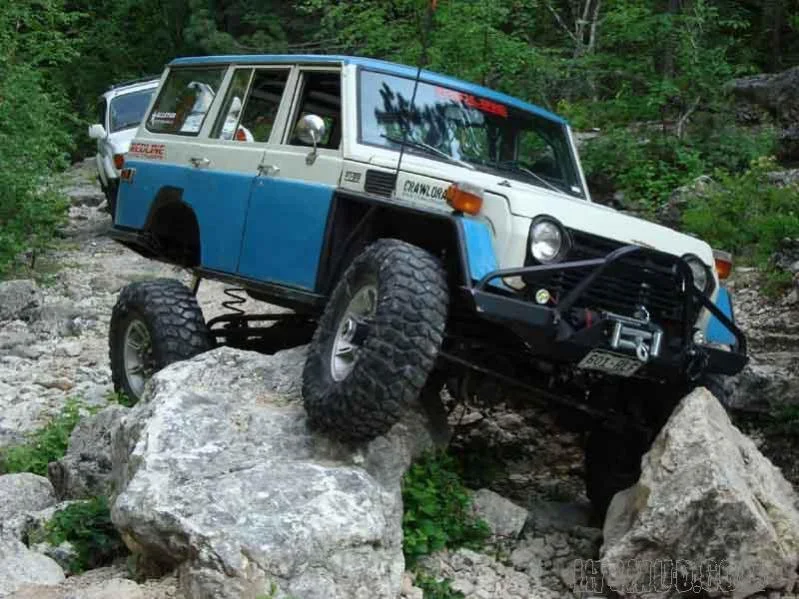

Isn't that Iceman? Were you able to crawl onto that rock plateau (forget the name) near the end of the trail? For that amount of rear flex, are your shocks mounted thru the bed? Running sway bars? I think you need to add an angled piece , near the rear of the front fenders, to finish out the body line transition :D
Yes it was ice man, the plateau we did get!!! the shocks come through the wheel wheels and are mounted to the cage! no sway bars, as for the front fenders, we were thinking about that and just decided not to. it grew on us!!
