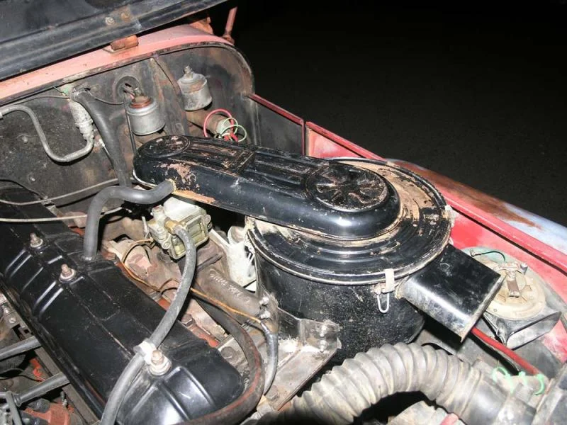

JP something's look odd on the pic you posted. the air inlet doesn't look right, I thought they are round? also the hold down should be a wing nut not the snap clips.
I have an oil bath assembly on my 65. stock.
Paul

That looks exactly like the oil bath on my '65. Inlet & clips
Sent from the monkey house.

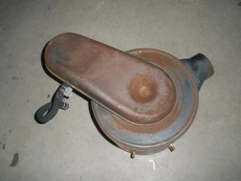

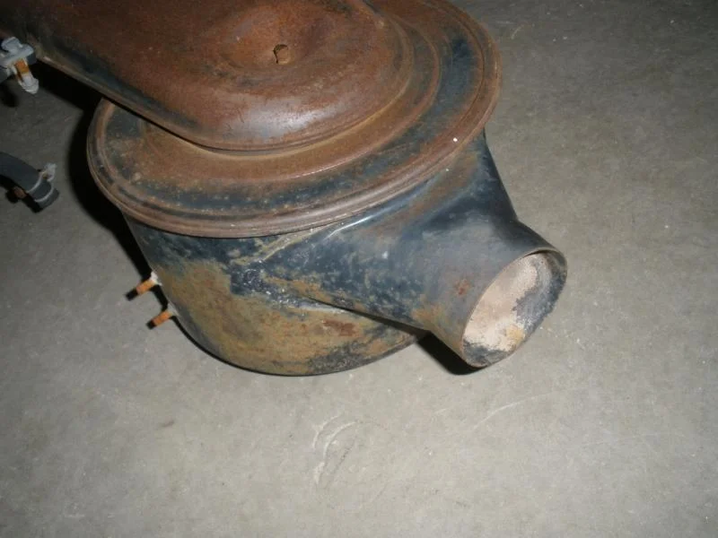

JP stated paper element, I looked at the 45 today, and yes it does look like the above pic from JP.
Here are some pics of an air cleaner from a 63
Paul
