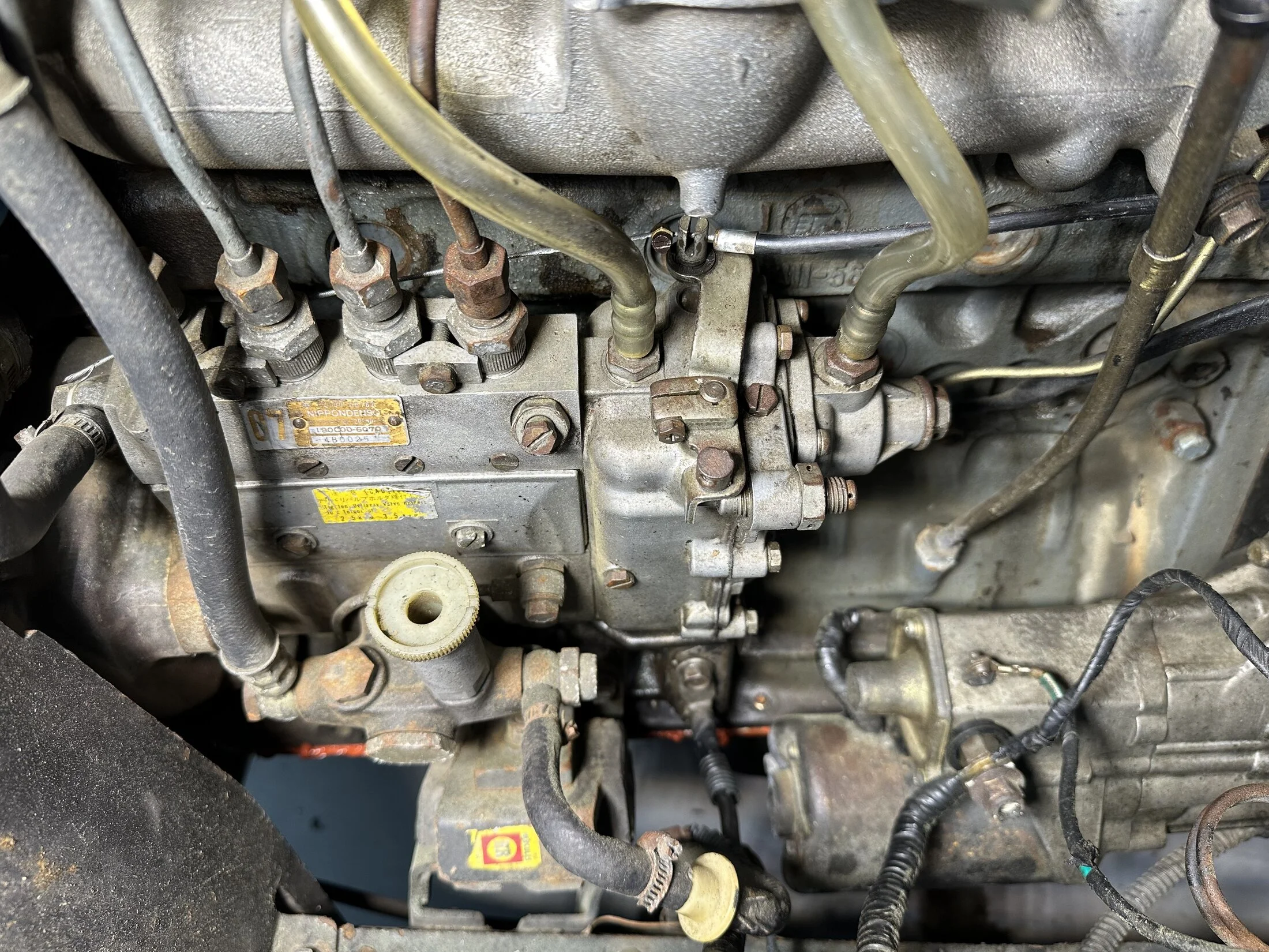

Maybe you can add a photo of how your injection pump looks right now?

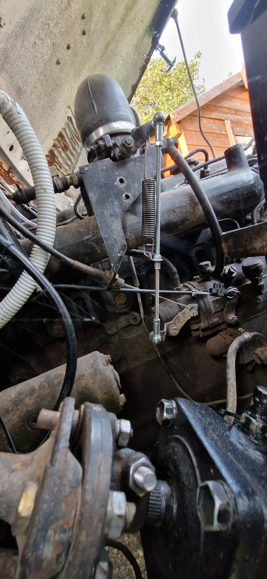

I add a picture of what mine looks like currently on my H - not sure if it helps you much but hey. I don't recommend the choc-bloc securing the cable but if it works it works...
FYI I have an over injection magnet, so my arm can't move too far anyway.

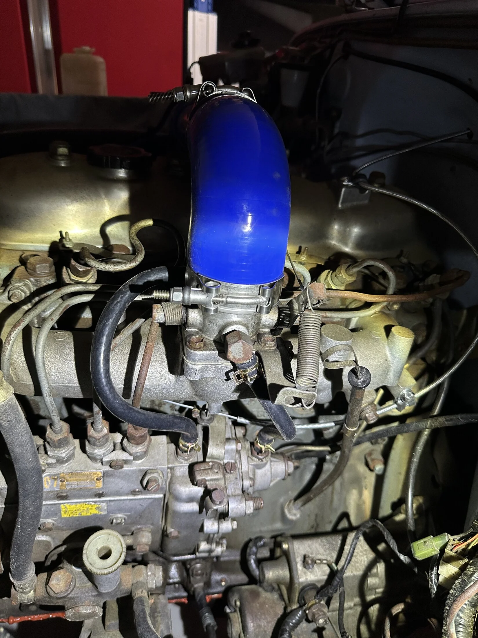

Thanks! Here’s a pic of my pump and the cable
Any chance your throttle cable stuck open? Also the two ascending vacuum pressure differential hoses from your pump to your throttle body are not oil safe - they need to be. Check their condition.

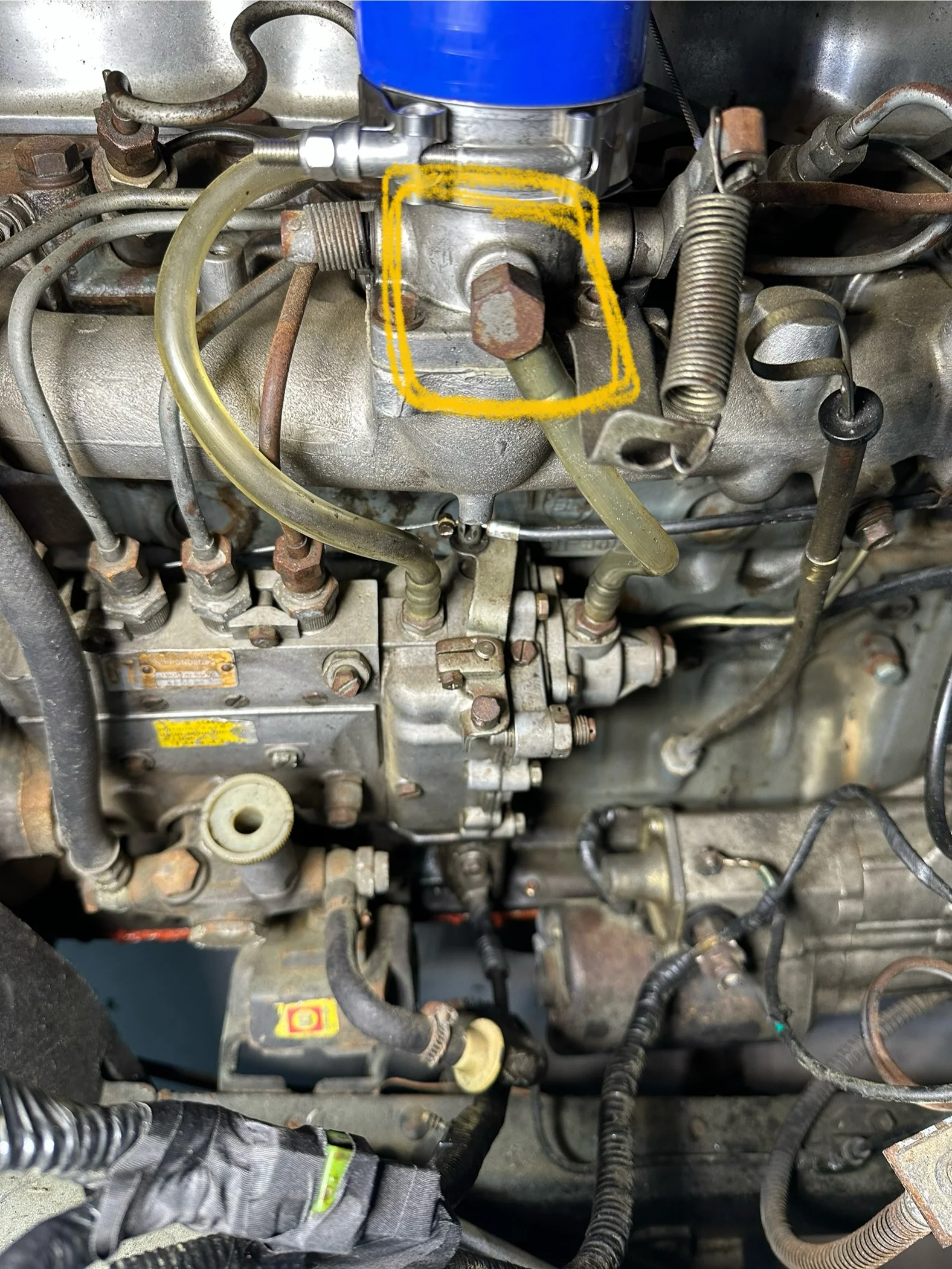

I wondered if those lines had to be clear or not. I’ll swap those vacuum lines out for oil safe ones. They look ok but both lines did pop off during the runaway. One of the lines even blew off the connector with it. Does that connector get any adhesive on it or just pressure fit?
They look ok but both lines did pop off during the runaway. There is not clamps originally
Well, that might be the reason. If the vacuum hose pops out, you’ll get the maximum fueling. When turbo is installed, you need to put some clamps to the hoses.

The hose on the right with the fitting to the top of throttle housing popped at the fitting, not at hose connection. Do you know if the fitting I circled in the picture needs some sort of adhesive or is it just pressure fit? Is there another way to secure it?
the hose on the right with the fitting to the top of throttle housing popped at the fitting, not at hose connection.
The metal fitting came out of the throttle body?

Is the black outer part of your bowden cable actually secured to anything? Otherwise it won't work obviously.
Also, the nipple should be able to both push and pull the arm iirc, which it doesn't look like it can.
Thank you for this detail. I didn’t realize it had to be able to push the arm too. Back to square one then haha. The black outer part of the cable was split. I found an aftermarket one that has a metal coil outer sheath and solid cable inside. I just cut it to size and trying to get it mounted just can’t figure out how to secure it so it can both pull and push the arm.
