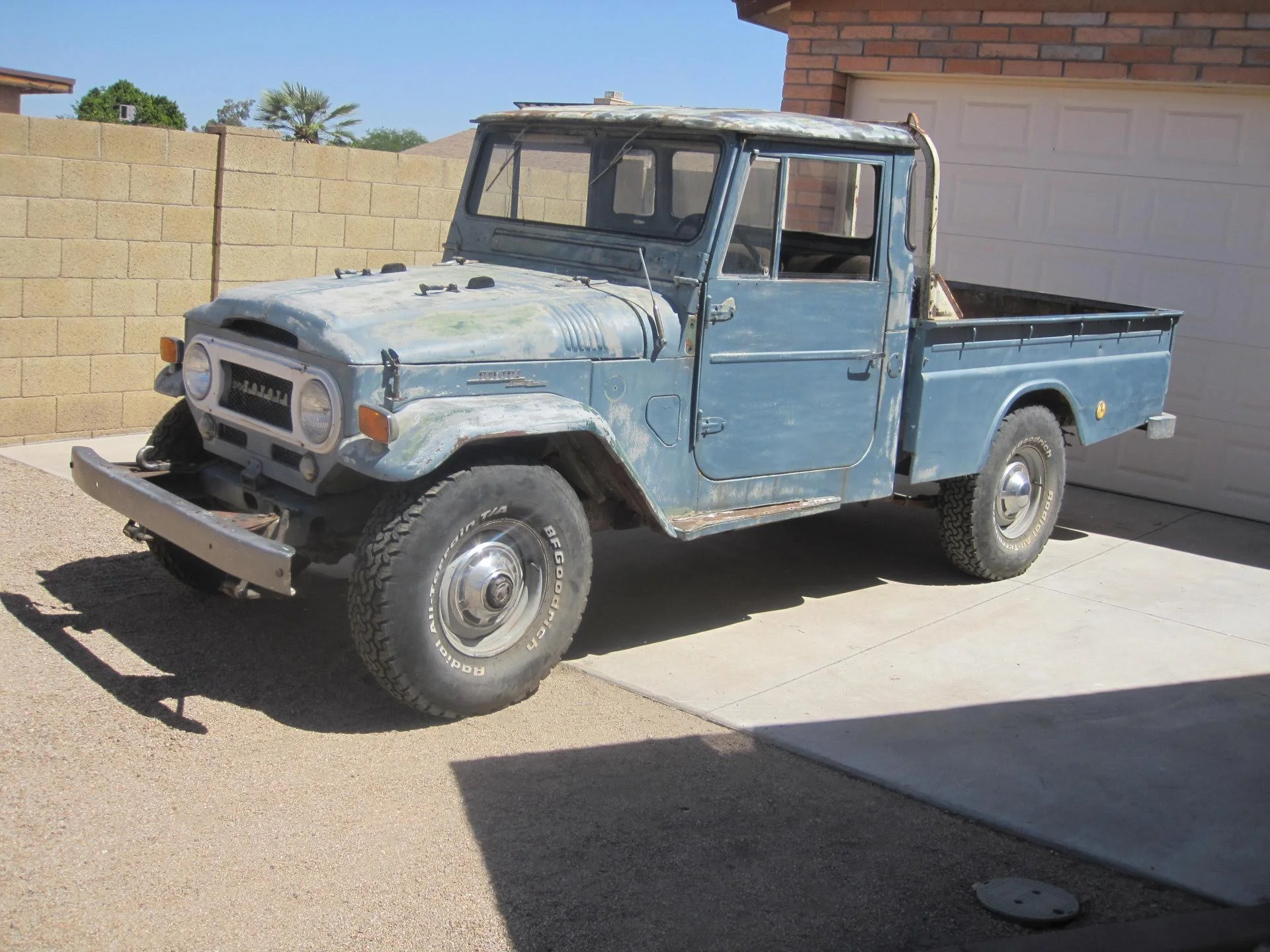

you probably won't find a South American 43 with original paint. I have never seen one. We have a lot of 43's come up through Miami.
They were ALL work trucks. Look for frame damage behind motor mounts and spring hangers.
Also, 43's ride terrible since they have the same springs as 45's.

Good to know. The one I'm looking at SEEMS to be the original paint, but I'll get more confirmation. I'm considering flying down regardless to do an inspection. I'm not too worried about ride quality just yet. Nothing OME can't fix
An OME kit is also a 45 spring. So they also ride really hard.
