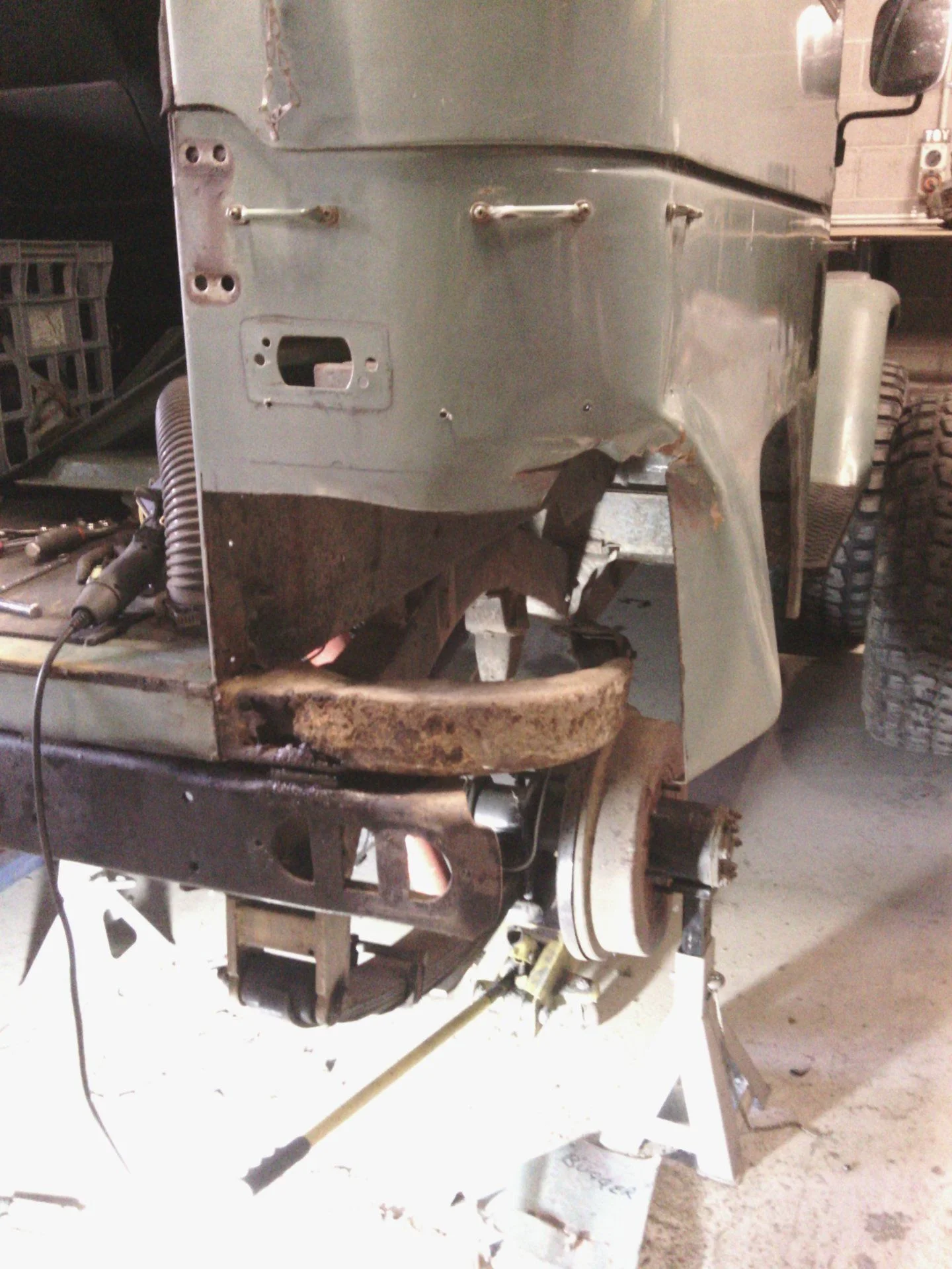

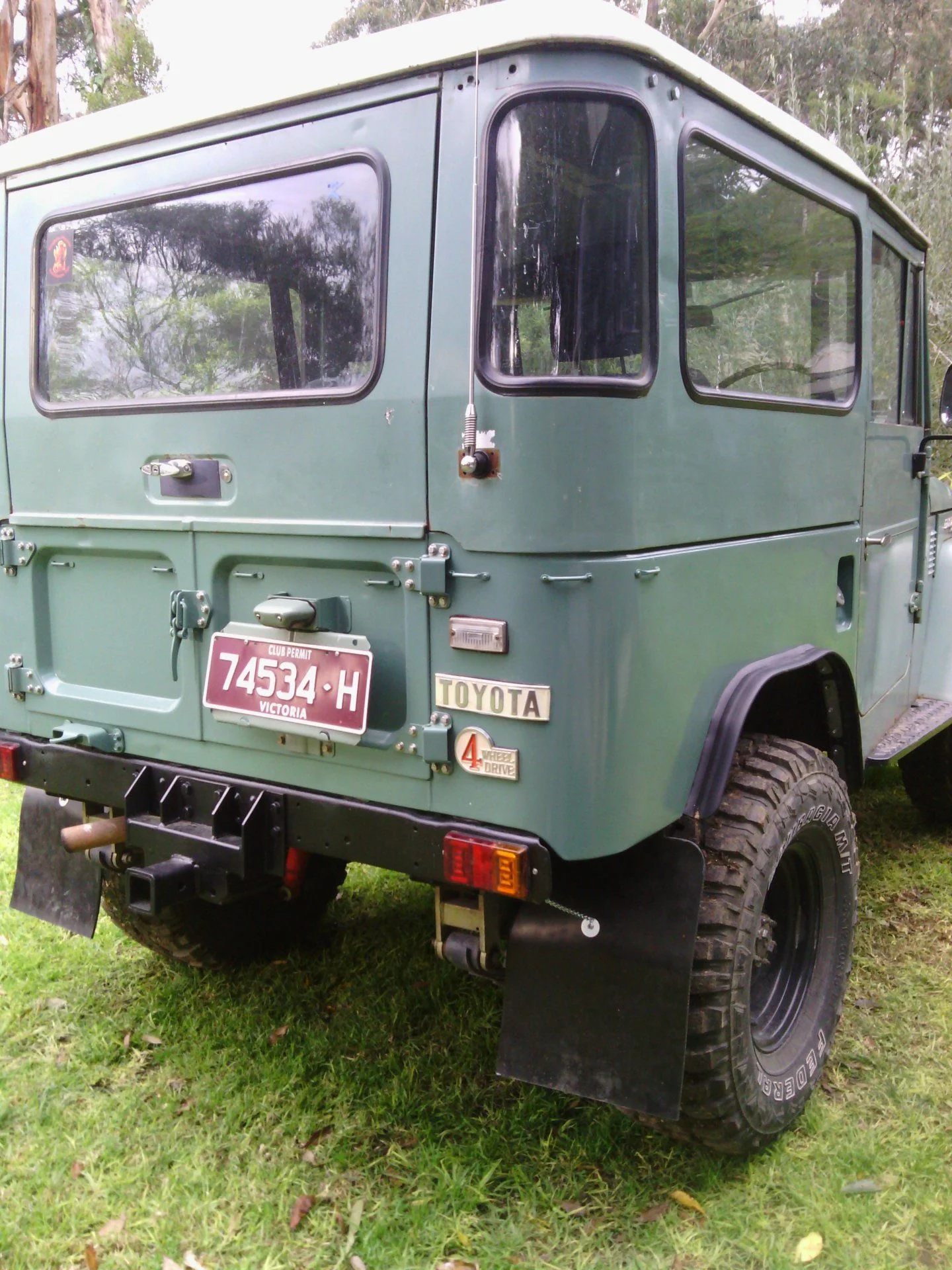

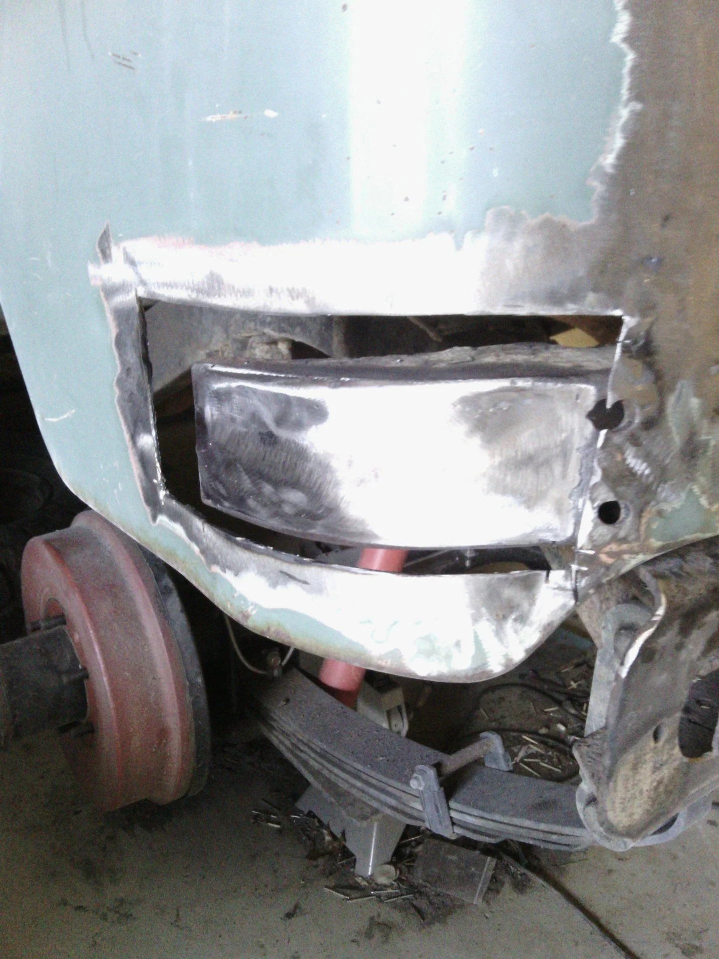

My quarter panels were supplied by Kingsley at Homs Toyota Parts in Sale Victoria Aust, and the great panel repairs done by Chris Newnham of The 40 Factory in Melbourne Aust..
Both good guys and experts..
Gaz..

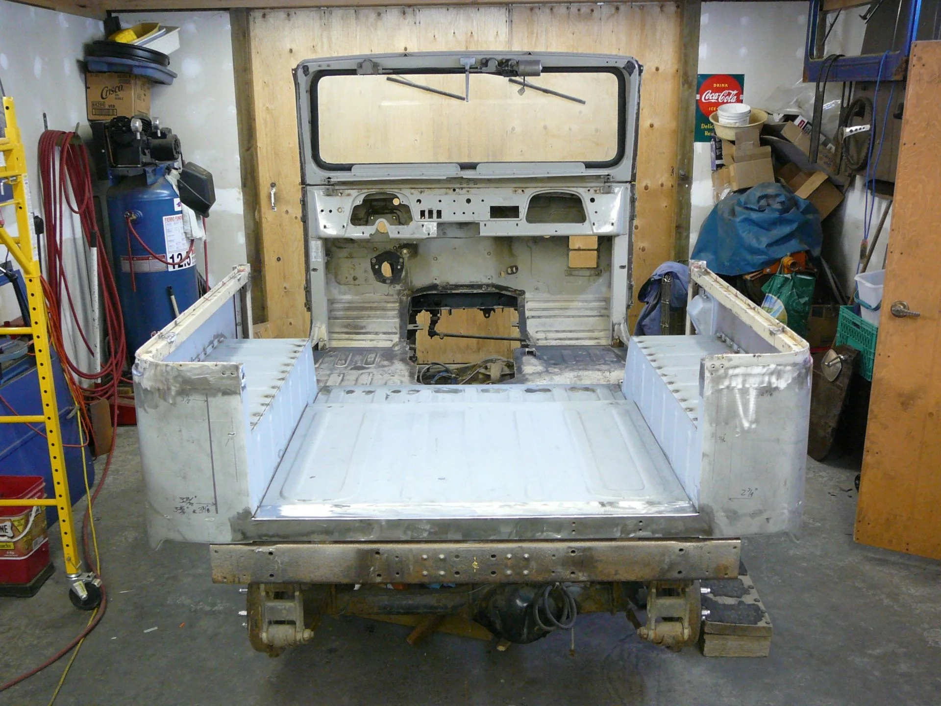

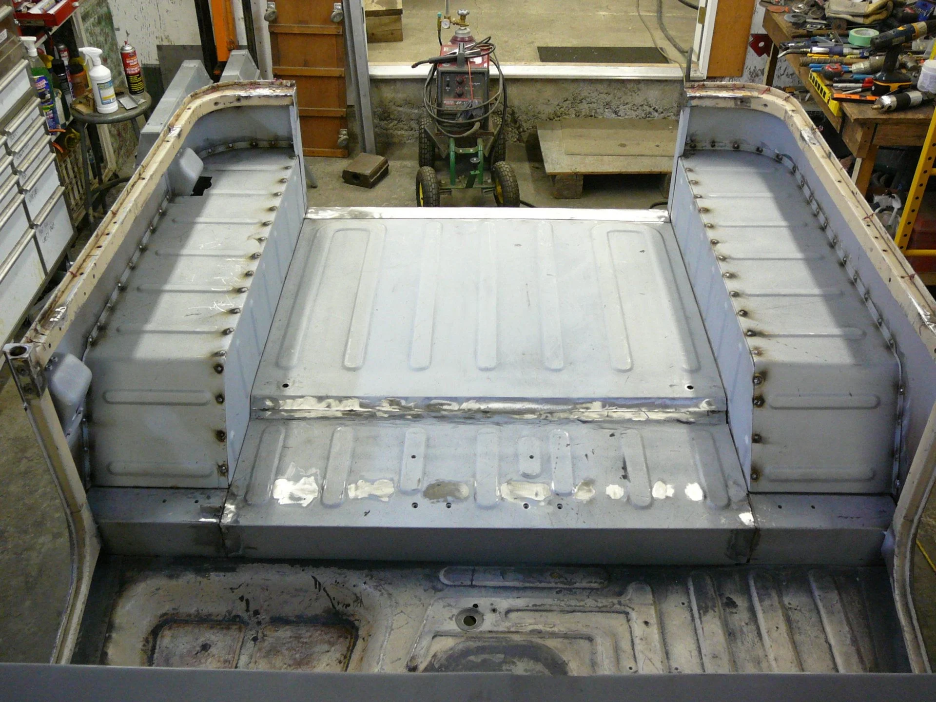

I rebuilt my FJ40 tub using CCOT parts. They are actual old Toyota dies and jigs. They required zero adjustment.
My tub came out within 1/8" square all around. I don't think anyone builds anything with tighter tolerances.
I would recommend them any time. The outer skins are handmade, none were available at the time. This 10 yr old build.
