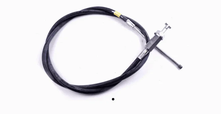

I would like to have my mechanic connect the parking brake on my 1969 40. The truck had the 2F motor installed when it was re-done. There appears to be a parking brake cable, but it is not hooked up and I do not have the handle. The attached image looks like the cable that is under my hood. Any idea if this will work if I find a handle? And if so, what handle should I look for? I am assuming a later FJ with the 2f motor. Thanks!

Tks. I’m assuming it has all the guts as if is connected to the rear drum. The cable runs under the hood but stops there. It was never connected inside the truck or to a handle.

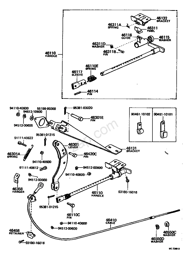

My NOS cable assy 46410-60021
fits :
Part 46410-60021 (CABLE ASSY, PARKING BRAKE, NO.1)
it is also Available right now , if anyone needs it ..........
PM me please .............
Date rangeModelFrames/OptionsFound in diagram
03/1969-06/1980TOYOTA LAND CRUISERBJ40,FJ4*,5546-01: PARKING BRAKE & CABLE
Model Dates:Matching Models:Model Options:Links to diagrams:
03/1969-12/1974FJ40L-AUSA, TP, F46-0146-01
01/1975-01/1976FJ40L-KJAUSA, TP, 2F, 4F, RB46-01
03/1969-12/1974FJ40LV-AUSA, VAN, F, VLS46-0146-01
04/1972-12/1974FJ40LV-ACUSA, VAN, F, VKC46-01
01/1975-01/1976FJ40LV-KCJAUSA, VAN, 2F, 4F, VKC, RB46-01

my 1965 paper parts cataloger has a 46410-60020
i checked both #'s
60020 and 60021
both cover exact same application dates range but DO NOT supercede it seams
do u know why this is ?
maybe @Living in the Past
or
@4Cruisers
can help solve this mystery too ?
thanks paul

there are 2 different styles in the pics in this thread,
the OP posted a pic with a "T" on the end to go to the pull handle assembly
pic you posted has an eye and needs a pin to attach to the pull handle assembly
@ToyotaMatt
ohhhhhhhh
ok
i see
strange ...................?
my 1965 parts cataloger shows my 60021 shape end with that metal clam shell shield too even ?
but has a 60020 part #
who knows ...........
