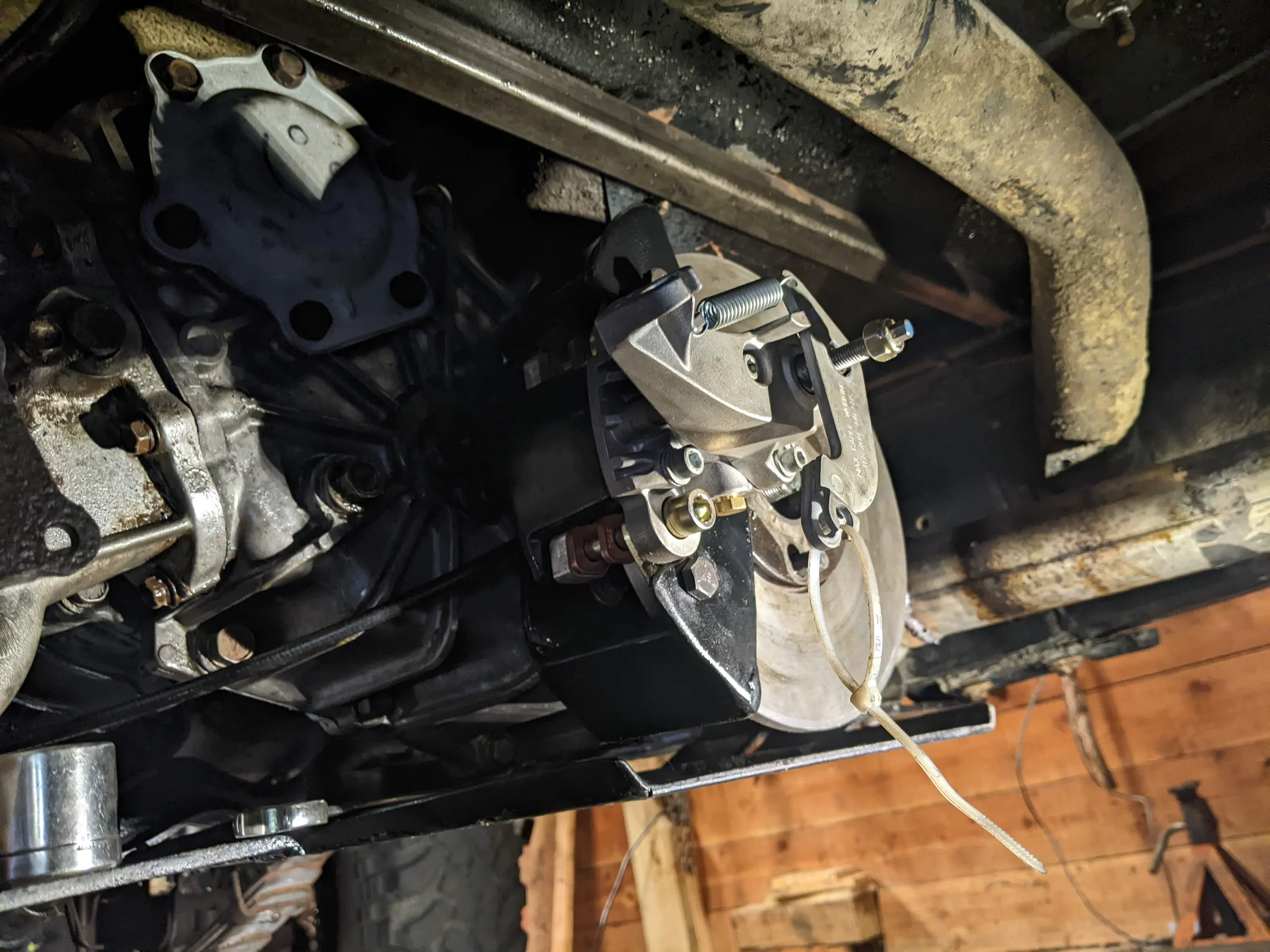

I put one on the back of my tcase with a disc.
Works pretty well now that I finally got the cable adjusted.
Tried one of their little go cart calipers first, but they're pretty hokey by comparison.
I have a 45ff in the rear with front calipers so not easy to mount anything back there on this one.
