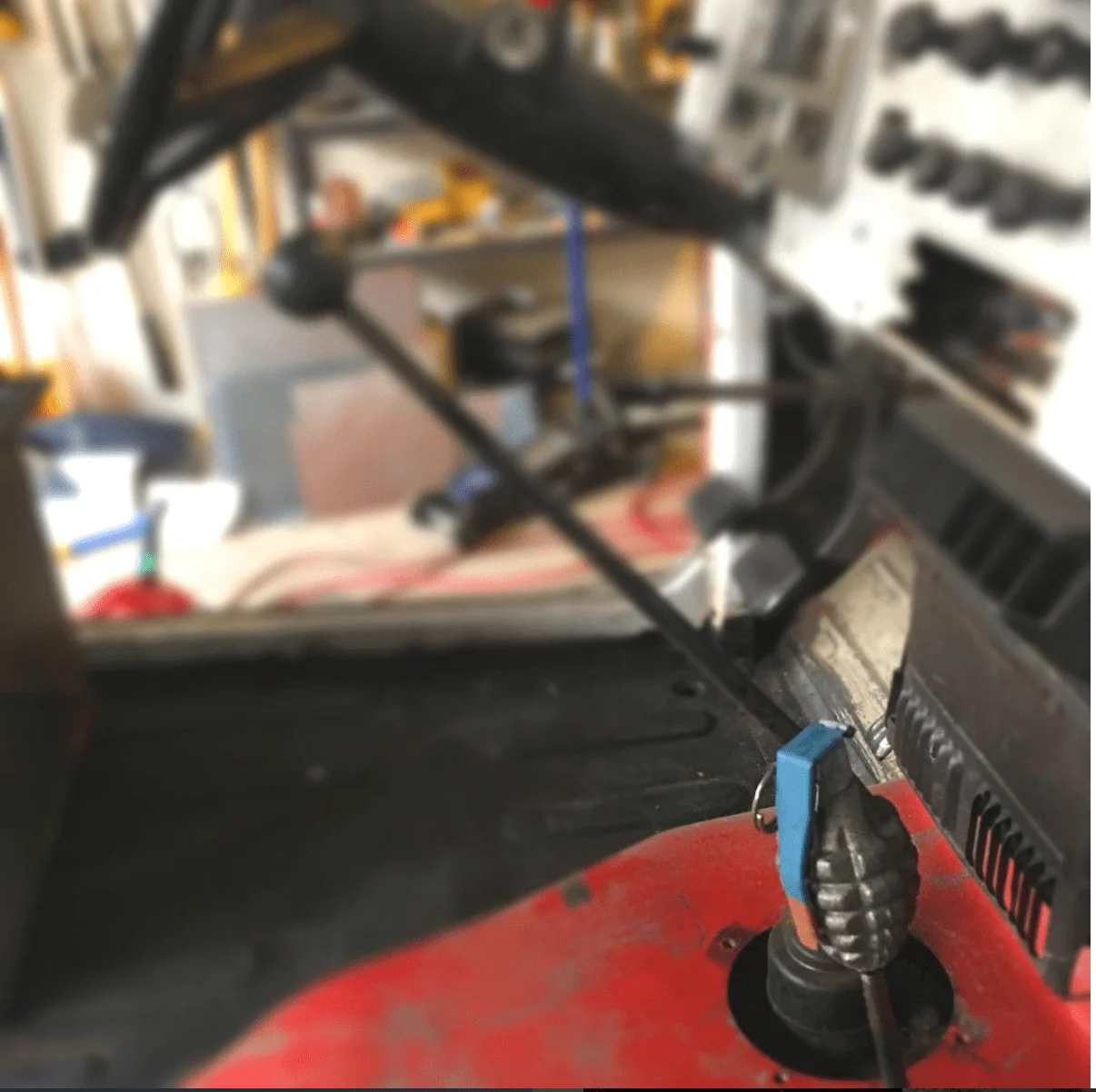

Thanks. I have a busted up original one floating around. The one I really need is the knob for the transfer case. I have three broken ones that all broke in the same spot. Not inspiring a lot of confidence in that design, especially for the $40 they charge. Need to figure out the thread pitch and make something cool for that one. KABAR knife handle, old hand grenade, top of a femur... something manly and dangerous.

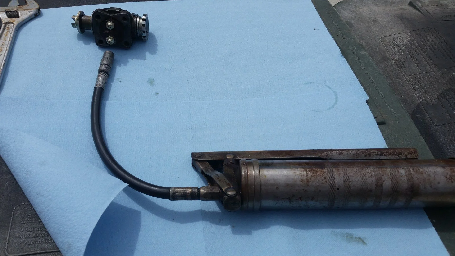

Finished rebuilding three out of my four rear wheel cylinders on my 2/71 FJ40. Of course, the fourth and final wheel cylinder piston and adjuster were stuck and would not come out of the cylinder. I tried putting it in a vise and using leverage to break it free, penetrating oil, compressed air, freezing the cylinder and then placing it in hot water, and a combination of the above. Still no success. I then found an online discussion about using grease. The discussion advised that grease guns could generate anywhere from several hundred pounds of pressure to several thousand. Sounded good to me. I went out and bought a package of zirk fittings and screwed them in the brake line and bleeder holes. One would act as a plug and the other would be where the grease would be injected. I then began pumping grease into the cylinder. After several pumps, the piston slowly pushed out of the cylinder. Once out, I removed the rubber cups and spring. (For some reason, the plastic spring seats were missing). I was then able to push the adjuster out with a press. It goes without saying that all the parts need to be thoroughly cleaned in the parts washer and with brake parts cleaner prior to reassembly. I was fully expecting the inside of the cylinder to be pitted and corroded, but that was not the case. Unfortunately, my rebuild kit does not contain the plastic spring seats. Now begins the search for the plastic seats... nothing is ever easy...
It seems like a good idea until you go to shift into 4-low without looking and accidentally pull the pin... I didn't even have that many friends to begin with...
If you're serious about the grenade I can check if I have any laying around (apparently it's a possibility that I have stuff like that just laying around my house. I guess that explains the friends thing).
Instructions:
1. Find a ripe grenade.
2. The first nut you pull out of your "jar-o' take-offs" will fit like a glove. If not, then you didn't do it the way I did. (which is the RIGHT way BTW. :))
3. Weld nut on the bottom of the nade.
4. Blue loc tite
5. Screw it on the shift lever. (mmm that feels right.)
The End.
Do not attempt unless you have a FULL 5 min to invest.

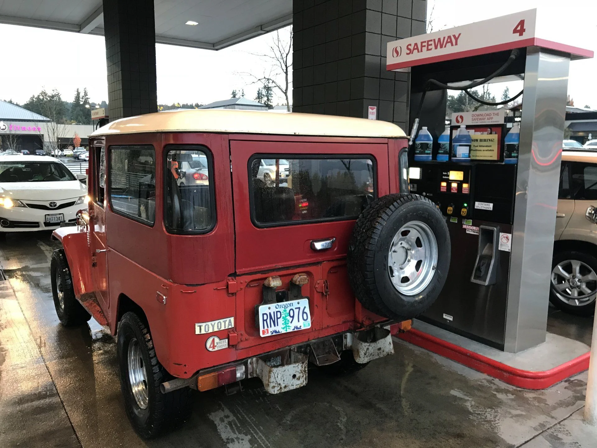

One quick trip around the block, then a quick trip up to the gas station and then another trip around the block with the wife. Great weekend of wrenching on the truck, great time driving with the family, and the most enjoyable fill-up at the gas station since my first car when I was 16.
