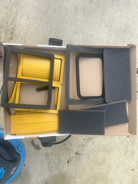

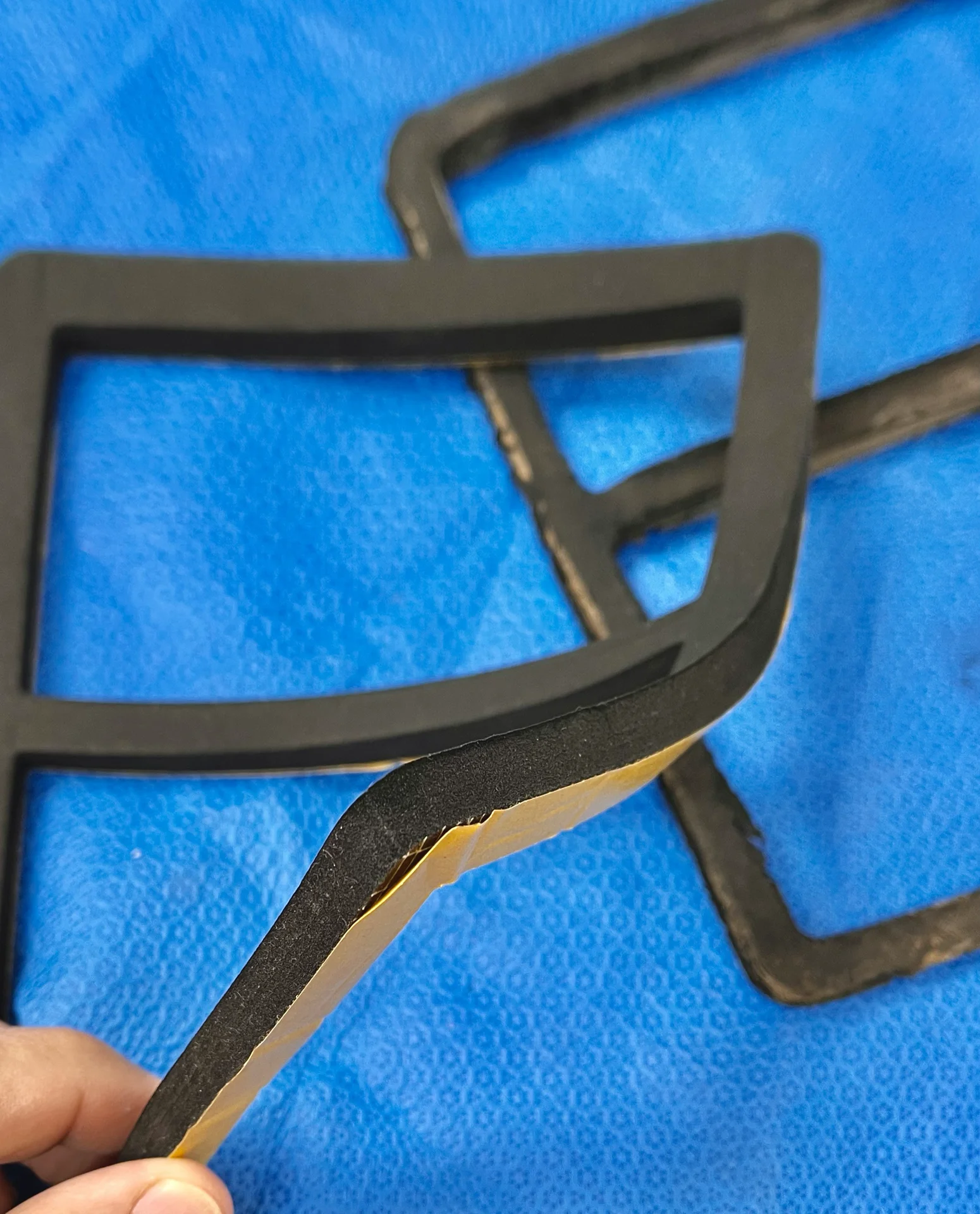

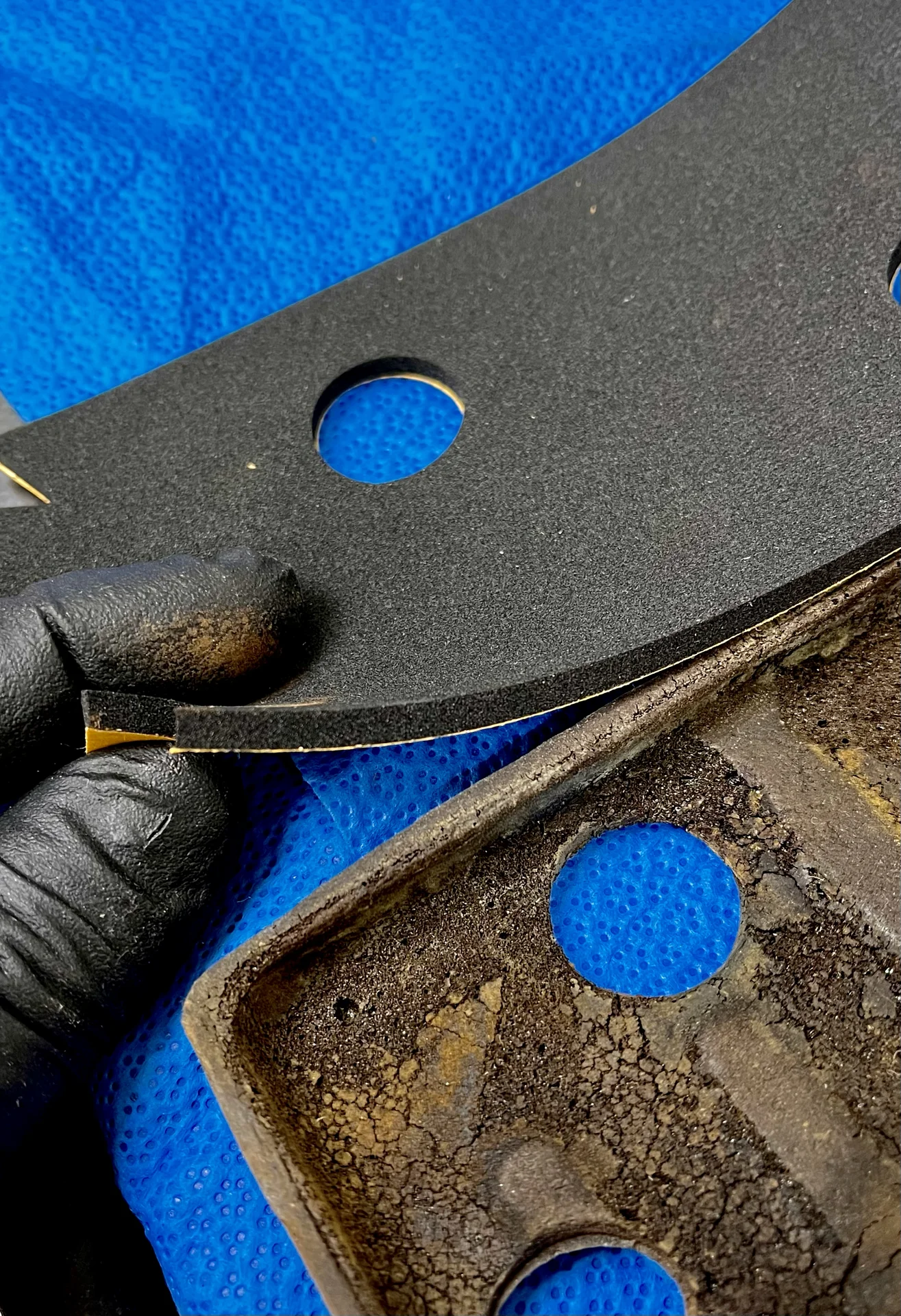

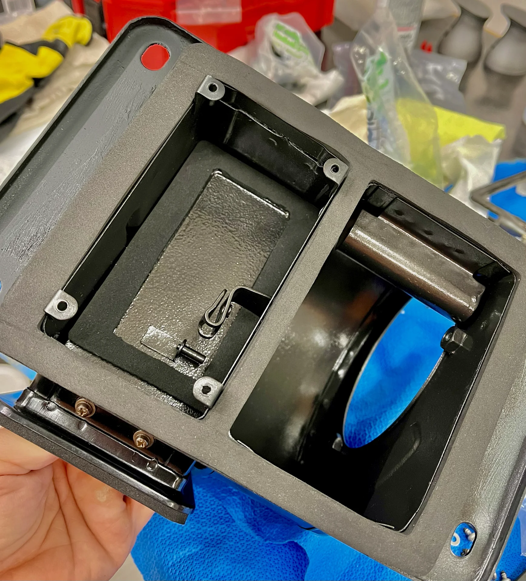

not affiliated in any means but figured I'd put it up for anyone looking in the future. I purchased this set off eBay (PartsPuzzle) from the Netherlands. I'll go through the set as I applied them.

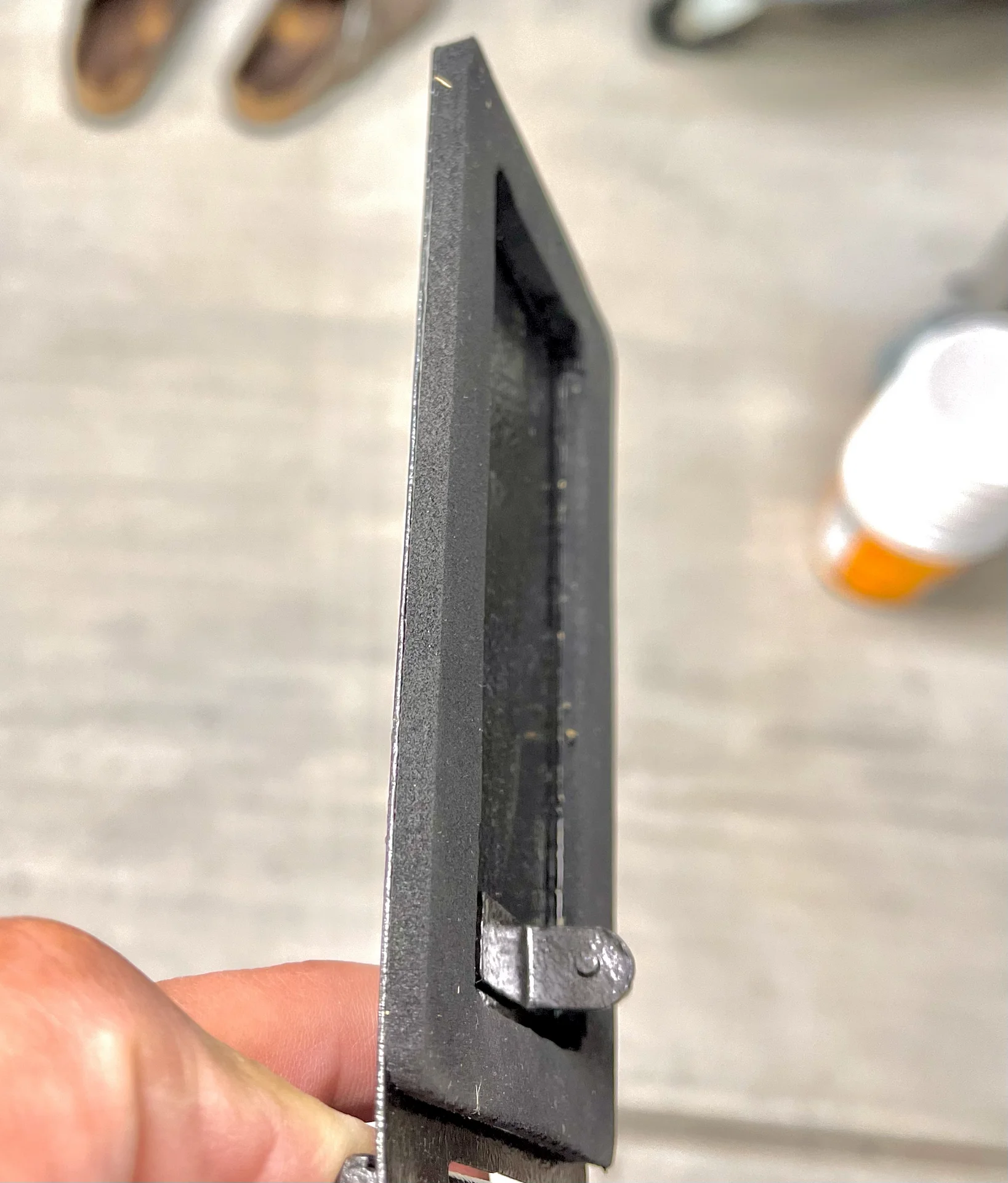

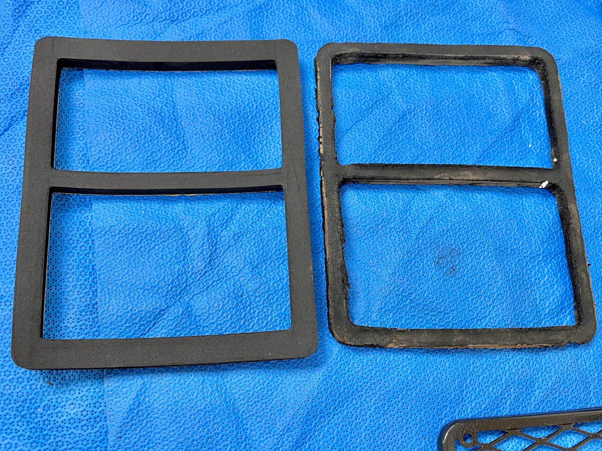

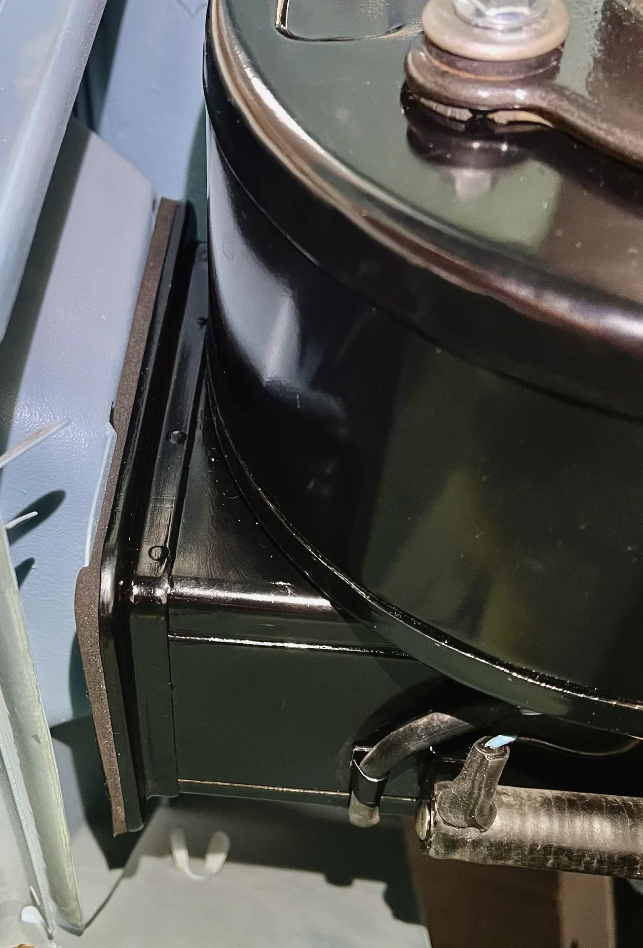

Here is the blower gasket along the firewall. first compared to the original and then on the unit. Everything was self adhesive which made assembly easy.
In some of the pictures the edges look wavy/ uneven but that's just distortion on the camera.
let me know if you have any questions

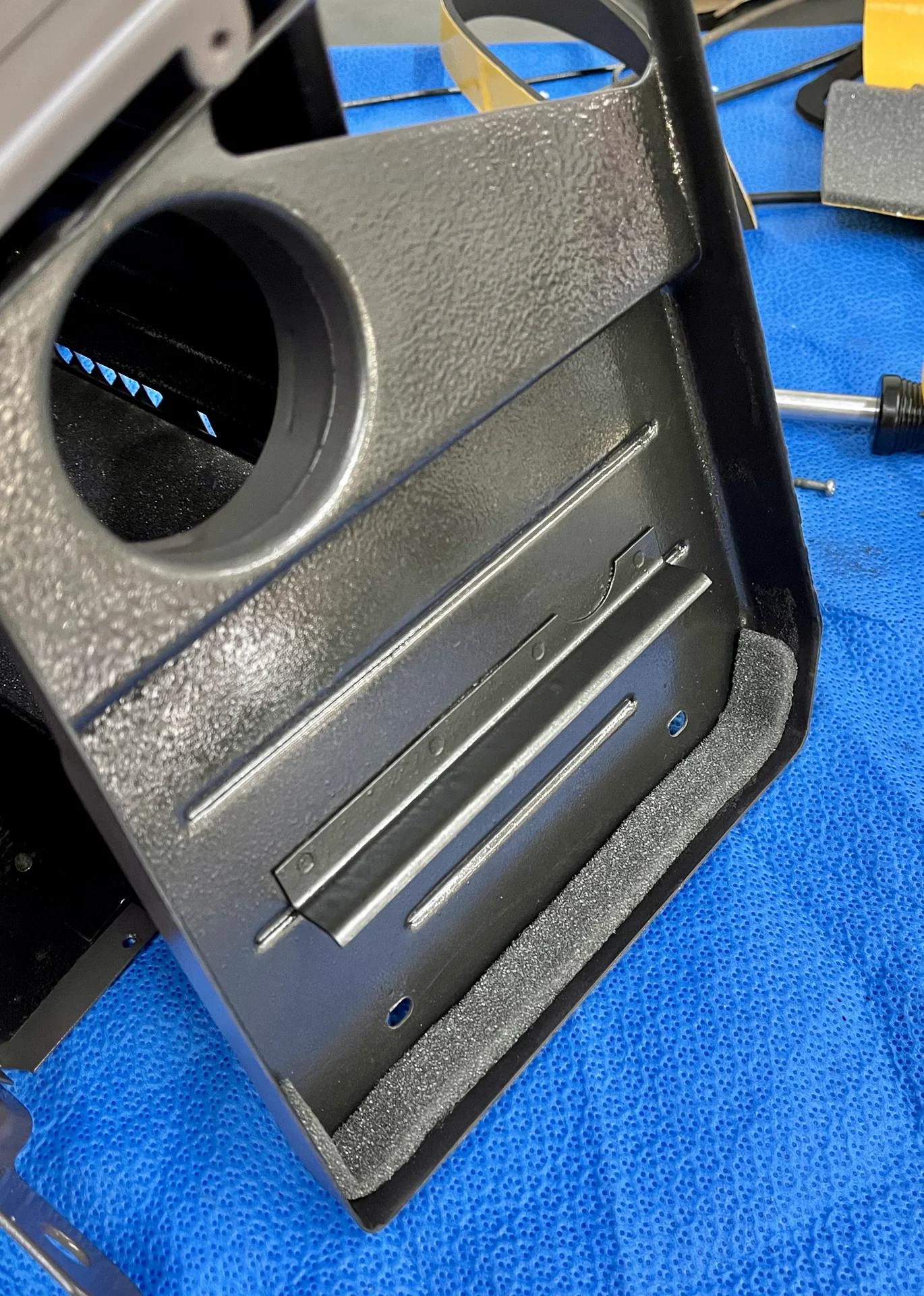

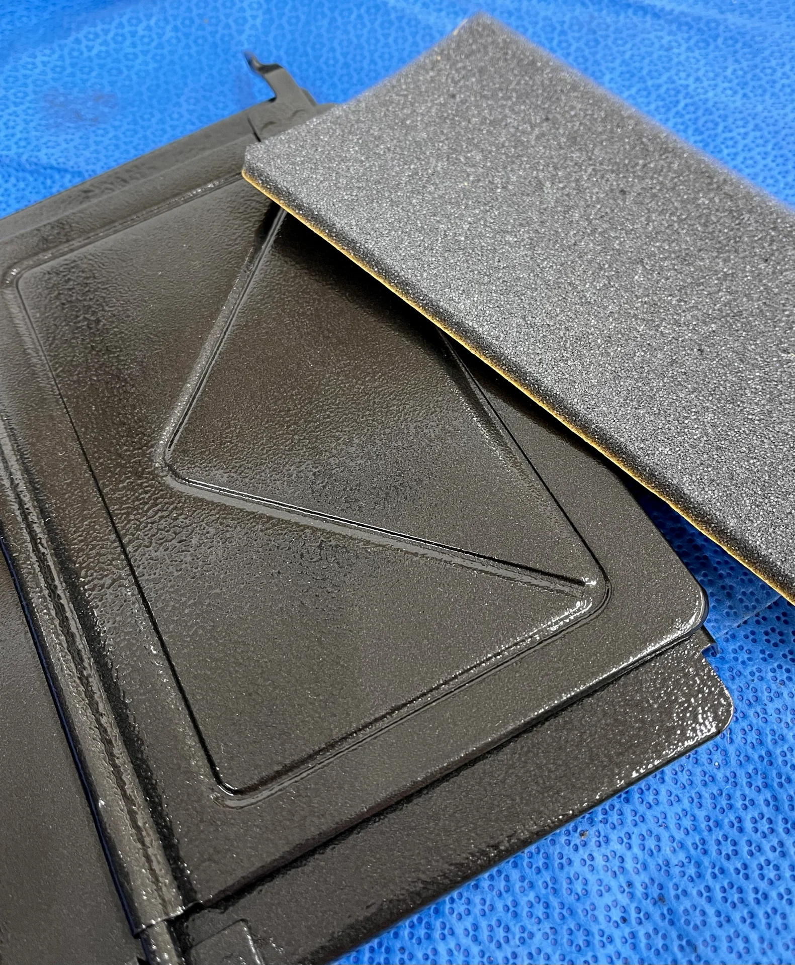

there was a larger piece of foam, in the form of a large square outline... presumably for different year heater box? at any rate, I used a section to duplicate the original top seal

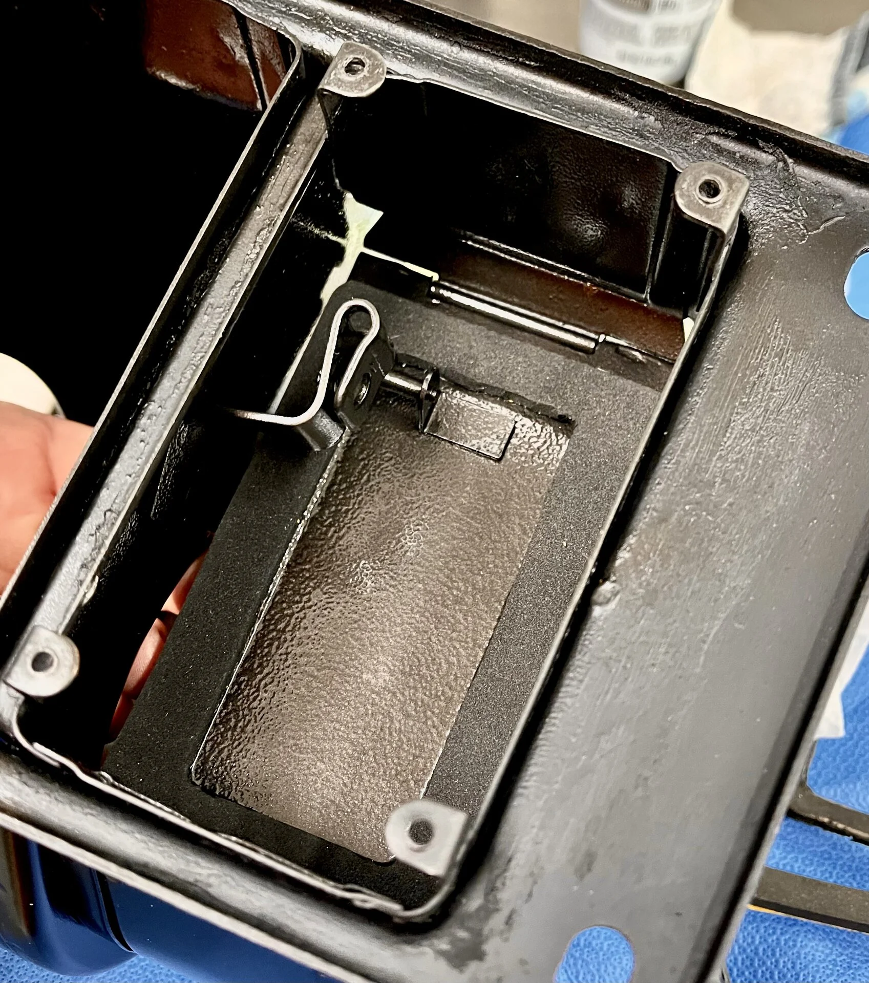

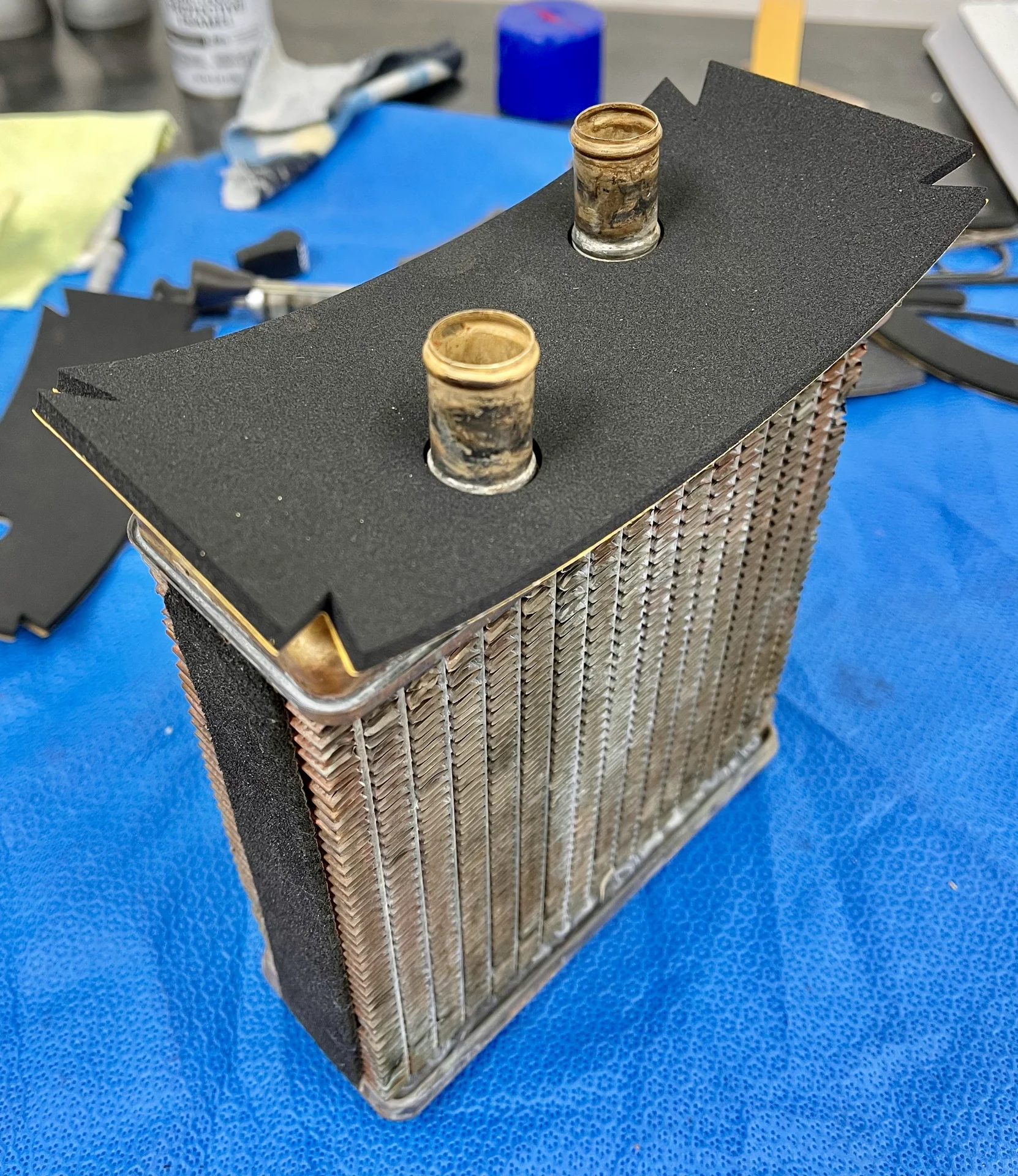

tried to get some shots of the fit once assembled but you can't really see much. the heater core was nice and snug inside and all the doors sealed well.
when I started this project, I tried to find replacement foam but quickly became overwhelmed with the varieties and options. then, when I found something I thought would work the quantities I had to buy were far greater than what I needed.
this set wasn't cheap but I figured after I spent all the time ordering and cutting to match, it was probably worth the money.
Everything in this set felt like good quality material and it all fit perfectly - made for a really easy way to complete the project.... so in the end I'm happy.
Hope this helps someone in the future.

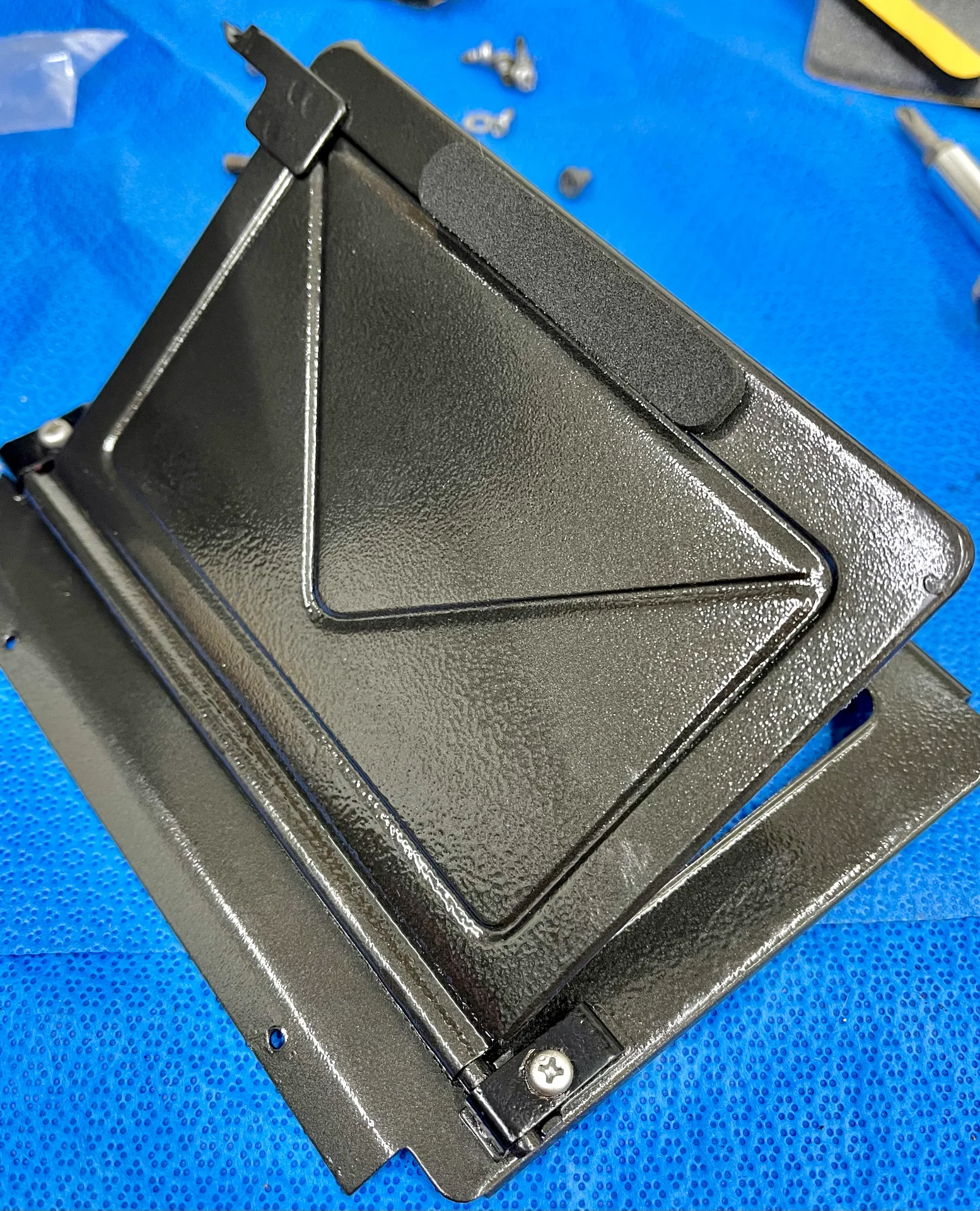

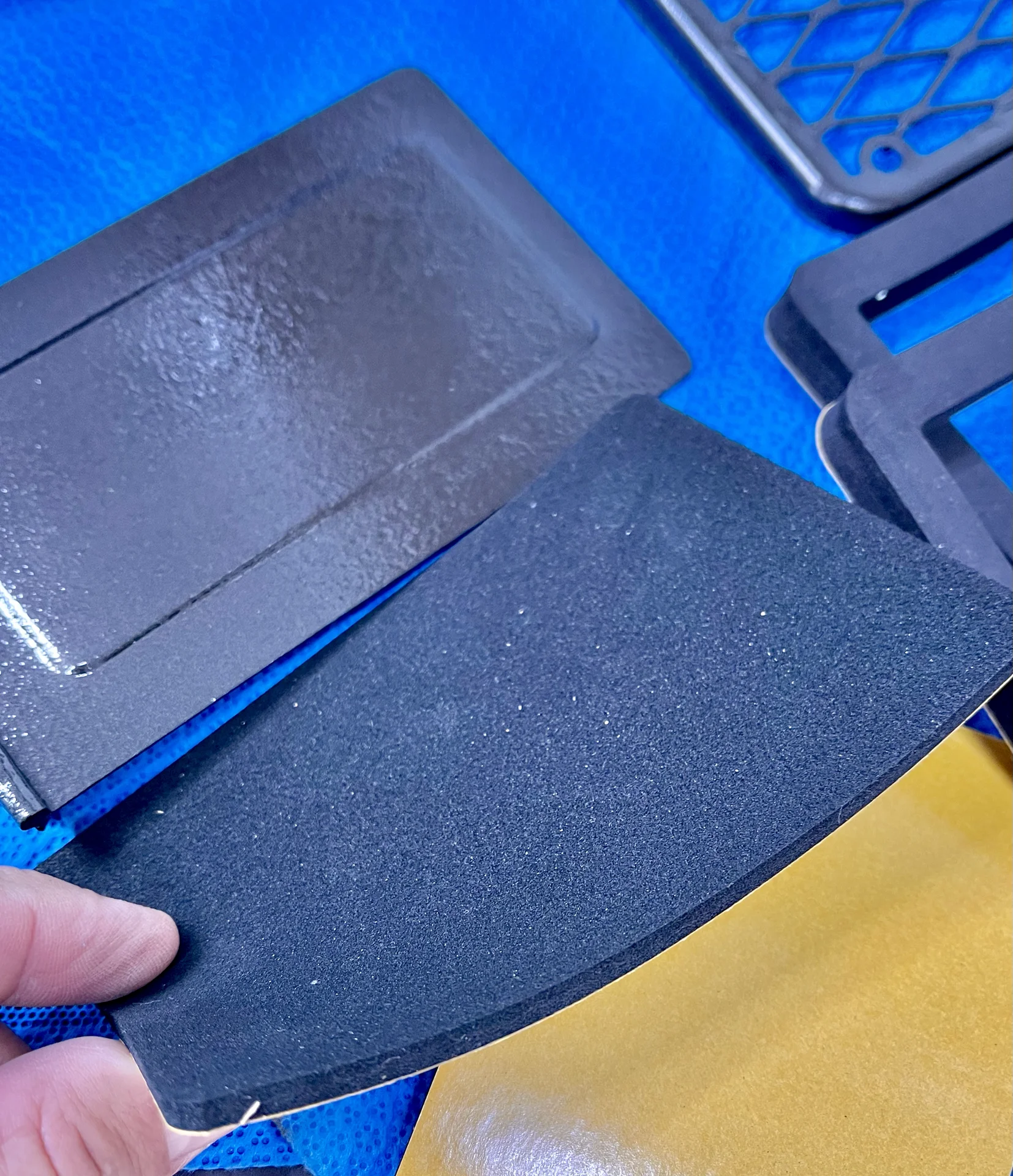

the foam you used for the heater flaps looks different from the stuff you used for the heater core and blower refresh. what kids of foam did you use in the heater itself?
I think I answered your question in the other thread but let me know if you need more info/ pictures

@Fzjrvakma I’m going to have to look at it again in the morning…I’ll get back to you
