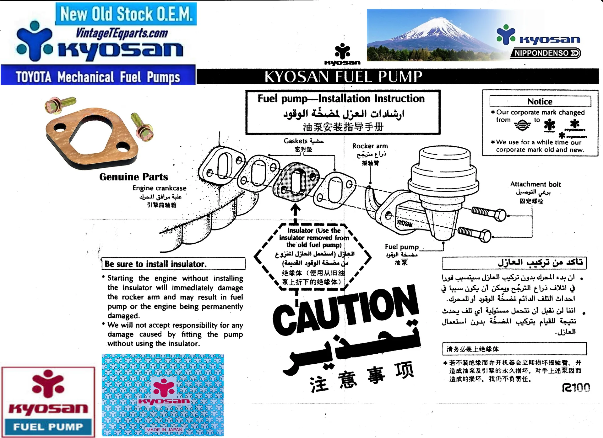

Not the expert but some years have a spacer, in addition to the gasket. Could it be this is not installed? I just rebuild my 76 FJ40 mechanical pump and it works very well now. My year does not have a spacer.

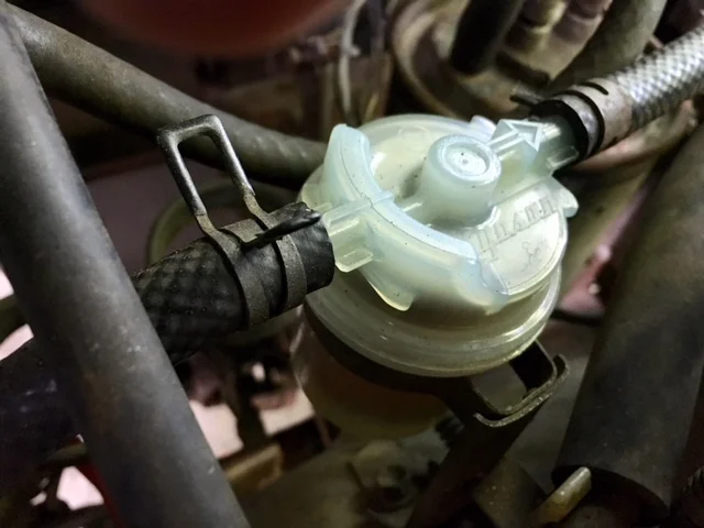

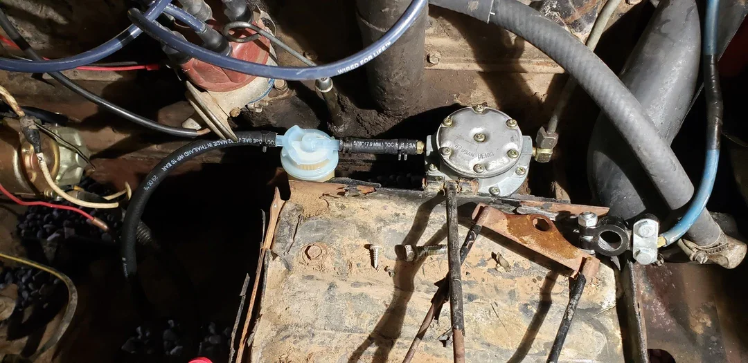

There is a filter before the pump, and in my case, I added a cheap transparent filter after the pump so I can see if the pump is doing its thing.
