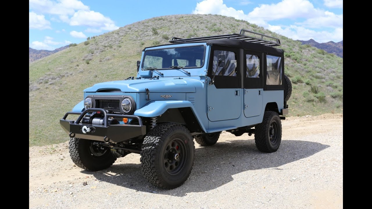

Icon... ($200K no kick vents!!)
...names their 4 door 40 themed truck the "FJ44" (ie: 4 door series 40) which makes sense. But i don't want to call it an FJ44 because it is not an Icon.

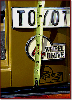

As of now I'm still running a 1FZ and it is all Toyota OEM parts (save Icon, slinky, etc) but all engine and brakes etc. So I'm not bashful about mounting the new old stock OEM rear passenger corner badges which thanks to Ebay are already in hand (not my pic):
coolfj40_2270_120239768
I even got a new pair these, too:
