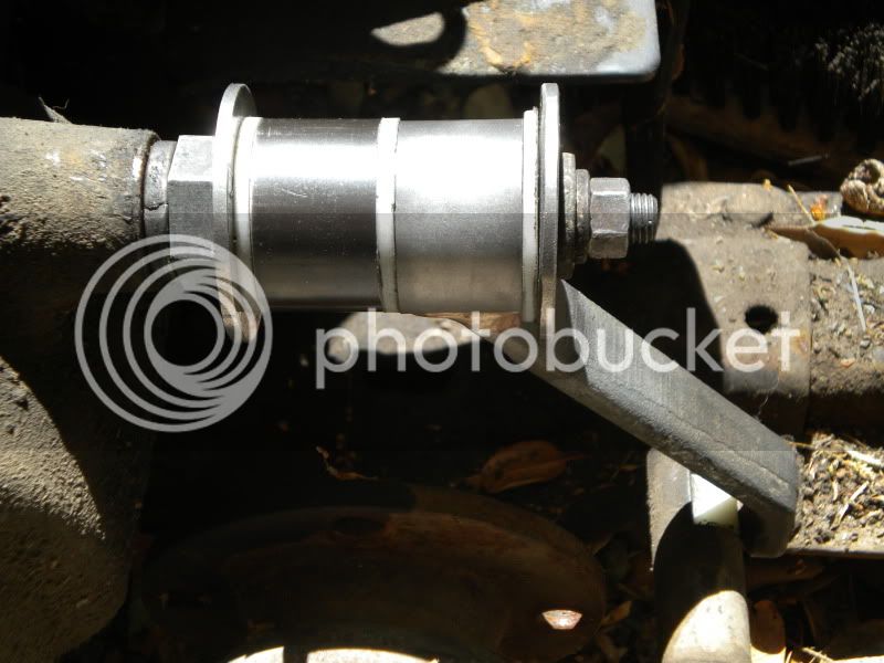

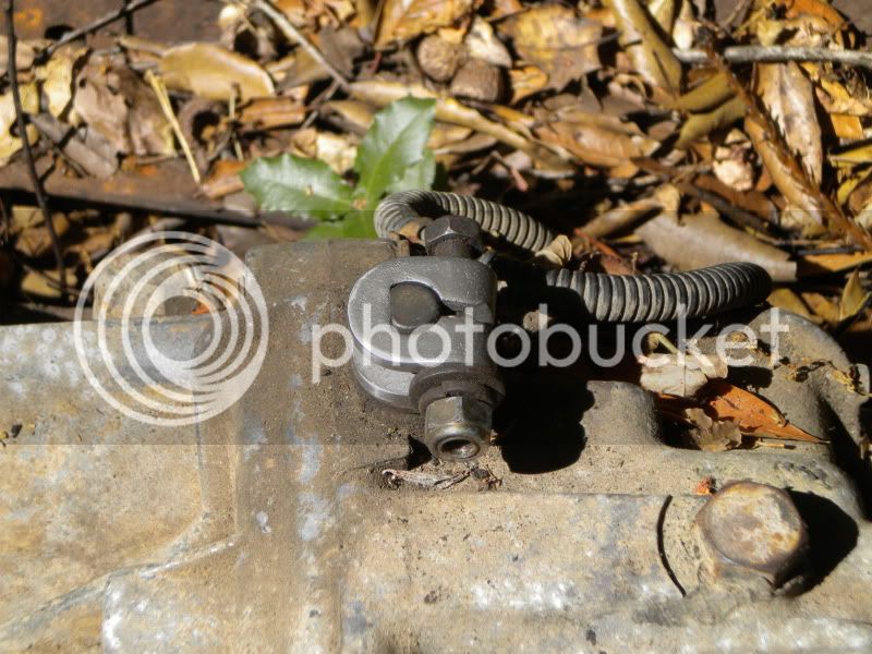

After being absent for awhile, I thought I would post another chapter in the Mutant's history. Although I am currently 4 speeding it, I do have a H55 held in reserve, waiting for the next round of silliness. I will bet that most everybody using all versions of the Toyota transfer case and its linkage will agree, that even when new it probably was marginal in the slop department. Fast forward, with the H55 sitting on the ground it seemed silly to not develop my own version of the twin stick transfer case shifter. AA has one for the one piece transfer and Georg at Valley Hybrids has his version, I thought I would develop my own version, simply for the fabrication exercise.
Here is the start:
The pivot is the stock, and I reverse manufactured the pivoting/rotating components using 1.500" DOM tubing and machined Delrin bushings and washers to isolate the metal from metal to rid the Mutant of the buzzing going down the road. I sliced the stock arm from the original linkage and welded it to the tube using the good old Miller TIG and silicon/bronze welding rod, I would have used nickel rod but it was lost in the giant mess that is my shop....
My push/pull rod comes from these guys, they make smokin' rods and ends:
Out-Pace.com
Will add pics as the project progresses!
eric
The high/low pivot will be added to the OEM clamp when the push/pull rod arrives from the supplier. Here is the 2/4 shifter:

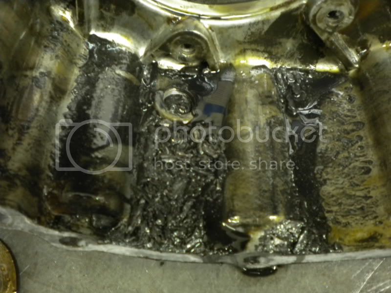

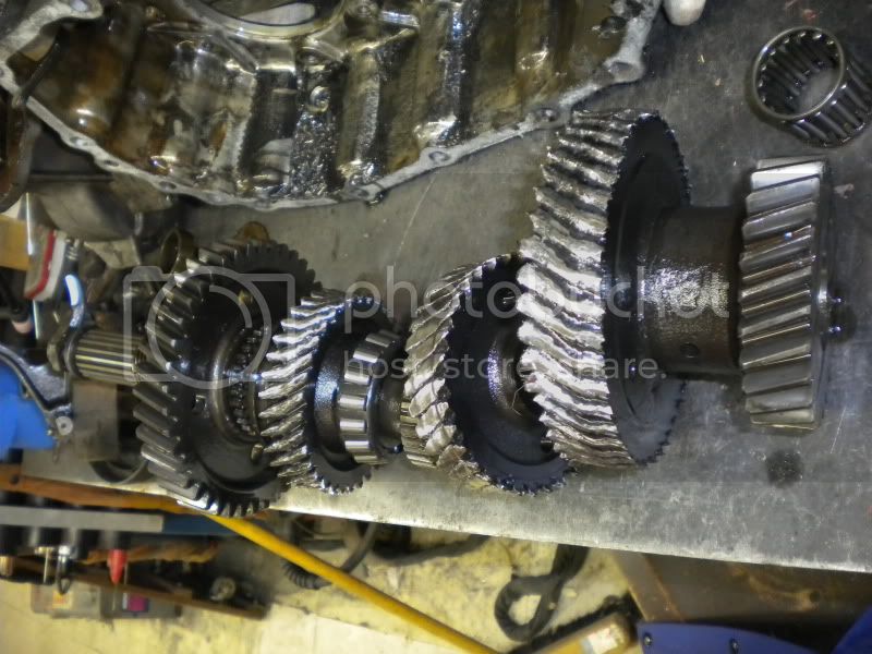

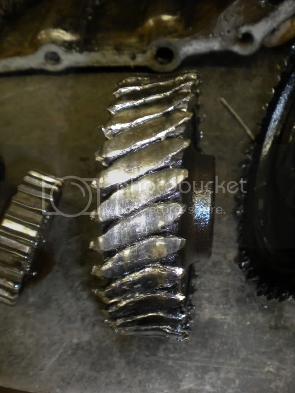

Went to S-N-T '11, was on the drive down US 101, speedo quit and about 60 miles later the transfer started making rock crusher type noises. Stopped and had a local shop pump it full of 140 WT, Made it to SNT and finished the transfer off on the sand. Pics tell the story:
Some might have seen the Mutant parked near the sign post DOA, had to be dragged to that point. My buddy went home and got his Dodge and a flat bed to drag it home. Oh well at least I made a showing. I have 2 spare splicases in reserve so now its just an exercise in swappage, knucklehead manuvers never quit. I guess the 5 speed swap is happening sooner than I thought....
wow what do you think happened? :eek: those gears are thrashed!!!!!
