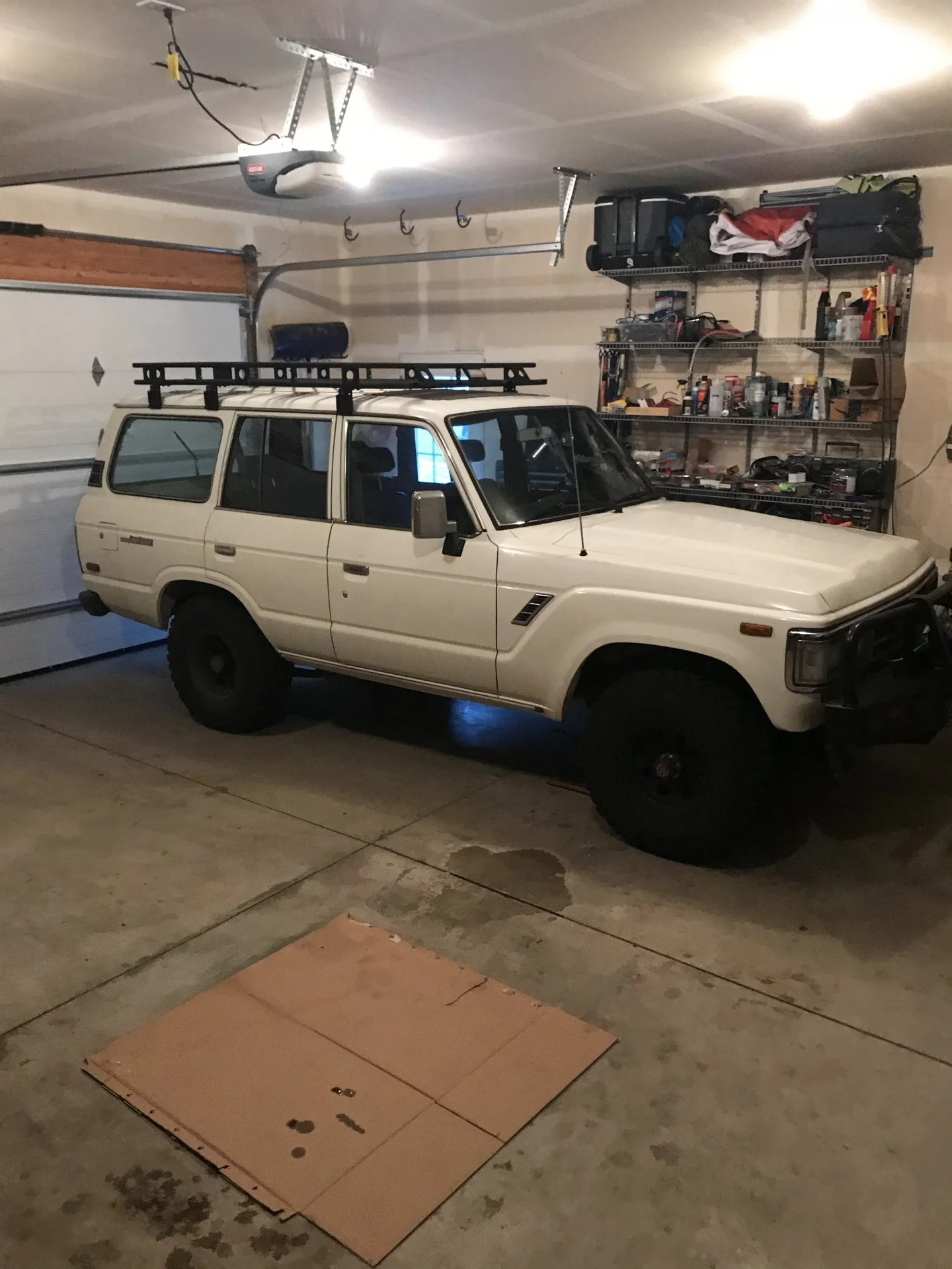

That sounds very reasonable. Given the fact that I can still squeeze another 50-70k possibly more out of existing 3FE. I didn’t realize there was a coil over kit. Thank you!! That sounds like my best route. Thanks everyone for the input!! Attached the only pic I have on phone currently. Will post more when I get a chance
Nice 62. I really like them in white for some reason.
So who's leaking oil...the Ford or Yota?
It’s a Yota leakewge. But it’s the wife’s “new” Corolla. funny how the new ones last a fraction of these classics. Another project for another day. The Ford is another project on its own. You know the saying. If you own an old Ford, you better own enough tools to keep it running.

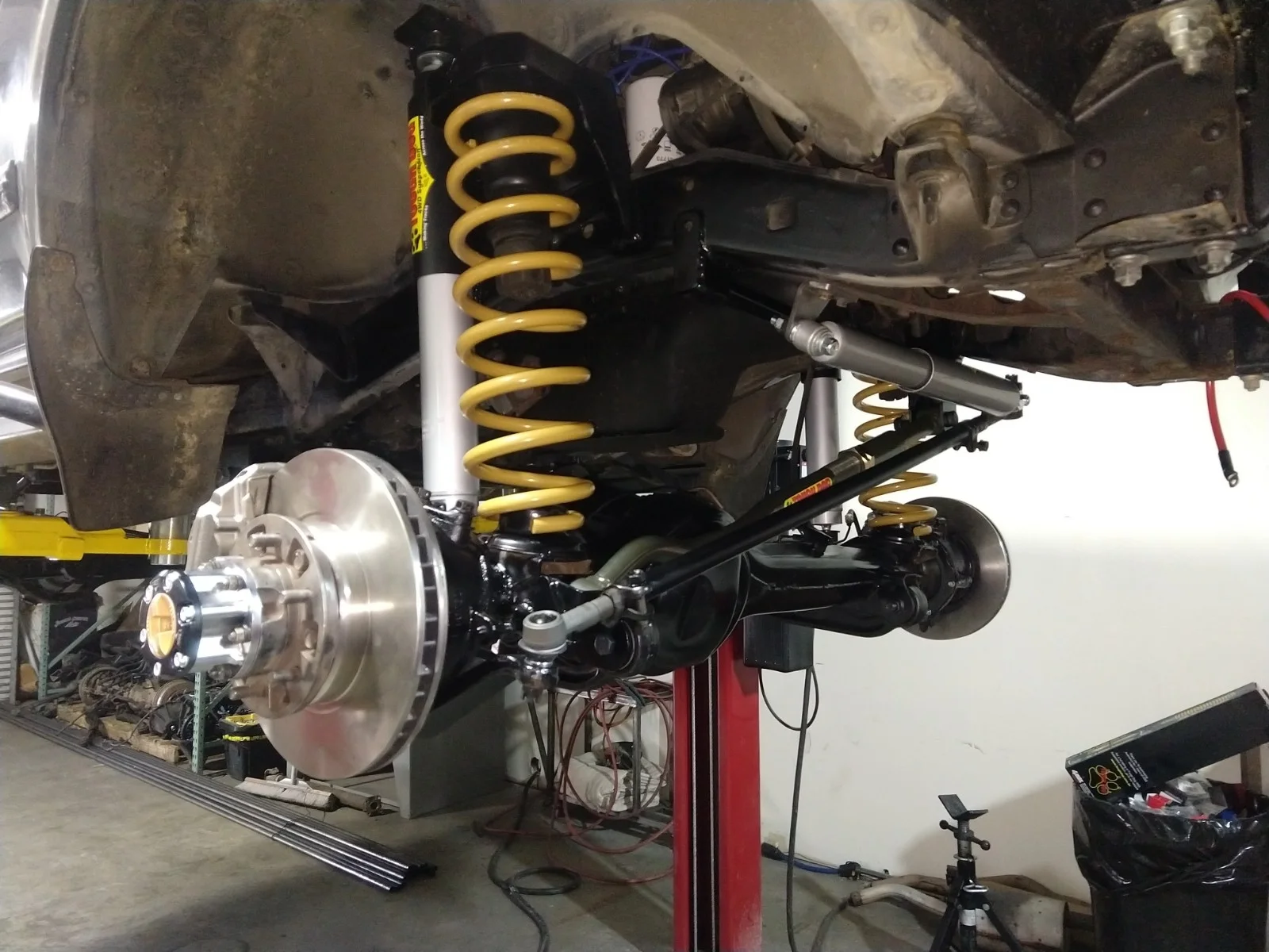

I believe @TRAIL TAILOR has kits to convert your 60 chassis and axles to coil as well...but I cannot remember if the development of that project is done yet.

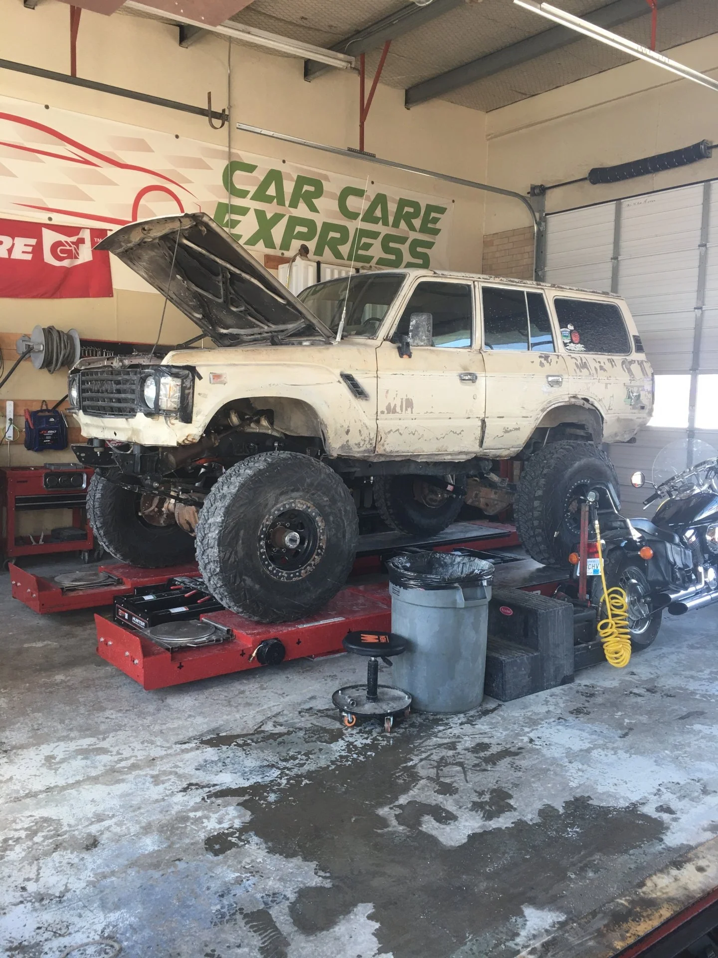

Thanks guys. Coil conversion for the 60 with 80 axles.
Is your current chassis in good condition?
