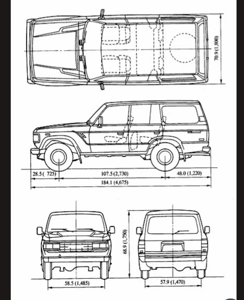

We all see the fj60 over fjz80s

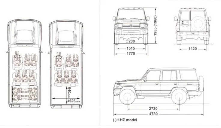

How about fj60 over modern lc76
The are the same wheelbase
Is it possible no need for cut and welding the chassis
You'd have to move the body mounts on the frame at the very least but anything is possible with enough time and $$
Axles are generally narrower in the rear than the front. 5cm isn't a lot.. You might even be able to use the 60 series rear axle.
