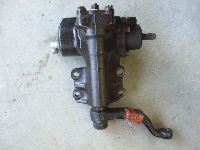

Steering box made it.
Thanks Again!
attachment.php
:hhmm: What's up with that Pitman Arm? Do you have some new kind of reverse steering system up your sleeve? ;)
Good Eye
I'm working with Mace and 4x4 labs on a top secret setup that uses an Heim joint on the rear of the steering arm. It will eliminate the Drag link. :o
attachment.php
Good Eye
I'm working with Mace and 4x4 labs on a top secret rear steering setup that uses an Heim joint on the rear of the steering arm. It will eliminate the Drag link. The articulation is what is killing the design.
attachment.php
Yeah, that Mace guy is always so innovative. :idea: :D
It packaged easier that way (big F'n box tho) and the nut was only finger tight ;)
